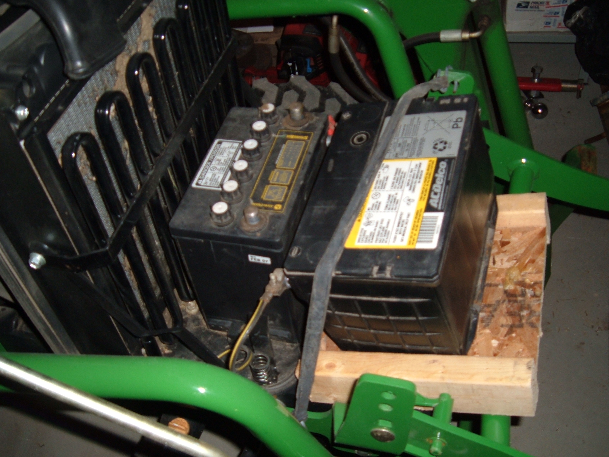

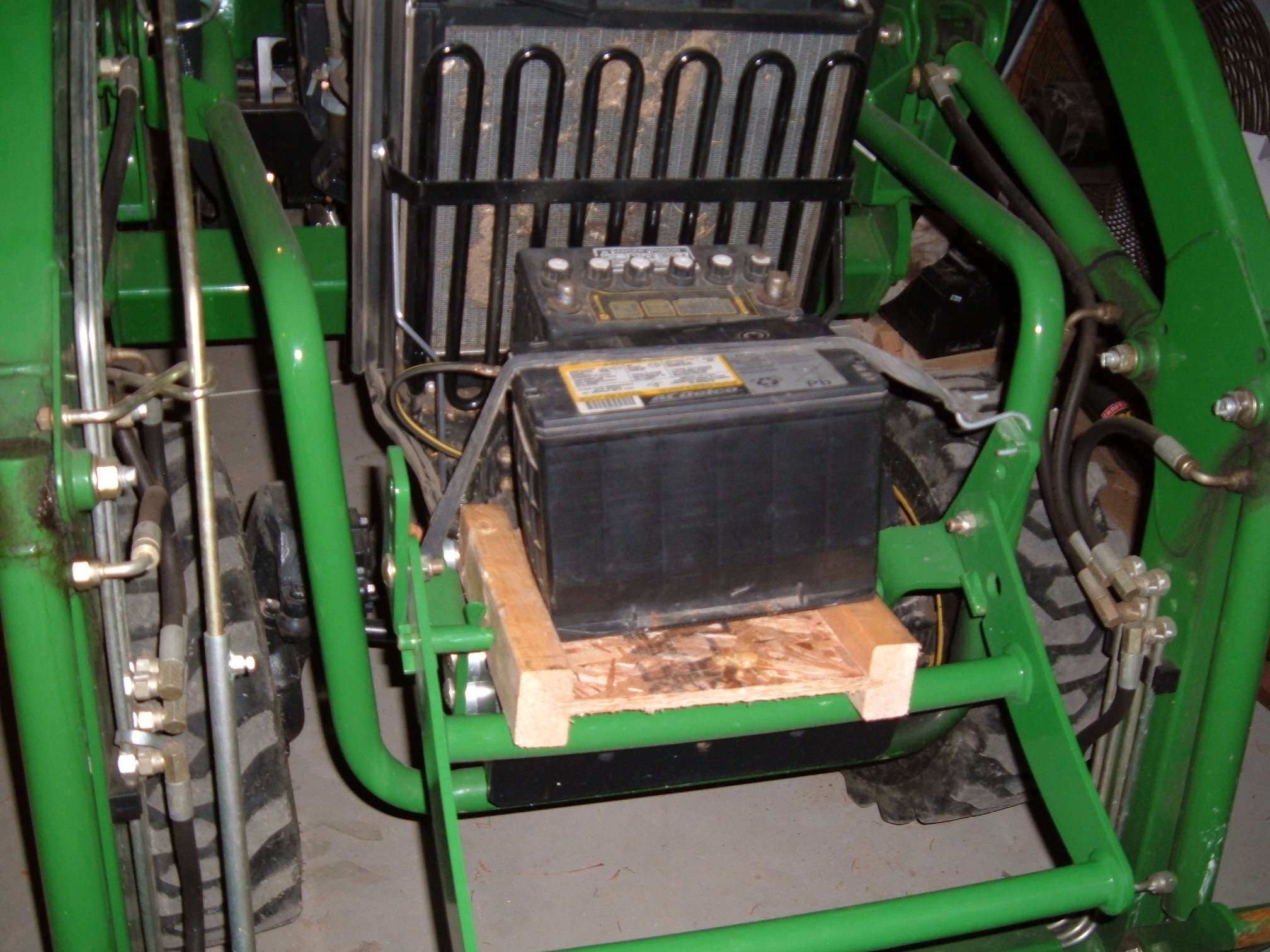

I just fell victim to the John Deere battery curse tonight. My 2320 was 1/8th of a mile from home. Tried using a jumper pack, jumper cables and neither one would get enough power to it. Ended up taking a battery out of a car and putting on it just to get it home. I did what I had to, just to get it back home. I plan on getting an Interstate battery for it. I have decent luck with them.
J Frock
