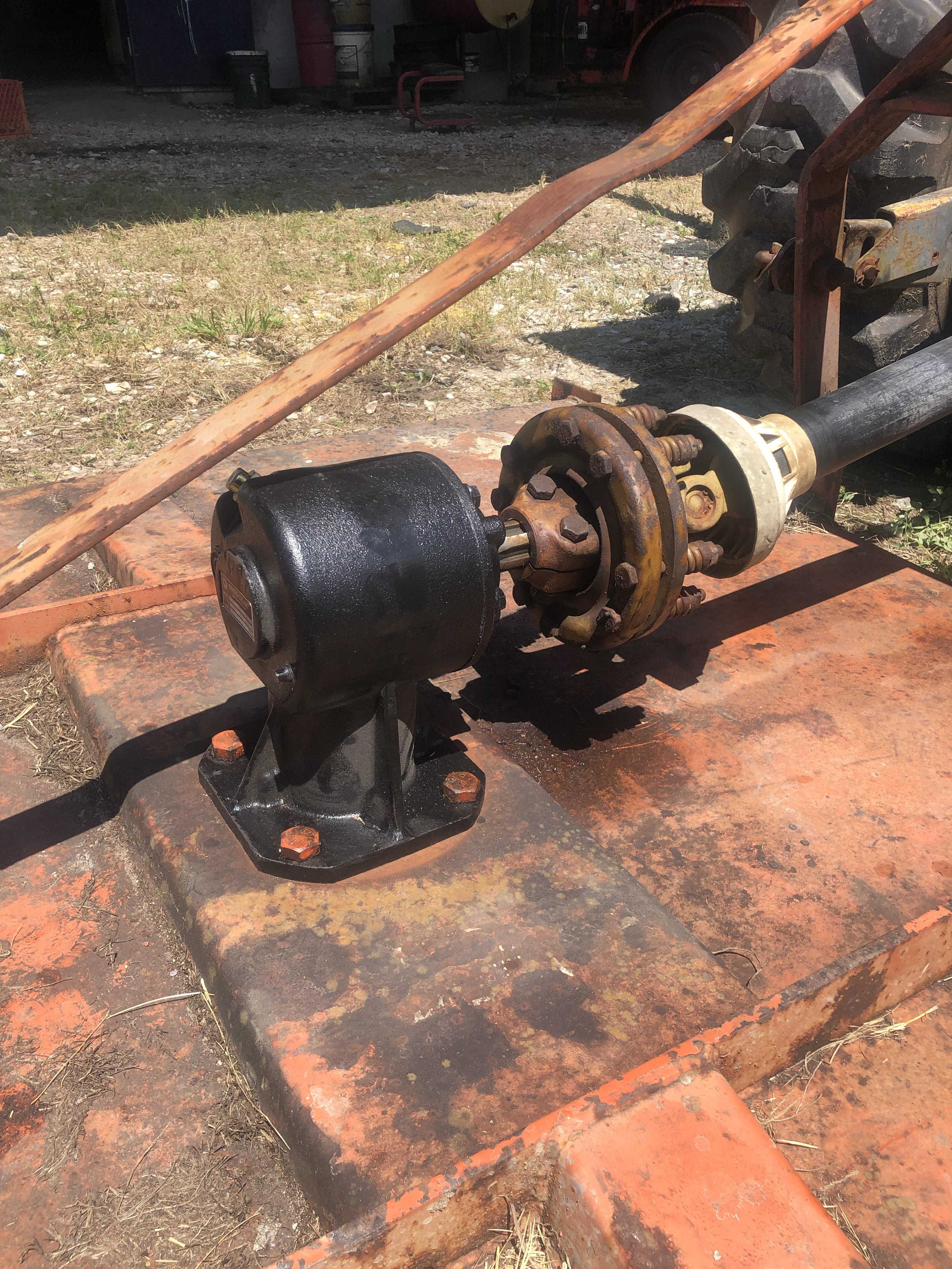

That looks a lot like a Omni RC-30 but that’s just a guess at this point. Look real close on the gear box there should be either a I’d tag or numbers embossed in the housing that will help I.d. The gear box. If you can’t find any then as stated above remove the box and measurements and shaft types. Once you figure out what gear box will work , then you can search for the best place to get it at the best price.
   / Need a new gear box for rotary cutter #12
I'm sure the gearbox is an off the shelf item manufactured by another company for many other cutters. it's too cost prohibitive for one company to make everything themselves, or have custom parts made.. the deck is probably the only custom made part, either by them, or another company..
   / Need a new gear box for rotary cutter #13
Check Surplus Center. They sell gear boxes and the Omne brand comes to mind.
My Landpride finish mower blowed seals a few years ago and I found out after fixing it that I could have replaced the gear box for cheaper than the replacement parts.
   / Need a new gear box for rotary cutter #14
The other consideration is ratio. Different ratios are used for 5', 6' and 7' cutters to keep the blade tip speed about the same.
On my 6' the 540rpm input is increased to 792rpm output.
   / Need a new gear box for rotary cutter #16
   / Need a new gear box for rotary cutter #17
I can't believe the low price.
   / Need a new gear box for rotary cutter #18
Is it broken? Why not just dissassemble and rebuild? Probablly just 2 seals and 4 bearings.
#19
Is it broken? Why not just disassemble and rebuild? Probably just 2 seals and 4 bearings.
This is spot on. I ordered the new entire assembly because I figured the gears were all chewed up inside, but after removing it and taking it apart I found out it was just the bearings around the lower vertical shaft that were the problem. Anyway, I'll probably fix that one up when I get some free time and keep it as a spare or sell it.
For anyone interested, this is the one I went with: Omni Gear RC-3 25179
It fit perfectly. Thanks for all the help gentlemen. Back in action
