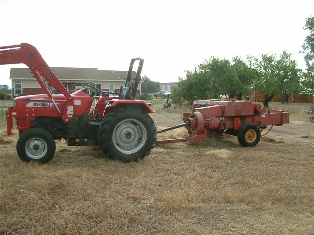

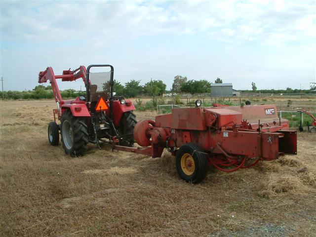

I do the same with my 1964 MF-135 diesel. It needs clutch and tranny servicing soon. Not looking forward to splitting that little beast.

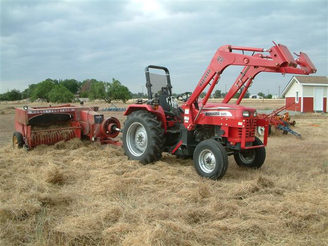

My haying tractor is a 2008 Mahindra 5525 (54 hp engine, 45 hp pto, 2WD, gear tranny, power steering) with the ML250 FEL (6-ft wide bucket, 2950 lb lift). I pull a MF124 baler (small squares) with no problem. (I plant oat hay on 6 of my 10 acres).

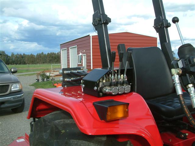

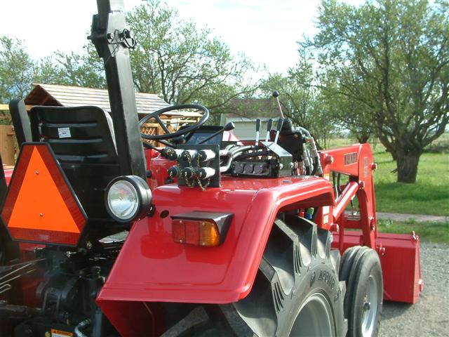

I have a skid steer quick attach system on the FEL (highly recommended) and triple hydraulic remotes (also highly recommended)
