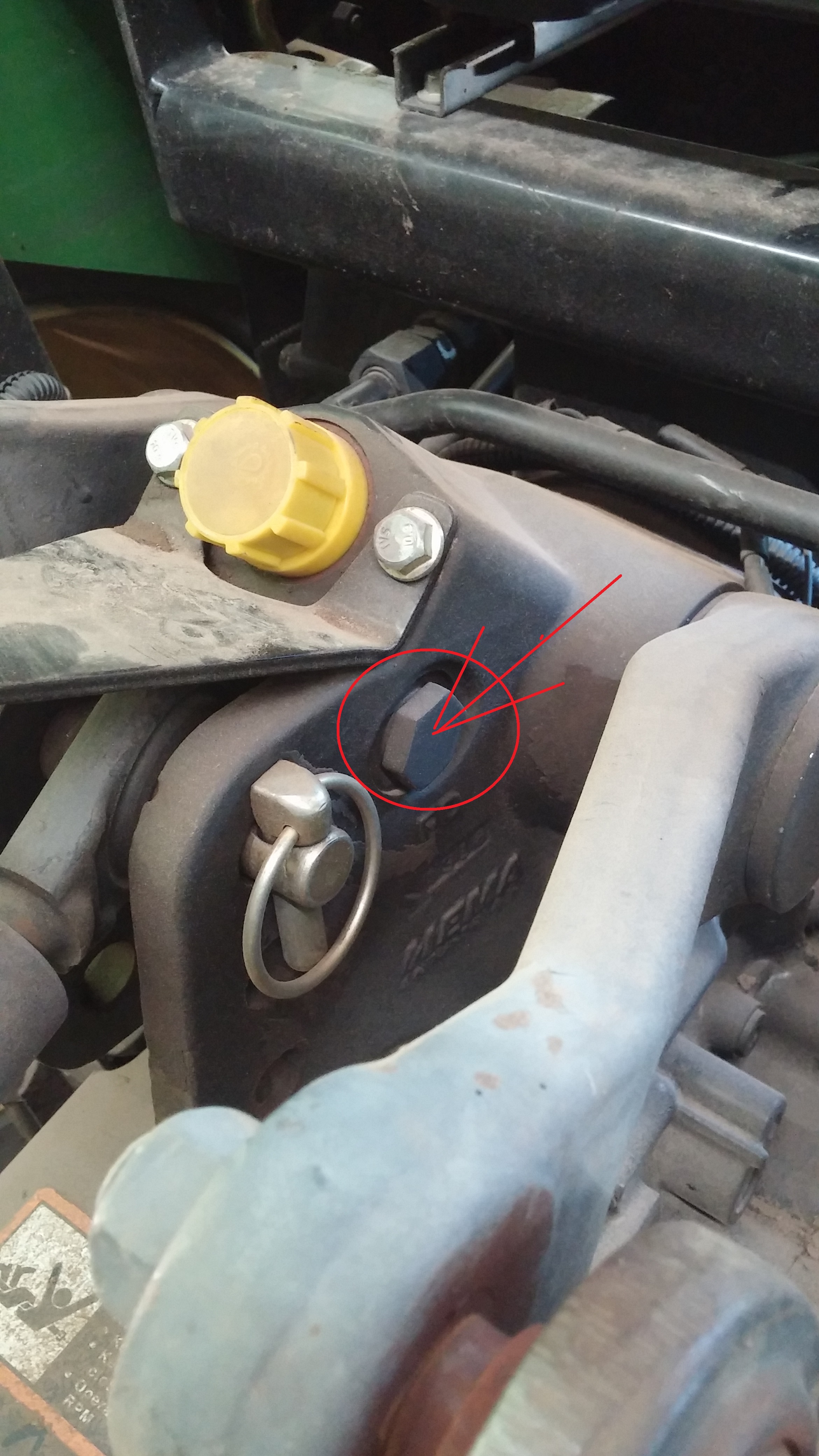

Need a pic of where the PB hydraulic return line is off of 3120 or 3320

PS as far as the wrench goes, I found a 1 3/16 works good. It is a half mm off from 30mm which is probably the real wrench to use, but I do not have one (yet!)...
Also, because this hole is right up tight with the lift arm you have to use a tight elbow to route the line upwards. The 3320 uses part 38H5017, which I am confident will work with my 3203 and I have it on order....
