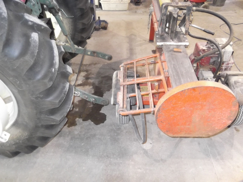

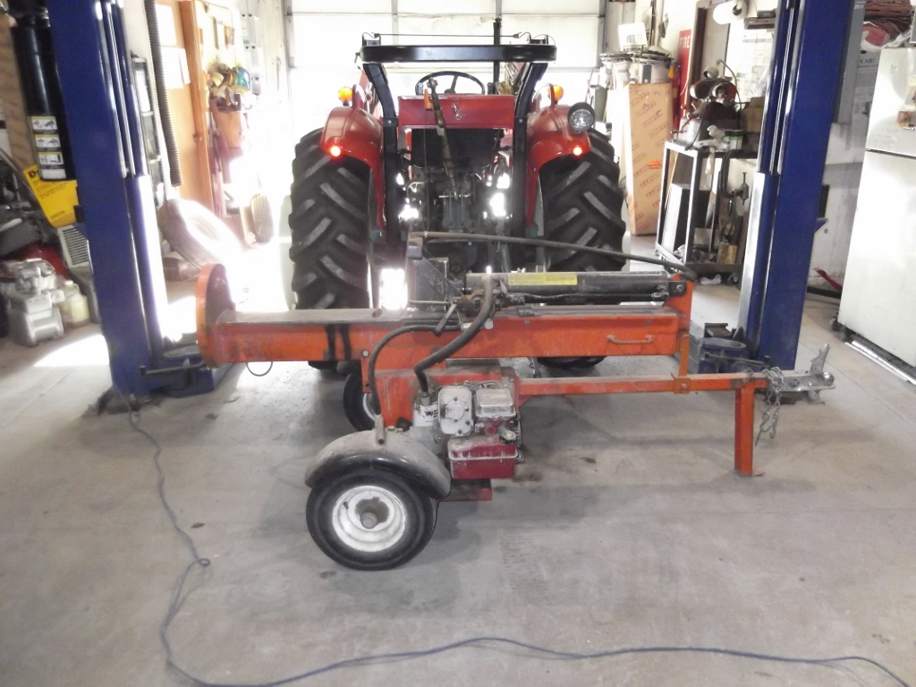

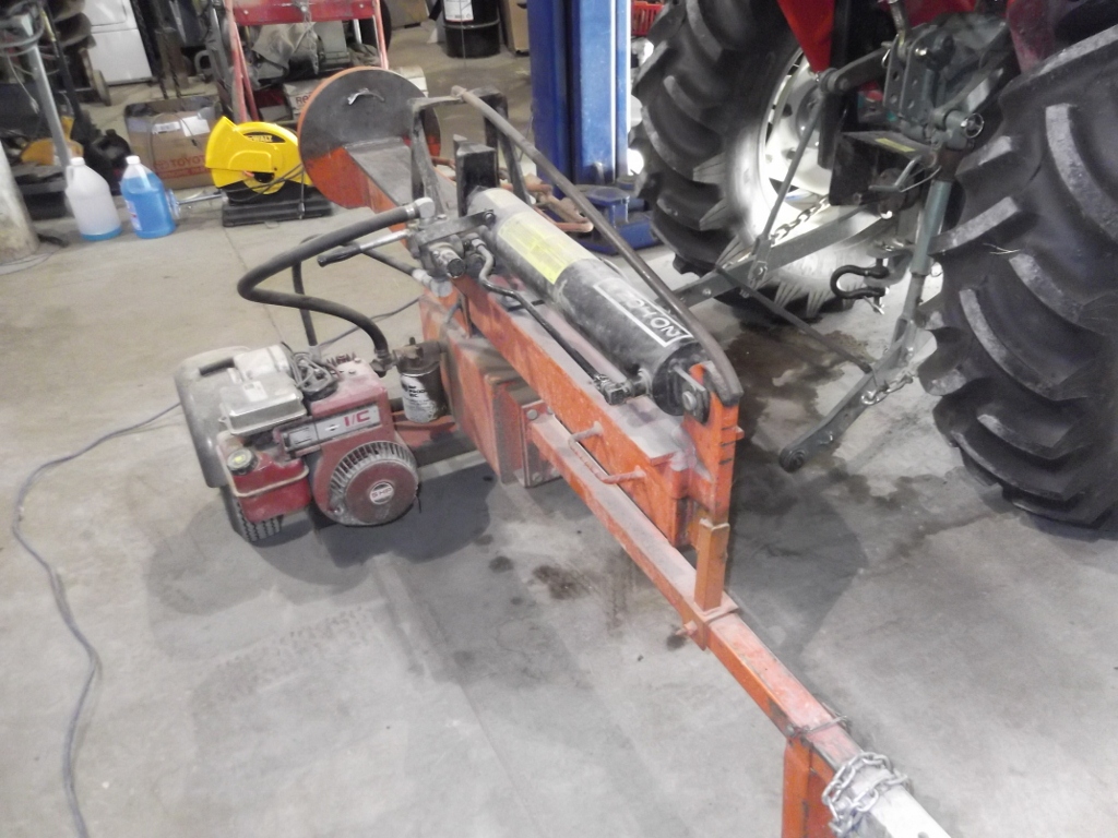

Agreed and its hard to answer those questions Leon other than what I have already said? I dont have remotes now like I mentioned and I did ponder the just attach it with add on 3pt mount and decided against that. Actually the axle wont come apart and if I could have taken that off it would have been a different situation as far attaching the splitter as is, the rack I can cut off no biggy it is gone in the new design anyway. I suppose I could do something with a different tank and re-mount the engine and still use it as it just cut the rack off and leave the existing tank/axle off lots of things to think of...I still think my original idea is the simplest though so far as long as my pump mount is a success it will be the easiest for sure.
That and I still need to figure out whether my BH or other ccw HP pump will work before I buy a cw rotation splitter pump and rig it backwards which I have a good idea how to do that and is probably the best way overall but still need input on single stage pumps working in this application to decide.
I will post a pic or 2 of what it looks like now so the visual is clearer. You can see I was thinking along those lines as I set this up to take pics.
The splitter beam and cyl w/valve is only held on with 1 pin 1 bolt and 2 lines extremely simple to take apart. And its deceiving by looking at the pics but the splitter beam is just about exactly as wide as the widest part of my wheel weights so its not actually sticking out as far as it looks.
fwtw I want it sideways rather than front to back mainly because I need to motivate in some small areas moving trees out etc.
