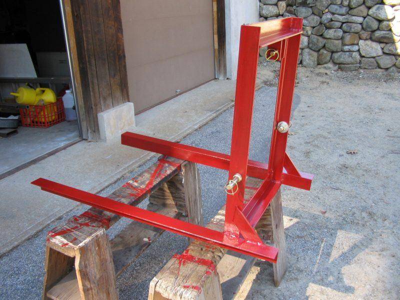

Here is a pic of one I just made for another TBN'er. You can add a box or a wooden platform to the legs. Handy attachment for moving heavy things.

A carry-all is not a box. It mounts on the 3ph and looks like the forks on a fork-lift. You can sometimes get them at N.H. Northern on sale for as little as $59, but those are the light duty models. Here is a light duty model by Howse from Northern. This one is a medium duty by King Kutter, also from Northern. Leinbach makes one that's more heavy duty and holds more weight. It has the little triangular brace on the back corners like the one MadReferee showed. I bolted tiny casters to the underside of mine so that it rolls under the front of the rough cutter (which sits on its own low dolly) and takes up less space. I recently loaded mine up on the BX with 3 sections of cabinets all 6' long (standing on end and back to back), strapped it with wratchet straps, and hauled the several hundred lbs. of cabinets through the woods out to the rear storage building. You can use it for so many purposes!!

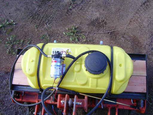

So I guess I built a carry all for my box blade. Here is a pic of it in an unfinished state.

that's a good idea! I might just think about going with your setup. I think I could carry the tank in my FEL with no problem.

Here is an up close and personal pic of a carry all I just built for another TBN'er. It is very similar to one you can buy commercially. Your Imatch should be able to connect with little or no modifications.

Got It! I see now how it would connect using the Imatch. either putting the tank on the carryall, on the back, or (as another person suggested), putting the tank in the FEL would work just fine for me. in fact, it would work far better than pulling a sprayer behind the tractor......and, ultimately, might be cheaper.
thanks very much! I will check this out and make a choice over the weekend.
