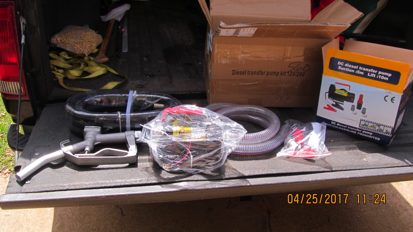

I have one of the $65 pumps with nozzle. Works great. They don't come with an auto shutoff nozzle at that price point but I've recently seen some auto nozzles fir $20 ish.
I will follow up with links next time I get on my computer.

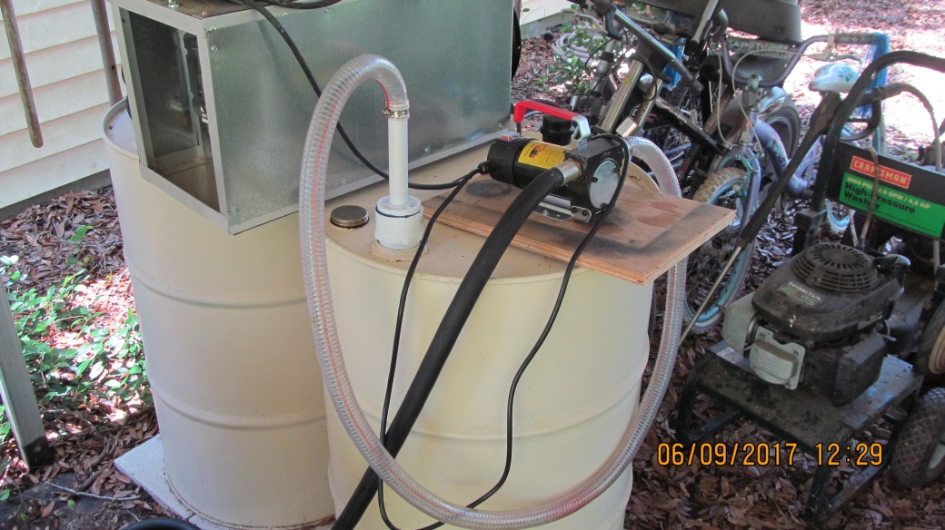

I also have a Ford New Holland 575E, 28 gallon capacity, and a MEP-803A Diesel Generator. The generator only holds 9 gallons but I keep two 55 gallon drums of reserve fuel in case of a long outage. I go through about 300 gallons per year for various uses and I have it delivered so no toting 5 gallon cans for anything.
This unit for $65 is similar to the one I have. The nozzel that comes with them is not the automatic shutoff type like you see at a gas station so you just have to be mindful not to overfill the tank.
I also made a pickup tube for the 55 gallon drum out of PVC. I needed a little more reach on the hose and the limber pickup hose it came with was a pain so I made a pickup tube for my drums. A 2" pipe thread will screw right in the metal drum hole so I used a 2" NPT thread to slip fit coupling and reduced it with a 2" to 3/4" slip fit reducer. I used a round file to remove the lip in the 3/4" part and to take the taper out so a piece of 3/4" PVC pipe would slide through that part. The outside diameter on 3/4" PVC pipe is a little over 1" so the diesel hose will fit over it. I cut a short piece off the hose to fit the inlet fitting that came with the pump kit to the bottom and set the depth to be a couple of inches off the bottom of the drum. This will work great for topping up my tractor tanks as I use the fuel off. Having the pickup off the bottom will protect from picking up water if I get any condensation. I will periodically check for water by pumping directly off the bottom with a fuel pump I have setup with a metal tube on it. I vented the drums with a filtered air compressor muffler screwed into the 3/4" vent hole in them. Some will argue this will cause condensation to form but I have seen drums distort from expansion and contraction due to weather changes. I prefer to keep the drums vented and I will monitor for water in the fuel.
You can add an auto shutoff nozzle for $21.
