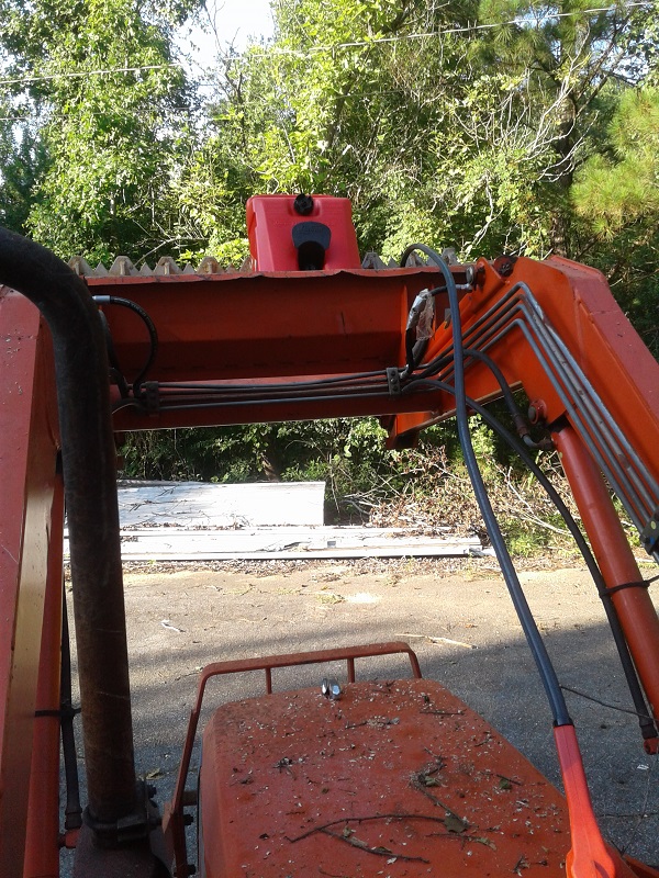

Just a general note -
It seems that for our small tractors fuel usage is relatively minor. I'll burn about 60 to 70 gallons driving my F350 and trailer between DC and Northeast Mississippi in a 1 day trip and my tank holds 38 gallons. I'll burn maybe 5 gallons of diesel in a weekend with my M4700 tractor and my tank holds 17 gallons. My B7610 a LOT less.
So in a long day with my truck I need to fill a couple times, my tractors often go months between refills.
For decades for filling my equipment I had been using a siphon hose and a 5 gallon jerry can. Sometimes I pour with a spout. However I've noticed that over the last 10 years my ability to lift a full 5 gallon can onto the top of my tractor has become less. And this seems to be a major complaint against gravity filling by many people.
Getting the container high enough to pour/drain.
To get around that I purchased a 14 gallon Duromax Fuel caddy (wheeled), with hose and handle.
I can put the caddie in the FEL and lift it to drain fuel. (It is a good lift (~120lbs) to put it in the back of my truck, but I drag it up a ramp of 2 2x6's.)
