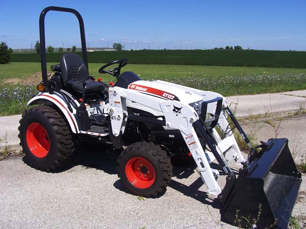

I am looking for a recommendation for good Rototiller to mount on my Bobcat CUT a CT122. I am new to this whole tractor thing so any ideas will be appreciated. Its a 46 inch wide tractor with 22hp, gardening 1/2 -1 acre of ground, no rocks. Will have a bigger garden someday soon. I know Howard's are suppose to be pretty good, but short of that I am,, well, clueless on what a good brand is. Chain or gear driven, reverse rotation green or orange, off-set. Its all so confusing.

Nice looking tractor!
How wide are your rear tires set, outside sidewall to outside sidewall?
It sounds like a 48" might be a good fit.
