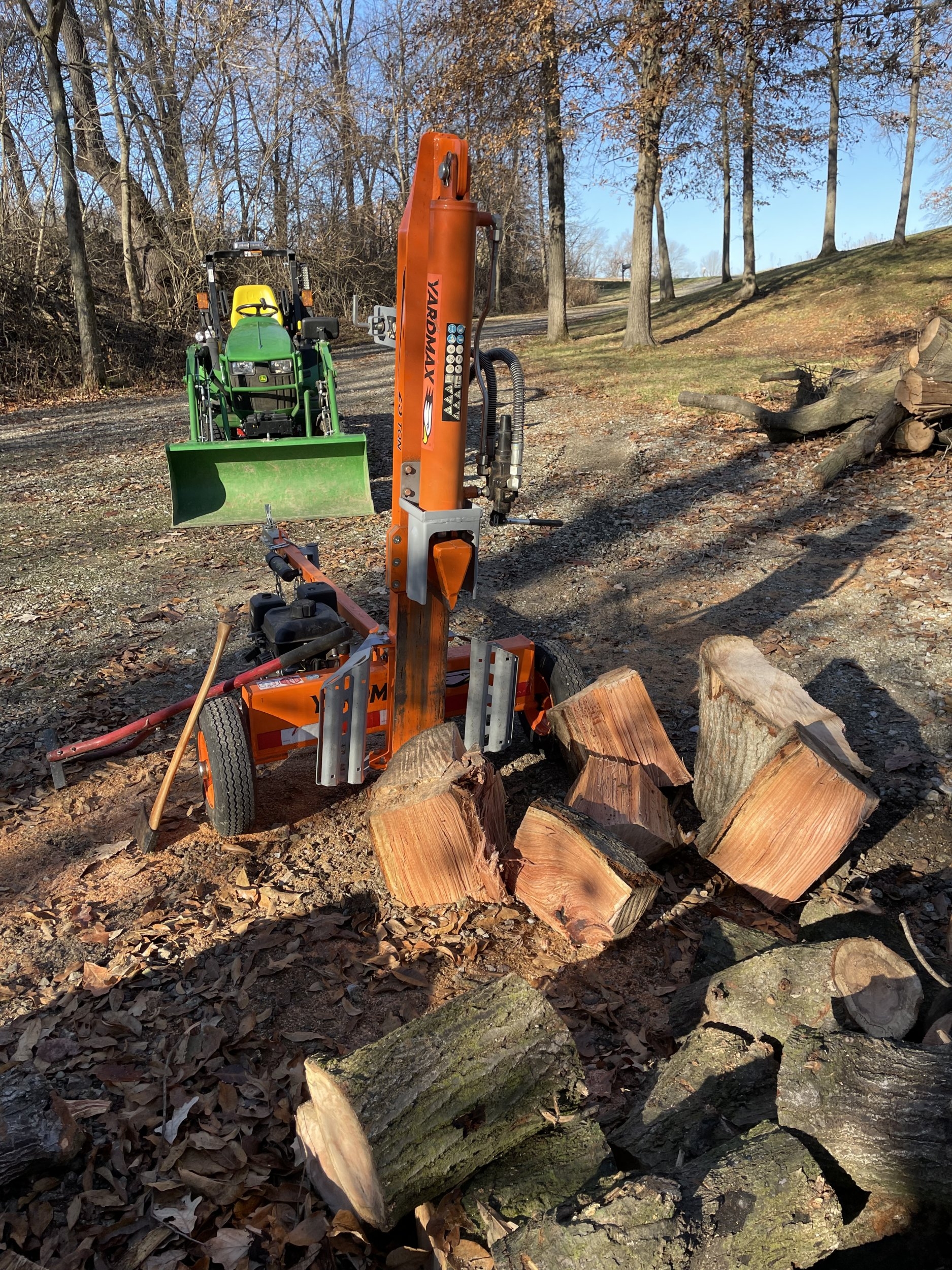

I have a 25 ton Yardmax and I like it. I bought it used a couple of years ago for about $800 which I think was a deal. I have a 4 way wedge for mine but don’t like it. If you have the perfect size logs it might be ok but it just didn’t work for me. I’m not sure one brand is that much better unless you spend big dollars.

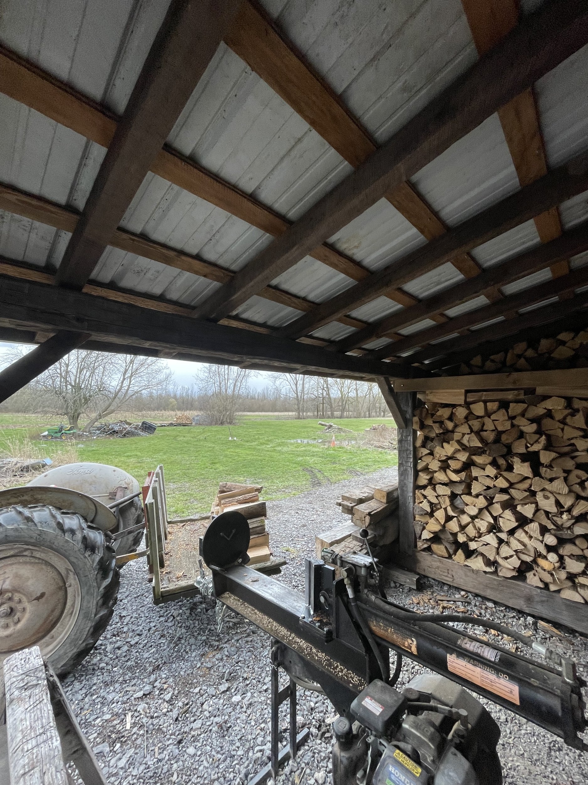

TSC I have split white an red oak, poplar, hickory and it has not stopped with any of it.
