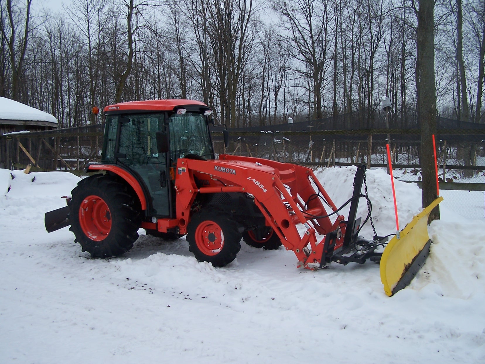

N.E Pa.
haveissues, snowplows on tractors are controversial. If I could get away with a plow and ballast on the Kioti, I'd go that route. I'd really like to use the SSQA.

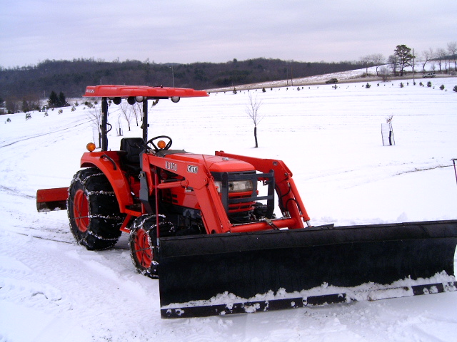

I've been using that setup for years. Works fine

As long as the plow trips (has springs and will fold forward if you hit something) and you are cautious, you should be okay with the plow. Honestly, though, a rear blower is a better tool. You don't make snow banks on the side of your drive that catch blowing snow.

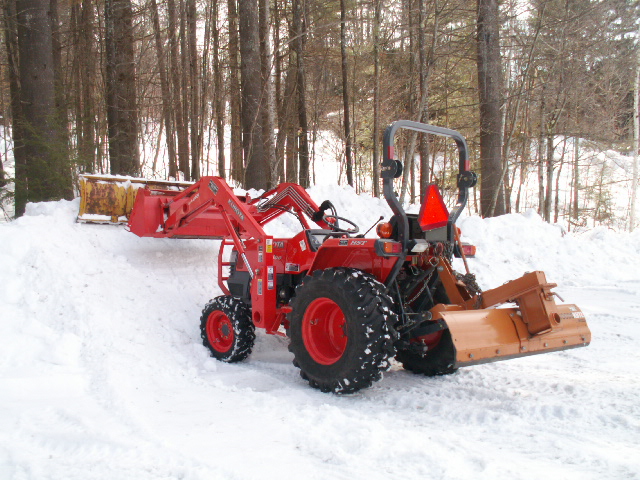

Lots here have FEL mounted plows.
