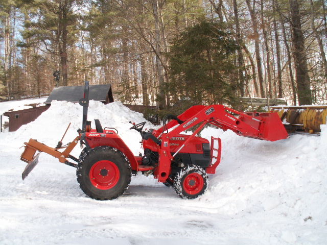

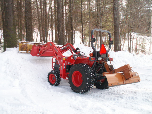

Been pushing w/blade for many years,far as pushing back snow bank all comes down to common sense.
