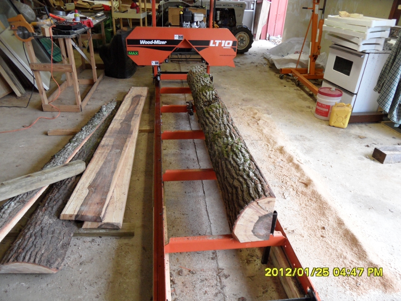

The Woodmizer is and will be "ground mounted".
I only need to lift the log a foot or so. I used the 3 pt with shorter logs when I had the Satoh 670, worked great.

I like Trials suggestion above particularly if you can set up to back over your carriage. A smaller tractor would work and you can keep the wood cleaner by not dragging in the dirt. Should be better for the saw. Otherwise, something as simple as a Carolina engine lift or overhead hoist could lift the logs at the saw.
