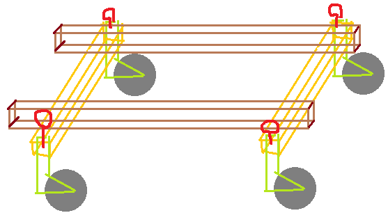

custom made cheap mini trailer...perhaps boat trailer or i should say, dolly with caster wheels.
two, 2x6's 20 foot long, some cross members below that. to attach caster wheels to. ((guessing a larger rubber caster wheels)) some eye bolts or like for tie down or lifting points.
let the dolly go down into the water, float a dock on to it. pull it up and out. and then turn tractor around for use of 3pt hitch forks. (lift both dolly and dock) up as a single unit. if need be set down were needed, and push it about with FEL or edge end of a fork. you would need a dolly for each dock.
running gear = the metal frame work and wheels, that are under hay wagons. add a couple extra frame work out each side. (no deck) might be an option, 2 docks per unit. over winter. (just leave docks on the running gear.)

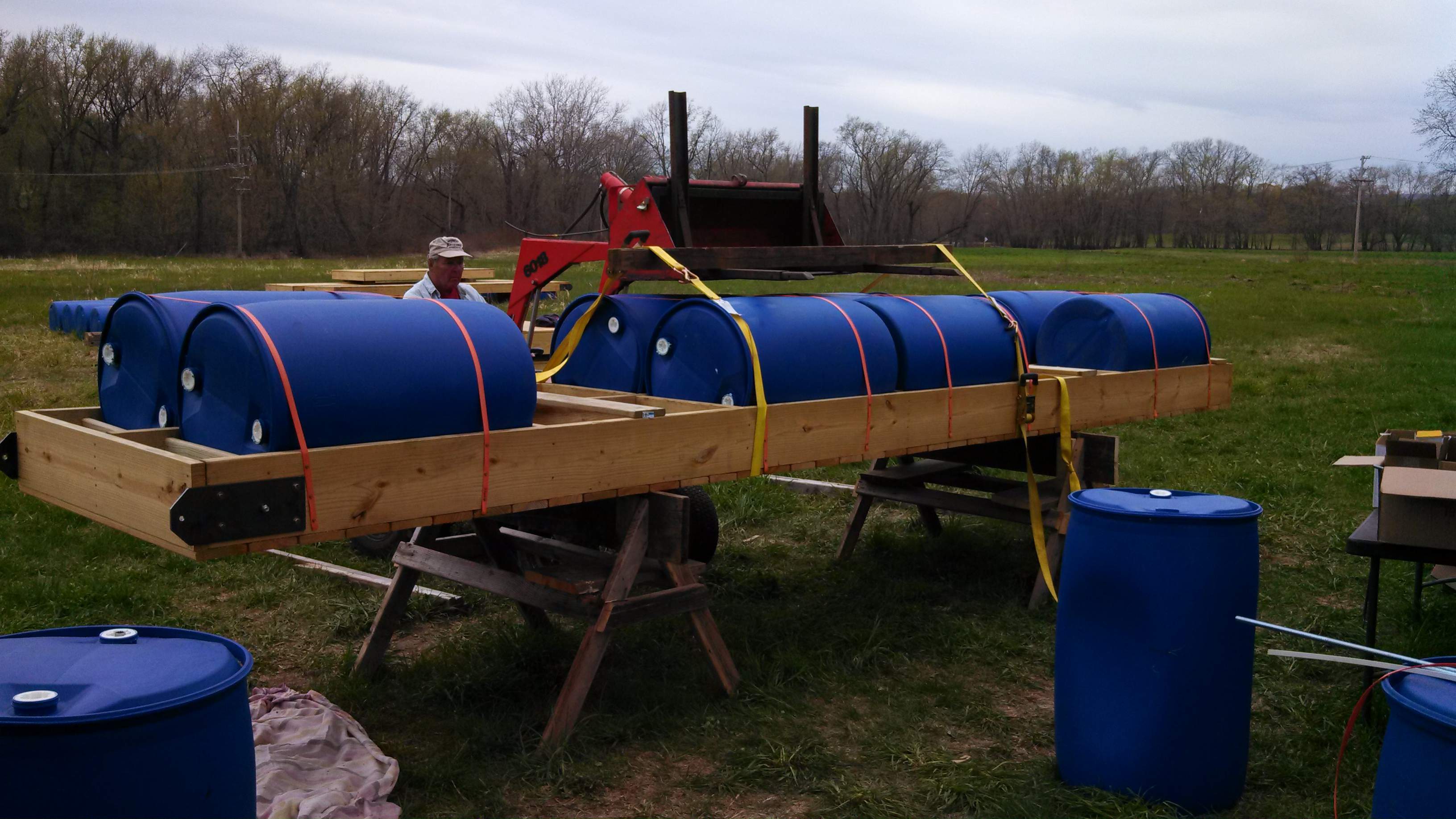

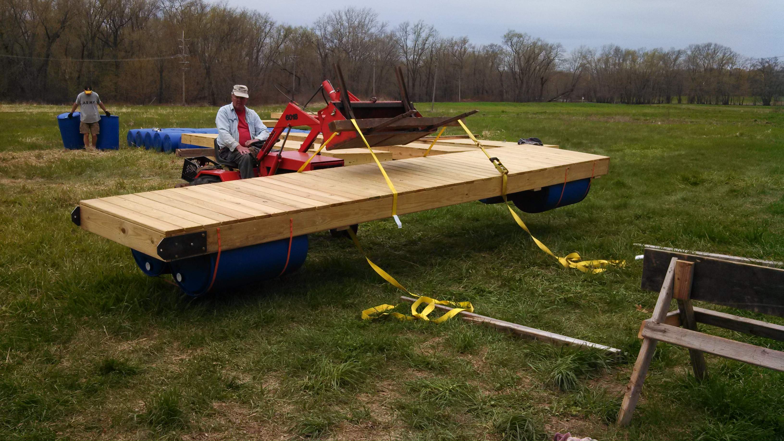

WOW! I never expected this level of feedback. I appreceiate all of the information. Let me add some pictures to the mix. I am able to lift and move all of the dock sections with the ingersoll 6018. Not the smartest thing to do..but it can be done. I have a lot of counterweight on the back and use the bucket to hold the dock so it does not move while moving. I lift all of them from the top using a 4x4 spreader and lifting straps. I am very aware that i am lifting way above what my tractor is capable of, no people are around the sections while in the air. The ground is very level field. It drains very well and is solid.
I have about 5 different sections that I lift. The largest has:
4 2x10x20
40 2x6x8
2 2x10x12
3 float tanks (50lbs each)
hardware: 40lbs
I have sorted this out to be around 1000lbs. The wood is all PT but dried in the sun for a summer.
medium weight section being lifted onto horses
lightest section being moved

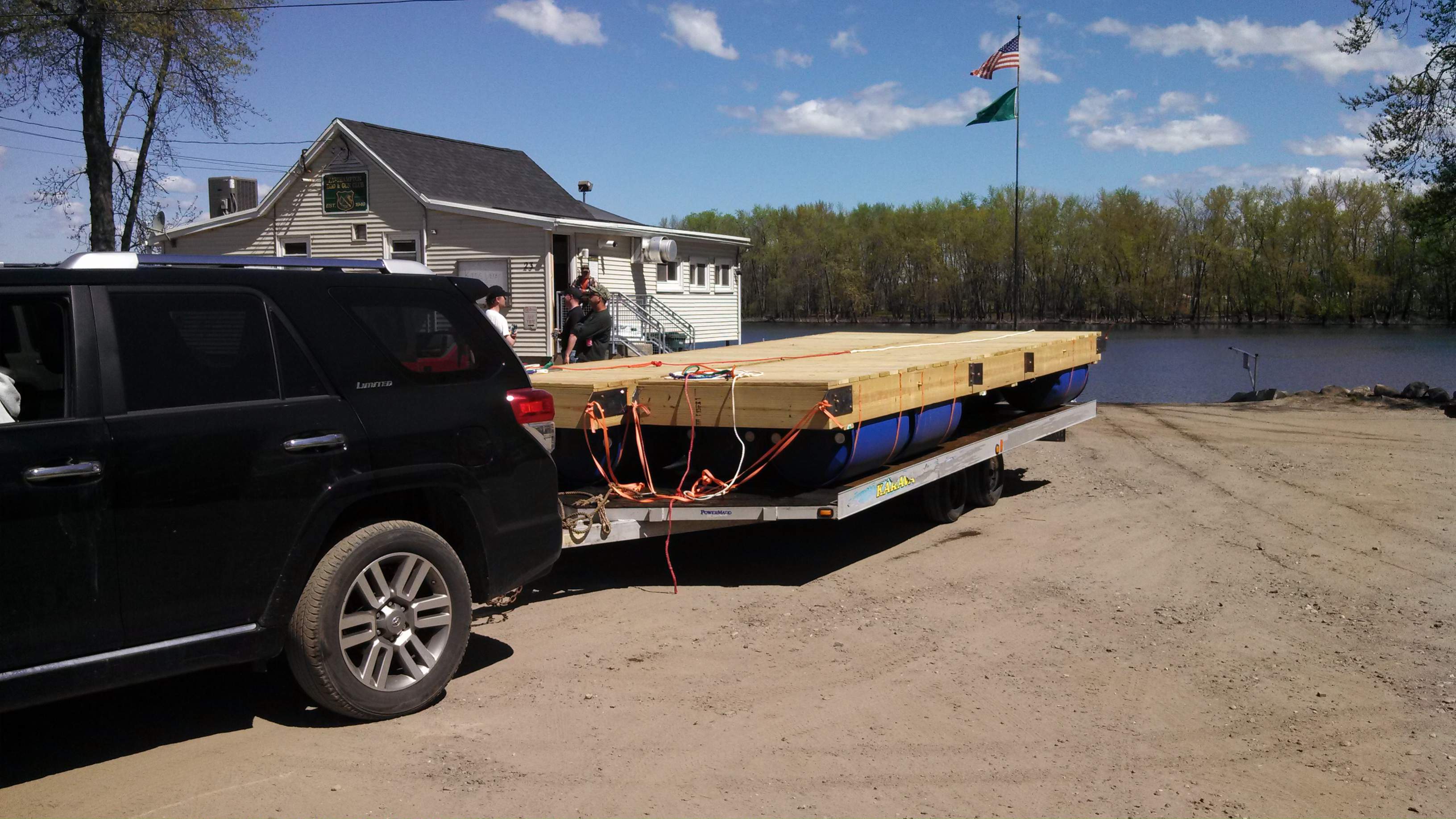

sections on trailer

The launch ramp we use is VERY steep. I need to lift the sections on and off the trailer pictured and launch them that way. I have 14 dock sections.
I have used my 6018 to lift an move the sections, so either it can lift WAY more than listed...or the sections are lighter.
Perhaps I will bring a dock section to the tractor dealer and see how it really works.
I agree that a 2300lb tractor should not be able to lift 1000lb docks.

My current trailer is a Worthington aluminum 6x10 3500lb axle. Weight of trailer is 450lbs. It has wood sides and is a tilt trailer.
