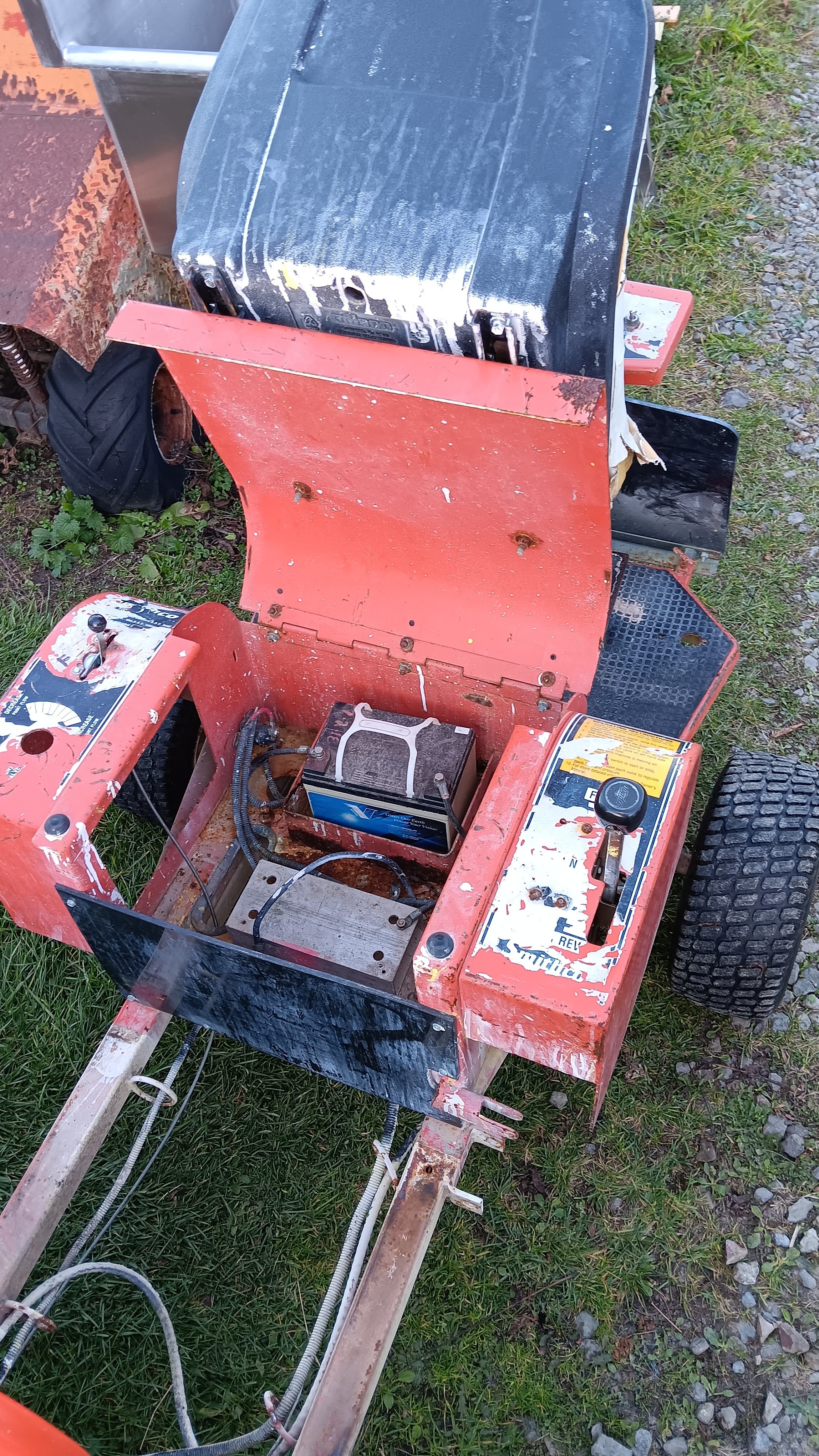

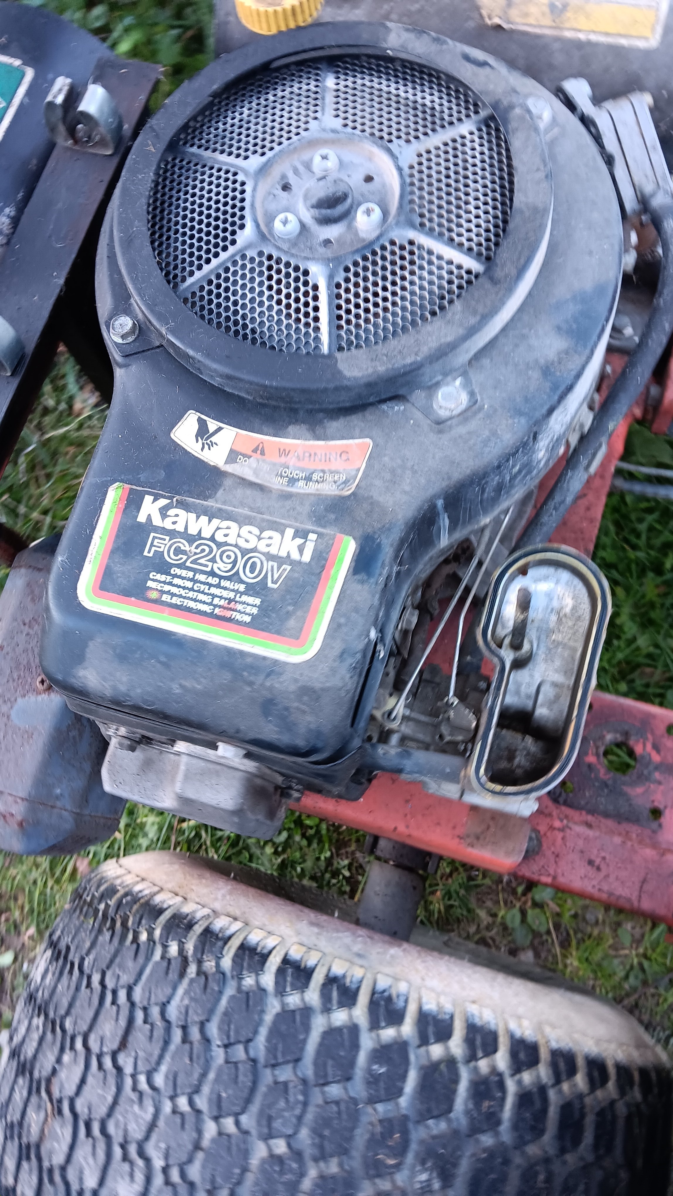

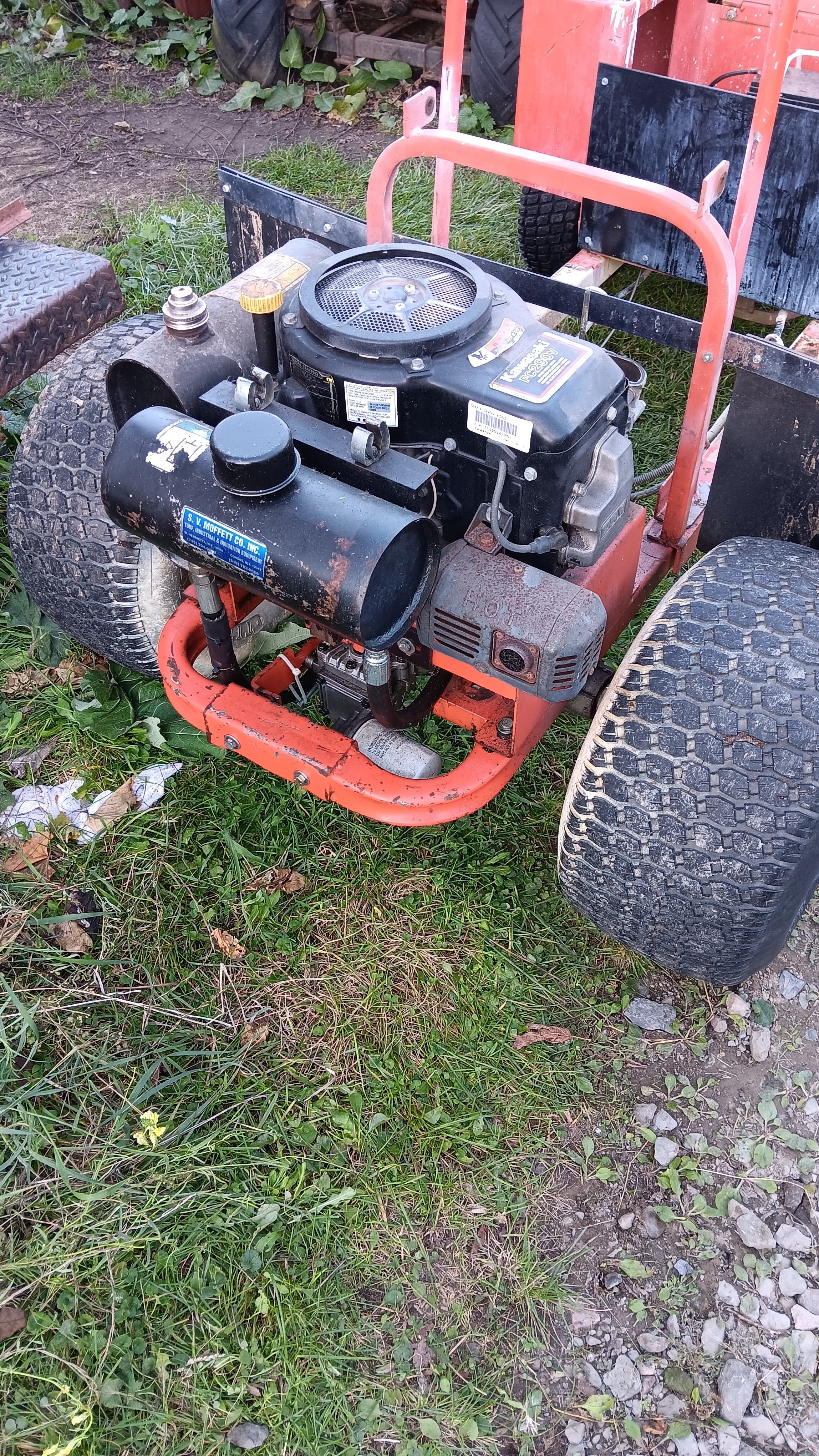

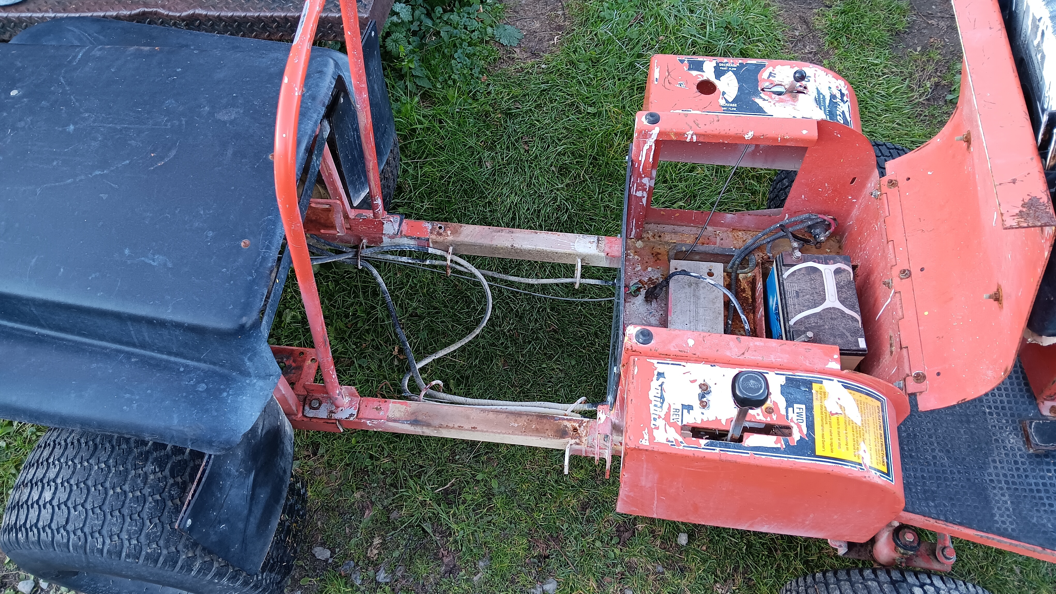

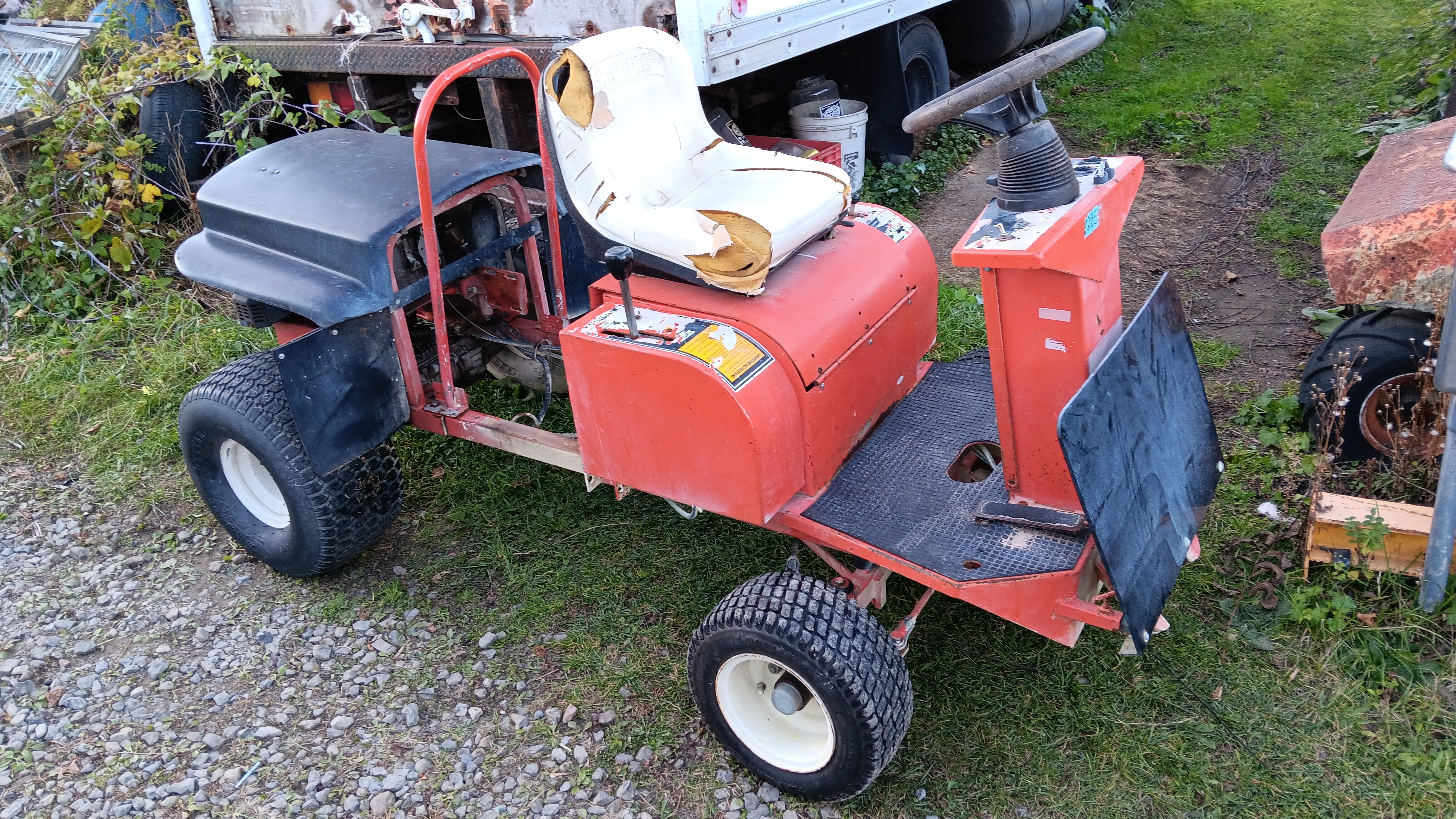

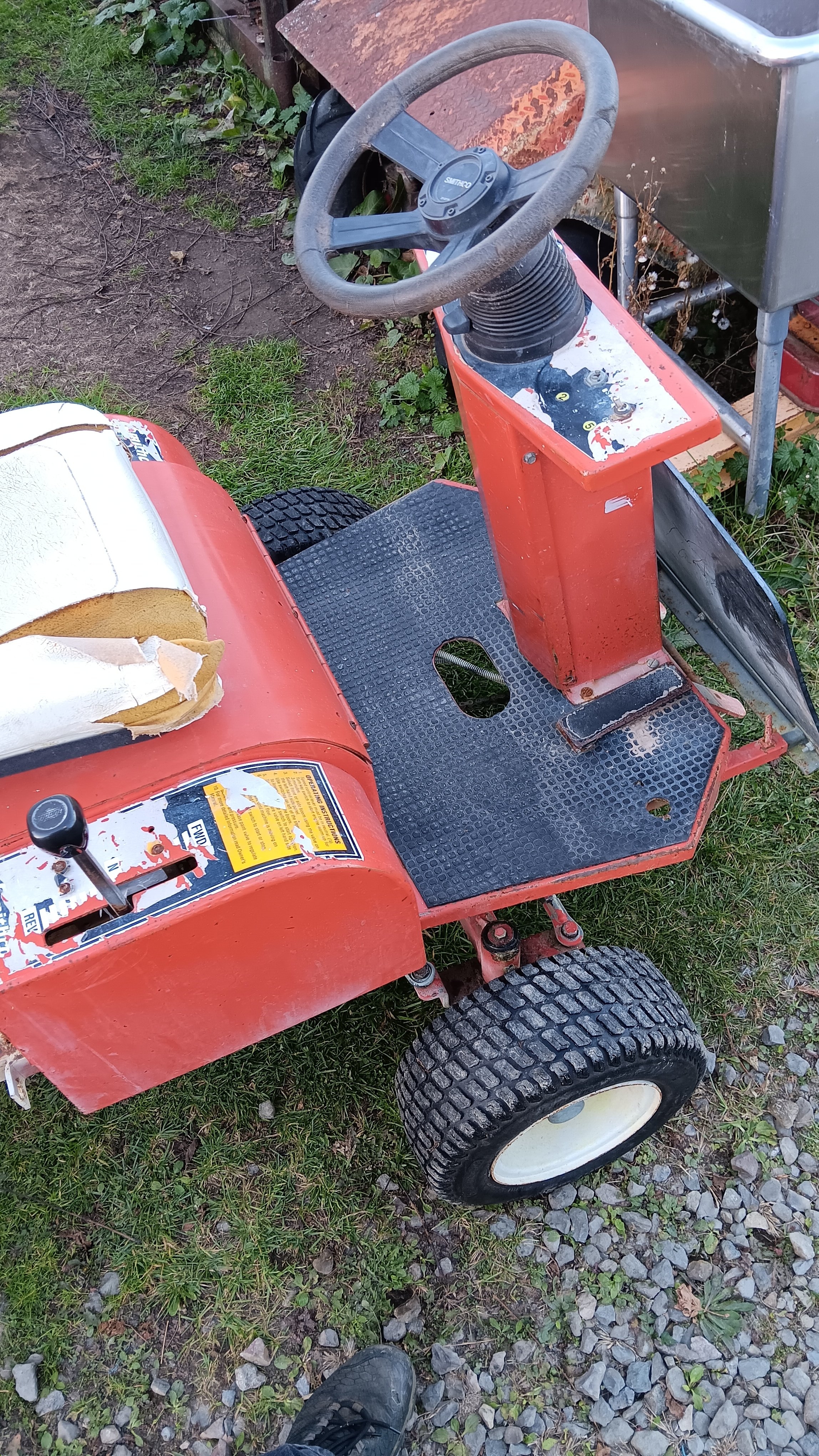

Some more pictures of the Smithco Line Stripe-er
The 9hp Kawasaki vertical shaft engine is very similar to the horizontal shaft engines used in Club Car golf carts.
It has an internal balance shaft. Drive is an Eaton 851 trans axle. It's got an internal wet brake (which Smithco
never used) and a bypass valve for towing. The way it is right now, there is no safety devices of any kind. Not
sure it even ever had a seat shut off switch. You can move the F-N-R lever and it will go, operator or not.
The pedal that's there was used to activate the spray booms. I plan on connecting it to the brake so it has
to be depressed to release the brake, spring return to brake on position.

Now I REALLY want one. Hydro just like my old JD 185. It is very handy to be able to move the machine with the hydro lever while you walk along beside, such as when using a sprayer or moving a trailer, etc.
