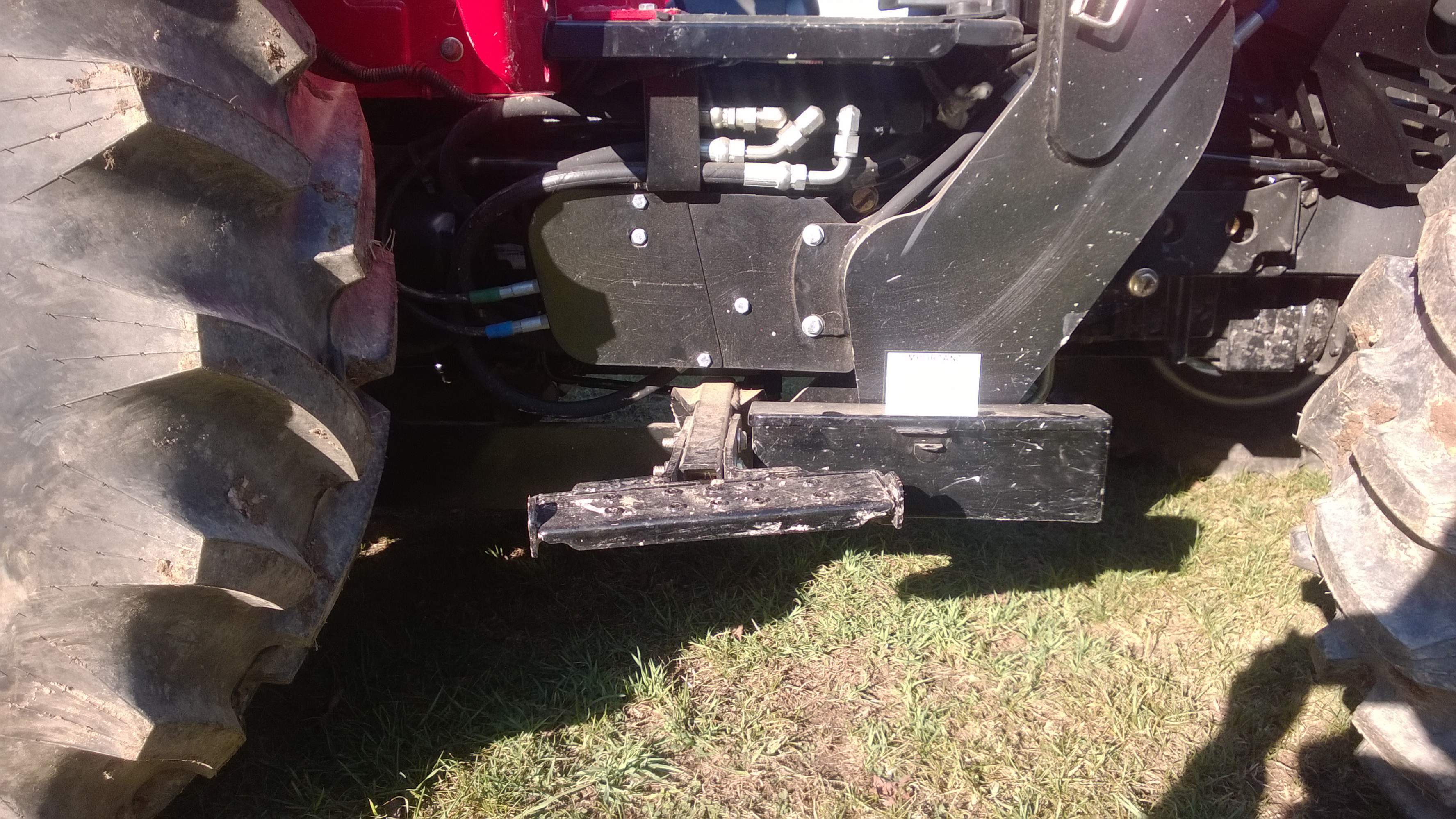

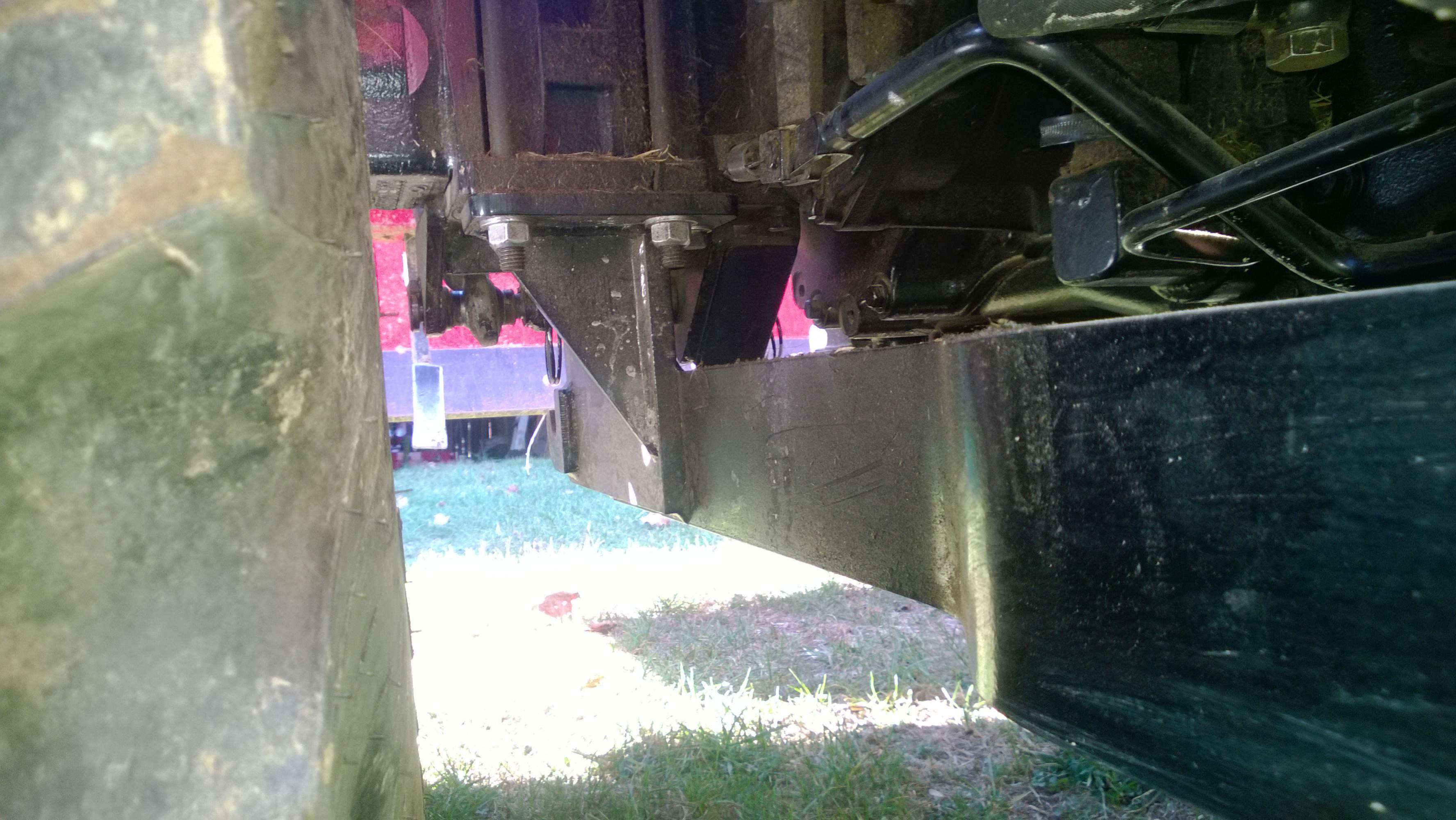

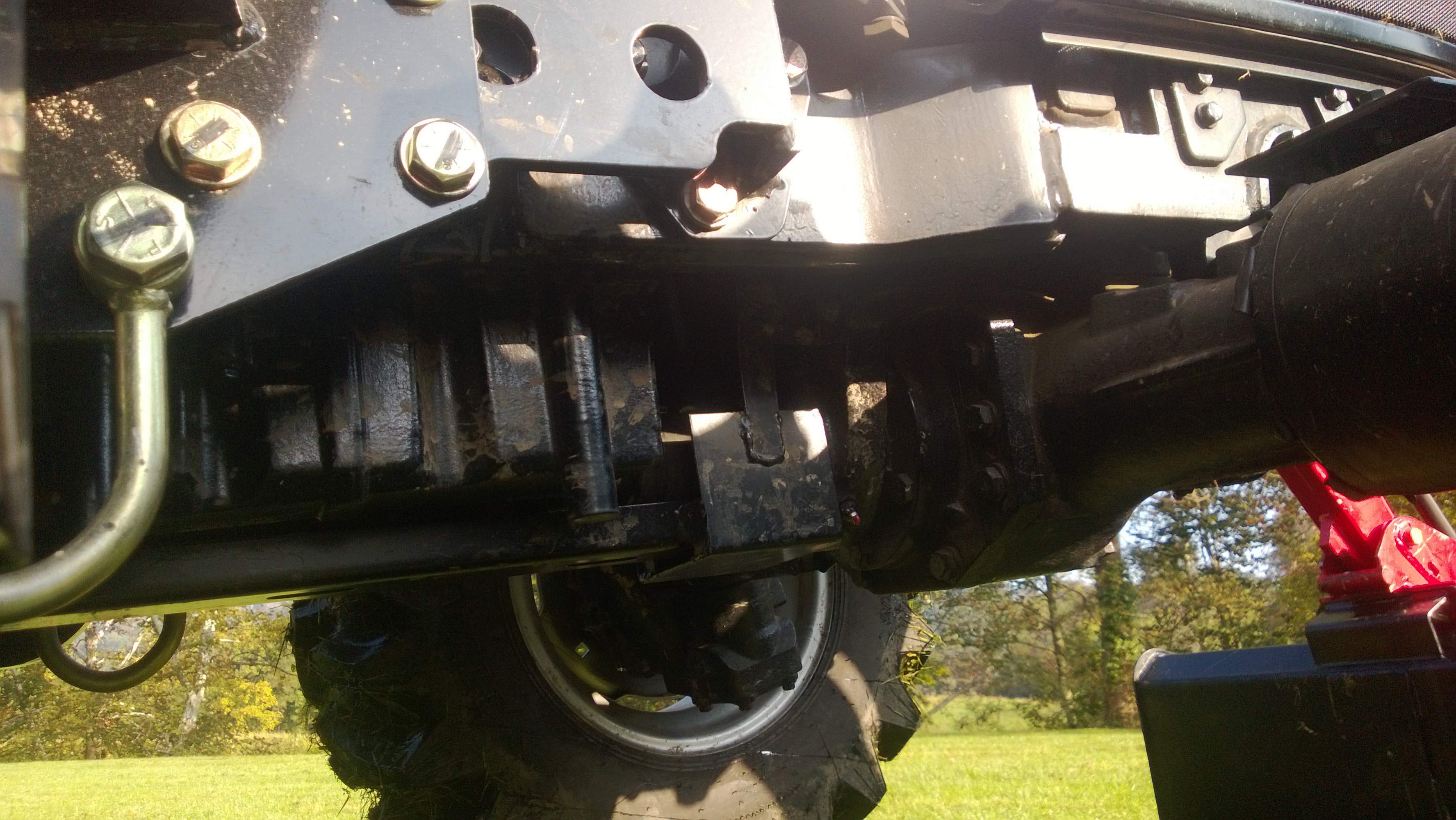

Would you mind posting a picture of that?
Got you a couple better pictures today (I think).
Ok, for reference, the picture I showed you before:
...was from the right side looking forward to the front axle. All those bolt heads in the top left view are part of the subframe attachment. The big tie-down loop is attached to the subframe as well.

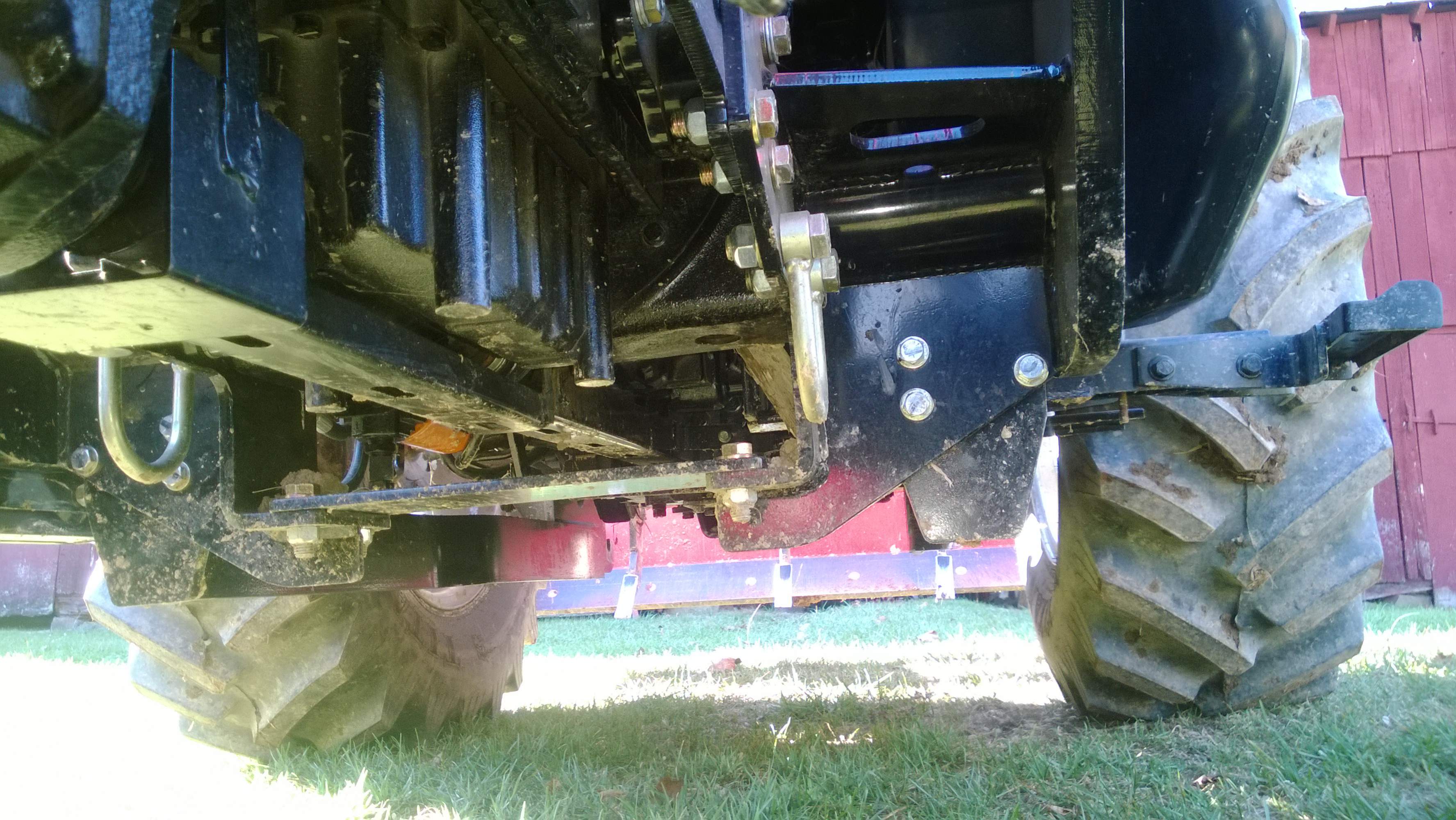

This following picture:
...is showing the same area of the tractor (right side) but is looking over the front axle, below the loader arm.

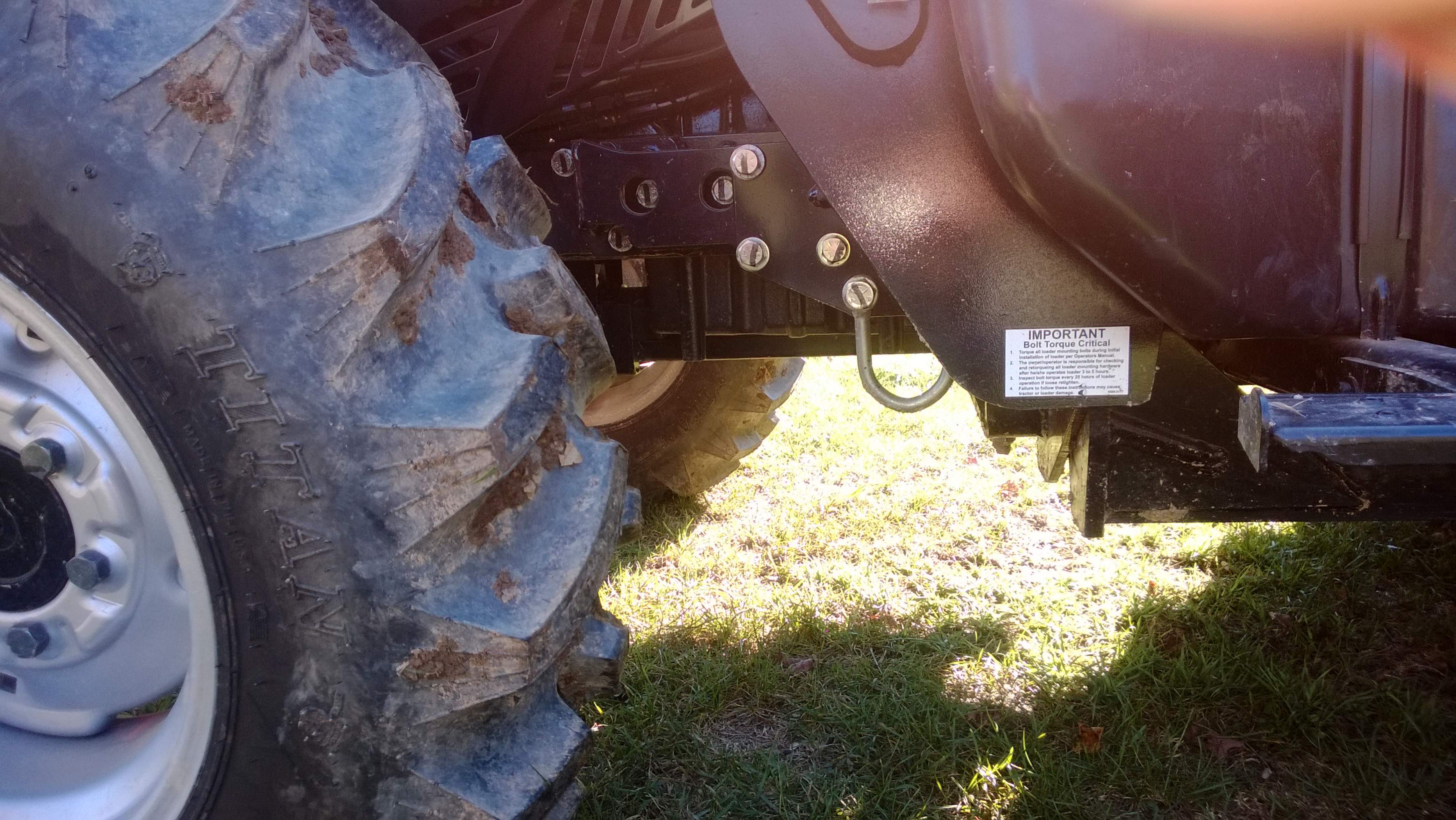

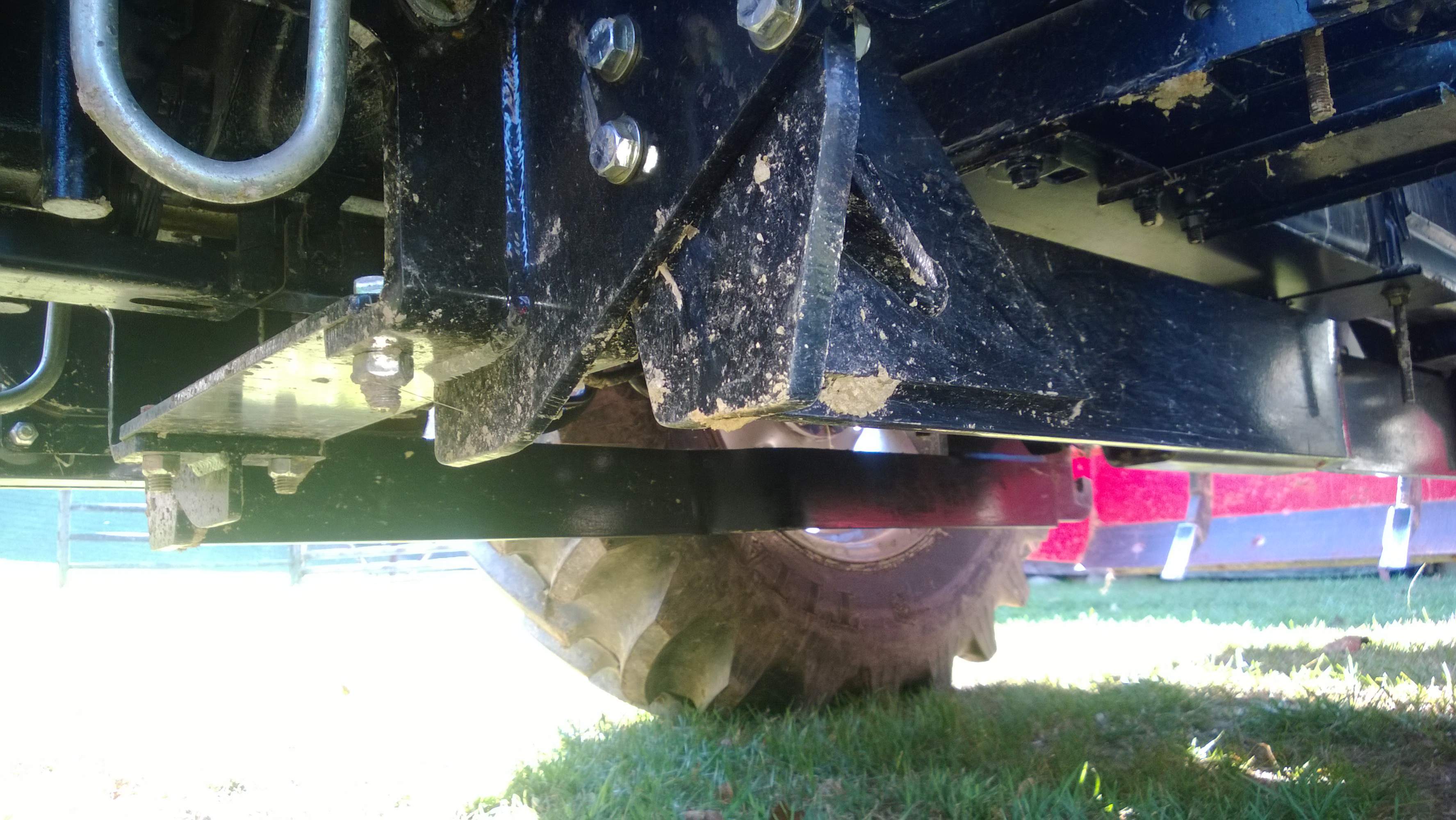

These two pictures:
...are showing the same area of the of the tractor, looking in more squarely to show how far forward these subframe parts attach.

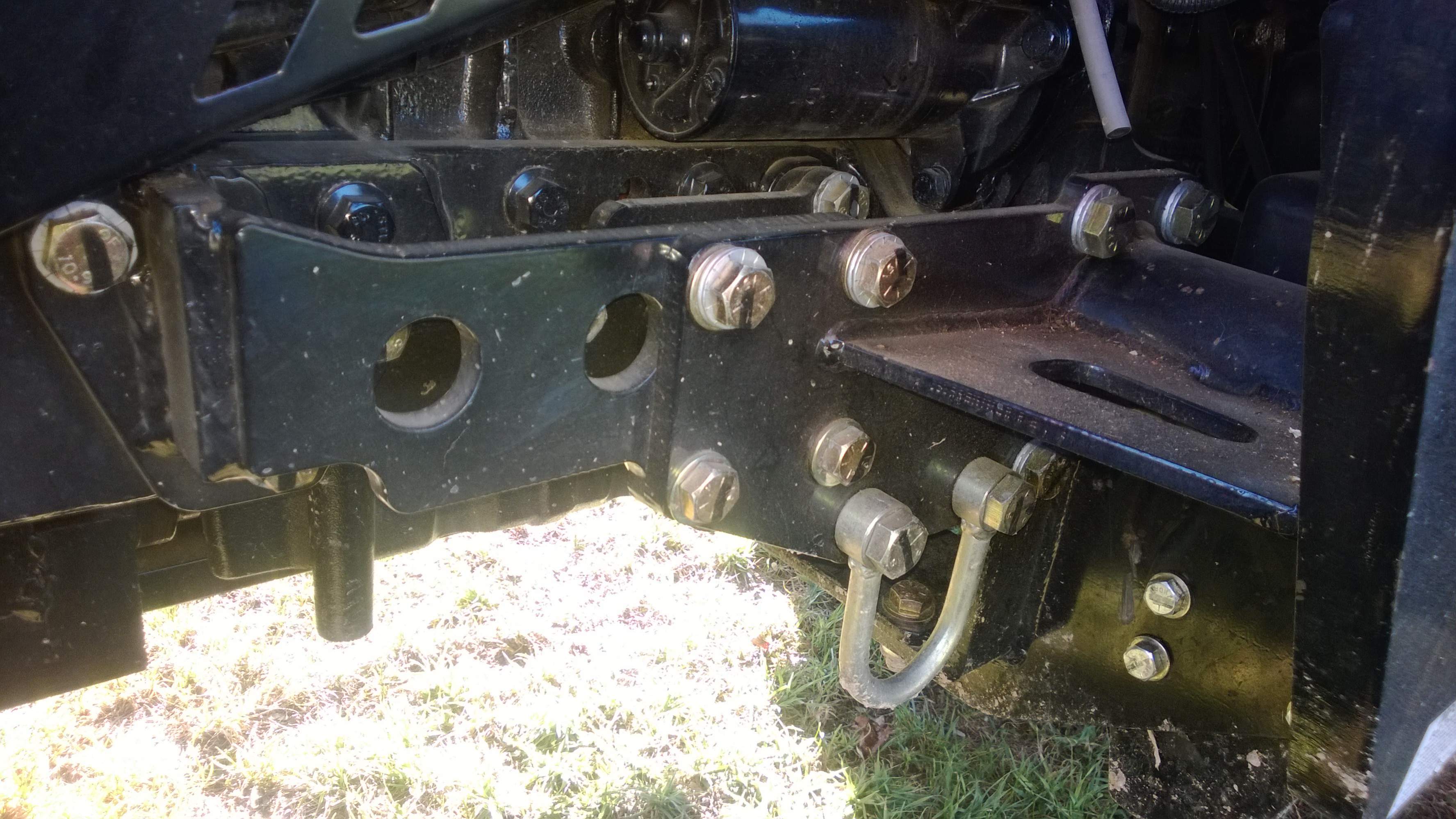

This picture:
...shows back into part of the left side subframe. I was able to get a better shot on this side not having the loader hoses in the way...

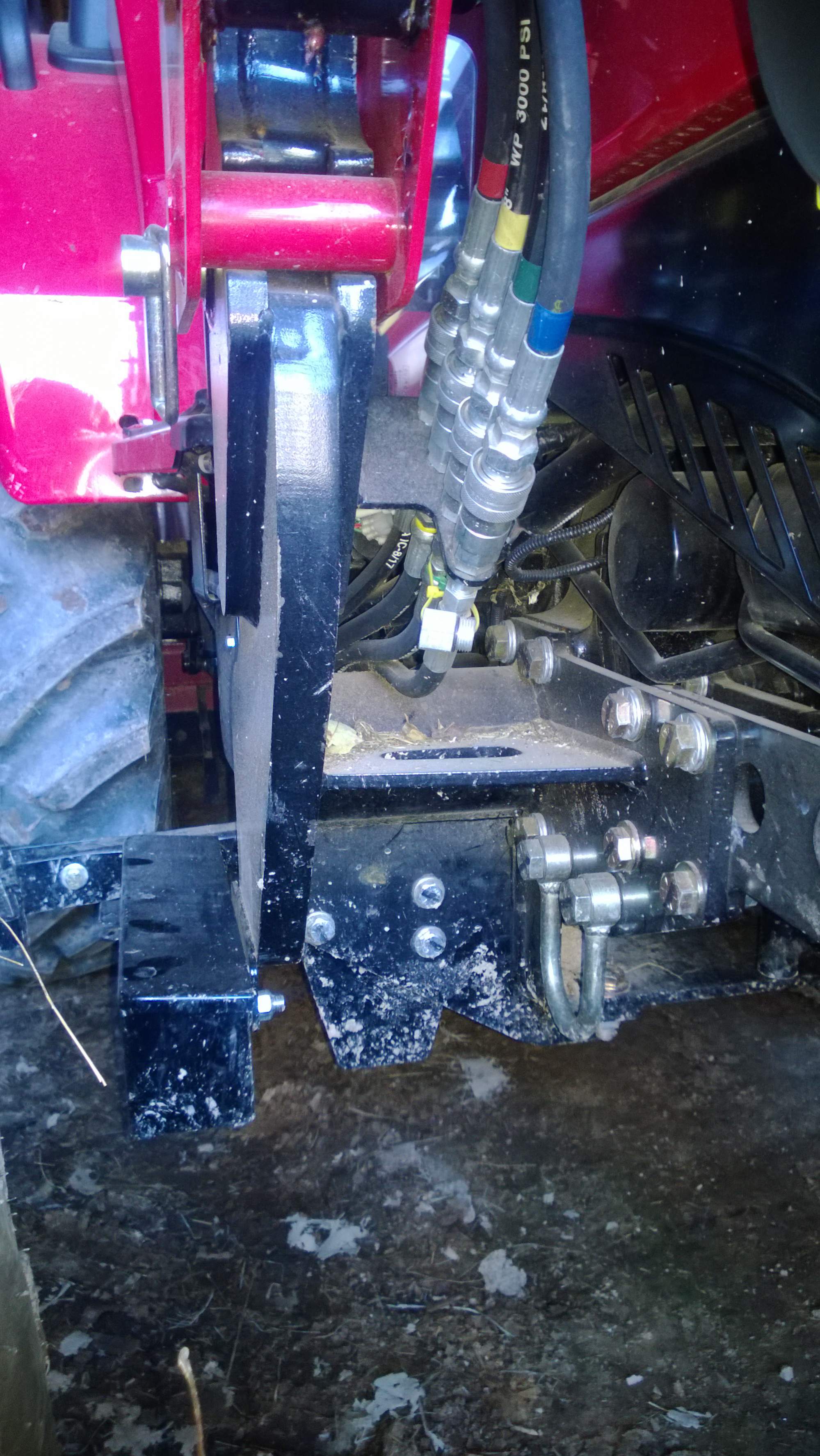

This is a good one:
In this view you can see the section of subframe that goes across under the tractor to tie the two sides together for extra rigidity. And you can see the long section of subframe that reaches back the to the rear axle and beyond and ties in for the backhoe to hang on...
This is another good one:
...showing (from the left side) the crossmember as well as how the rear section of subframe ties in and is gusseted.
Here shows:
...how the rear subframe ties to the rear axle.
