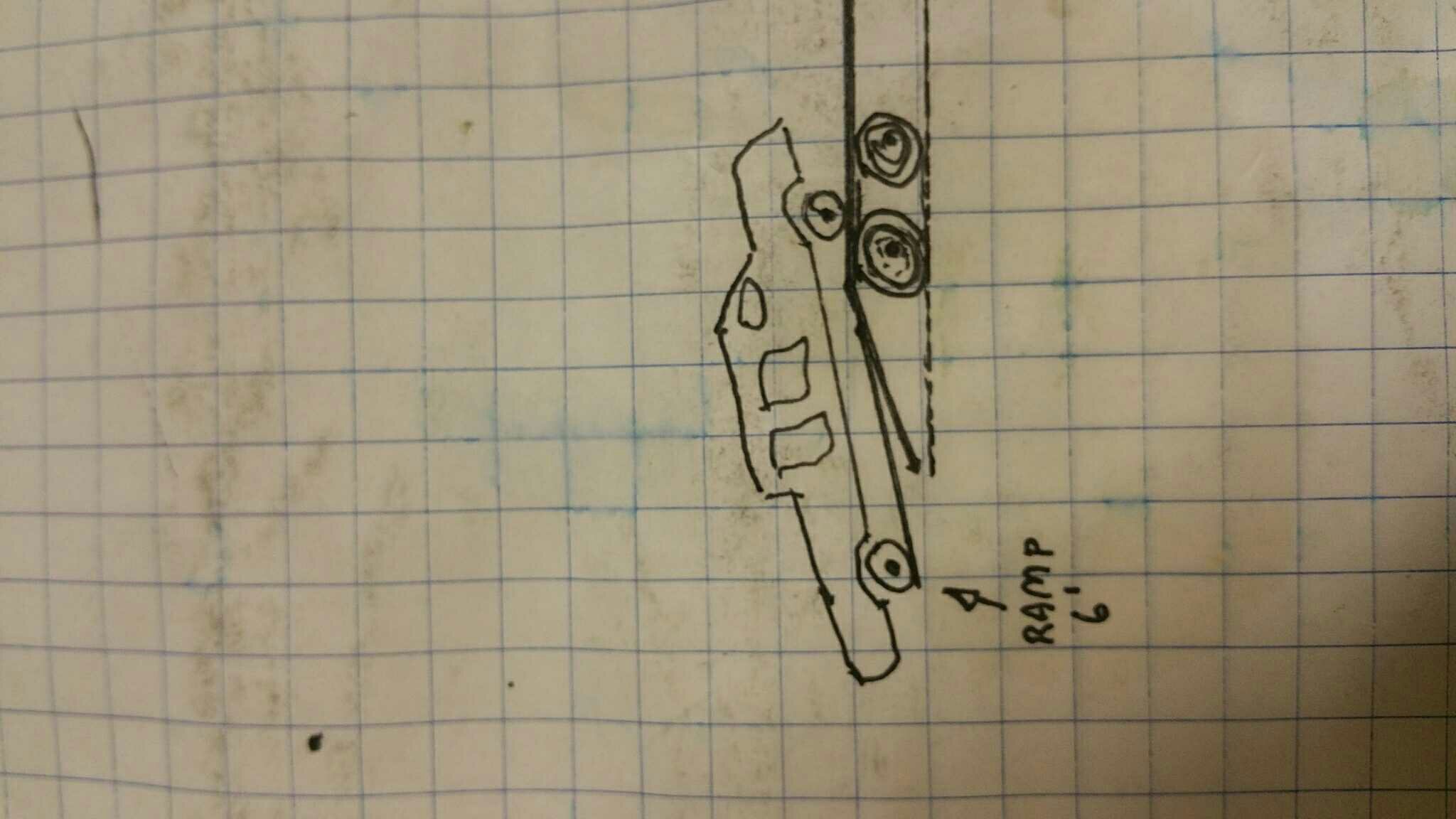

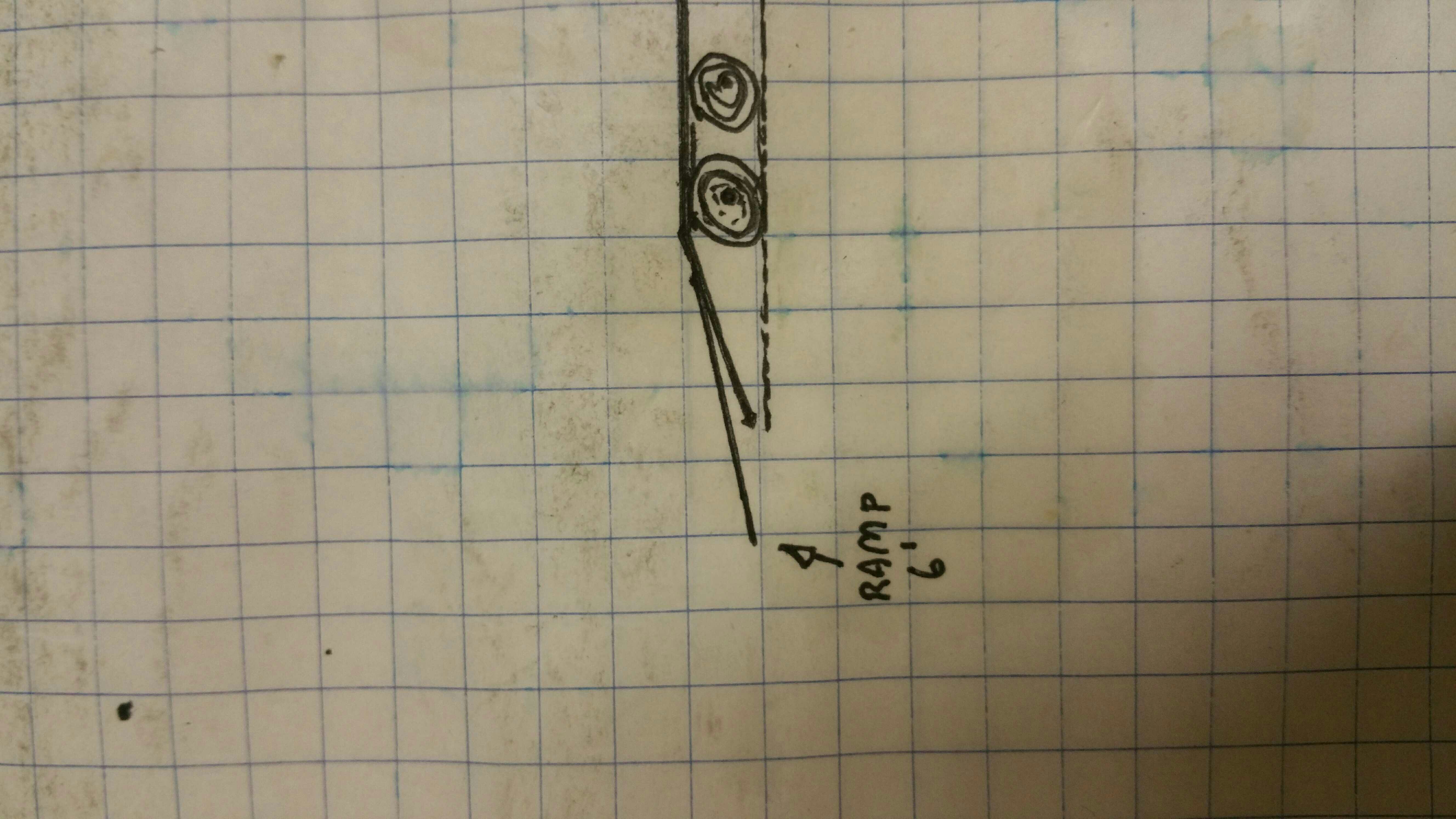

Use a set of ramps 6ft long to load the truck. It will lift the rear wheel when the fronts are on the trailer and give you the space.
Some ramps are already bent with an arch. I had to get some for my side by side for the same problem.
You only need some that handle half the weight of the truck if you only use on axle at a time.
Easy peezy!
My drawings are crude but the lengths are to scale. Assuming a 12ft wheelbase and the 5ft dovetail and 6ft ramp.
This would work I am sure. I thought about it. Would need some decent ramps rated at 5k or more. The truck weighs just over 10k. It would mean buying them though which isn't the end of the world I guess. I was thinking of building some blocks out of stacked 2x8's to lay on either the trailer deck or the ramps/dovetail but I think they would need to be at least 3 maybe 4 thick and 8 feet long which would be rather heavy.
