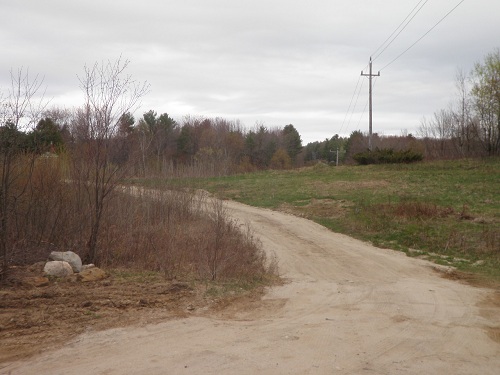

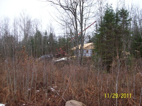

Here are a few more shots:View attachment 301492View attachment 301493 These small poplars I have to get ride of to make the most of the land for planting.
The field that is over grown mostly follows the power line, as you can see, I have some open areas, but not really good enough for planting.
I haven't seen anything in those pictures that makes me think you need a dozer. The brush I see there is shallow rooted stuff that you should be able to pop out with your box blade, brush hog and FEL. I say this because it is exactly how I removed brush on a recently acquired field that looked just like that. A chain will do wonders too. My advise would be to spend a weekend working on it with the tools you have. If you are happy with the progress from that weekend then just keep going. If not, then hire a dozer or find someone with a bigger tractor. You might just surprise yourself....

I agree with several others. Seeing the pics, I'm thinking you have plenty of tractor already. A tooth bar or ratchet rake would help clearing up the roots, but your BB shanks can do that too or a drag harrow or something along those lines. I usually just tip my teeth down hard and drag backward. I've done a lot with my L3800 already and unless my eyeballing your pics to scale is way off, I'd think you will make easy work of it and enjoy the seat time while you're at it.

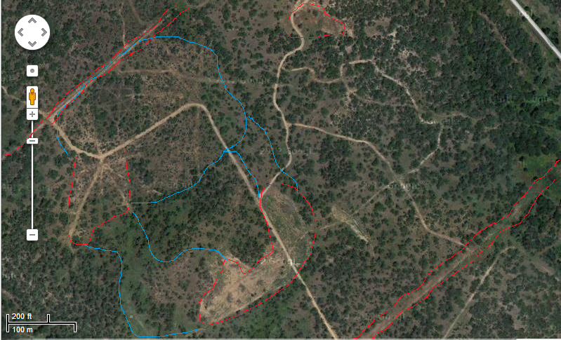

Its a 54hp Case, 2wd, I use the disc for counter weight and it does good. I stay in low and take my time, I dont slam into anything. If it pushes over I go, if not I go around it and go to the next one. I have the 66" Ratchet Rake which is 5/8" thick. . The 1st 4 pics are of the same area from when I started. That area was so thick it was hard to walk through. I have cleared alot of fence lines and heavy brush and Mesquites with it. On the bigger trees upto 4-6" diameter I would guess, I push on the trunk about 6' high or so, if gives and starts to go I continued and alot of the time the root ball will roll up. then back up get behind the root ball and push on out. Some times the tree just breaks. One thing I have learned is if the tree is leaning, push from the side its leaning to, dont push the tree the direction it leans.
Here is a snap shot off google maps, red is what I have cleared so far and blue is what i am planning, plus you can see the roads that I have cut/made

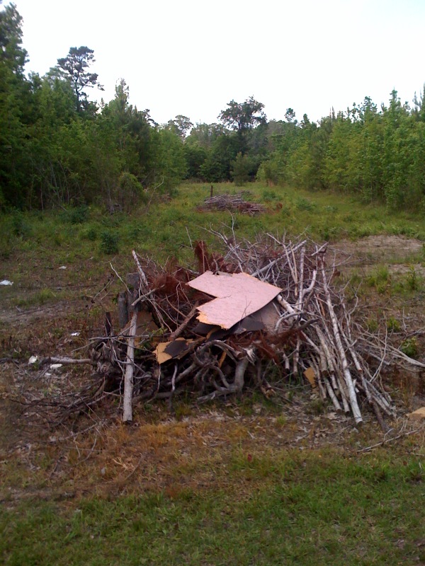

I had a a very simliar situation a couple of years ago. I have been working on the project for a couple of years now but I love it. I could have hired a dozer and still could but I am not going to do it. I only work on it during the winter months and I am in no hurry. But time is the key, If you are really dead set on planting a garden soon then hire a dozer. It will take you 10 times longer than you think, if you really take your time. If you get in a rush you are probably going to tear something up or hurt yourself.
Attached is a picture of a section I cleared 2 years ago. IT was some thick , looked just like the area to the right and started where that first small pile is. I walked on recently and the stumble is really starting to rot pretty well now, still will be a while before I could plant anything. But that is okay, I actually think I am enjoying the clearing more than I would planting the garden.

Hey that looks like you made some nice pasture land there. I see your trees are larger than most of mine. I do have some areas lie that, but most of mine is overgrown fields that once actually we farmed. The therapy part of it for me is probably the most important.
