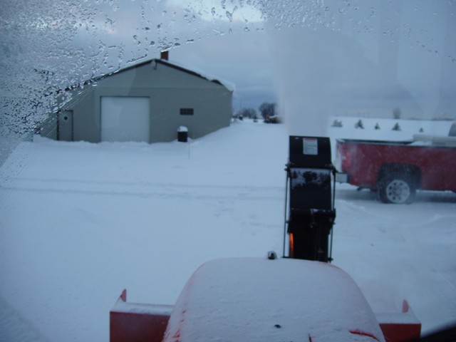

I have a brand new concrete driveway. It's approxmately 300' long. My question is the best way to remove snow from it. Obviously any damage of the surface is no good and must be avoided at all cost.
I have 2 machines available. A Kubota 3830 and a Toro 25 hp garden tractor. Temporarly I have attached a rubber scrapper to my grader blade and pull it with the Kubota. Works okay... but doesn't clean real well because I leave it high. The Kubota is a little big to be running up and down my drive.
Another idea is to buy a snowblower attachment for the Toro. This may be my best bet.
So for all you expert snow removal guys out there.... what would you do? Thank you! :)
I use this..............:D on about 300' of concrete and some gravel

It depends on your conditions and what you want. If you don't get a lot of snow, then a dozer blade is by far the fastest. But, it isn't as neat as a blower. If you are really concerned about damage yet want the speed of a blade, get a real plow blade with shock springs. Your bigger tractor will probably perform best with a blade because it has enough weight to keep traction. The rubber edge is good for both your blade and your drive. You can get front or rear mount. Front mounts can be on your loader arms or frame mount. Some think the loader mounts can damage the loader arms. So don't.
OTH if you have a lot of snow and/or want a clean look without hand shoveling, and don't care about speed on small snow falls then a blower might suit you best. You can get front or rear mount for the bigger tractor. Wind and a blower make for a wet driver. So, you might also want to consider a cab if using a blower.
Don't know much about your Wheelhorse. But, if it's marginal on weight/hp or unless you have tight spaces to work in, outfit the bigger tracter regardless of which way you go.
