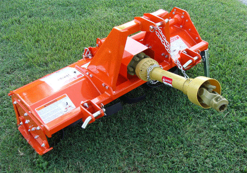

I find an auction rotary tiller on ebay.
accubic on eBay
The accubic RTA48 description say it is comparable with bush hog RTC50G and Phoenix T4 48".
Accubic RTA48
Bush Hog RTC50G
Phoenix T-4 48"
I compare 3 kind of tillers' pictures and RTA48 look nice.
But I have never heard of brand accubic. So can anyone give me some advice? Thanks!

Looks like a dead ringer for our Sicma Phoenix.
Accubic Machinery
Appears to be a mysterious offshore company with no address is marketing various brands over the internet.
Broken English on their website and emphasis on corporate identity leads me to believe a marketing graduate put this company together on the cheap to make cash quickly.
Not sure how you'd handle any warranty issues with this entity.

wow - that looks just like the bushhog tiller but rebranded. I have the rtc-40 for my BX and I can tell you its a really nice tiller. I had it since I bought my BX24 and I think its been 5-6 summers i used it. My father uses my tiller too and no problems. I wouldnt hesitate to get the 48. The BX has plenty of power and I see in the ebay pics it has the slip clutch but not mounted. In ebay pics, I see a chain cover guard and mine did not come with one.

I have the Sicma Phoenix T4 48" that I use with my BX25. It is made in Italy by what is considered by many to be one of the best tiller manufacturers in the world. I believe that the Bush Hog brand is a rebranded Sicma. The fit and finish of mine is superb and the BX handles it just fine. It even covers the tire tracks. I'll bet that the one on ebay is just a cheap Chinese knockoff of the Sicma. The Chinese are capable of building some quality stuff, but can seriously cut corners on the knockoffs to keep costs down. On something like a tiller, it never hurts to buy decent quality the first time around. Get a King Kutter which looks a little rough, but folks say they are tough. or get a Sigma, I got mine from ETA and the orange one is a dead match for the Kubota orange. I personally wouldn't want to risk spending money on a unknown brand of tiller that I can't even examine, just to have it end up sitting in the weeds, broken behind the shed in a couple of years with no parts available.

Buy it from a dealer and have them cut/fit the PTO shaft for your tractor.

What you cannot see is what can hurt you. Metalurgy is largely invisible until something breaks. Then it takes some skill to figure out what the state of the steel actually was. By then, it's too late if the company you bought from doesn't want to answer your phone calls. Because of this, I will only buy an implement like this (ground engaging, PTO driven) from a company that I know, and with a physical domestic presence (Canada & US).
