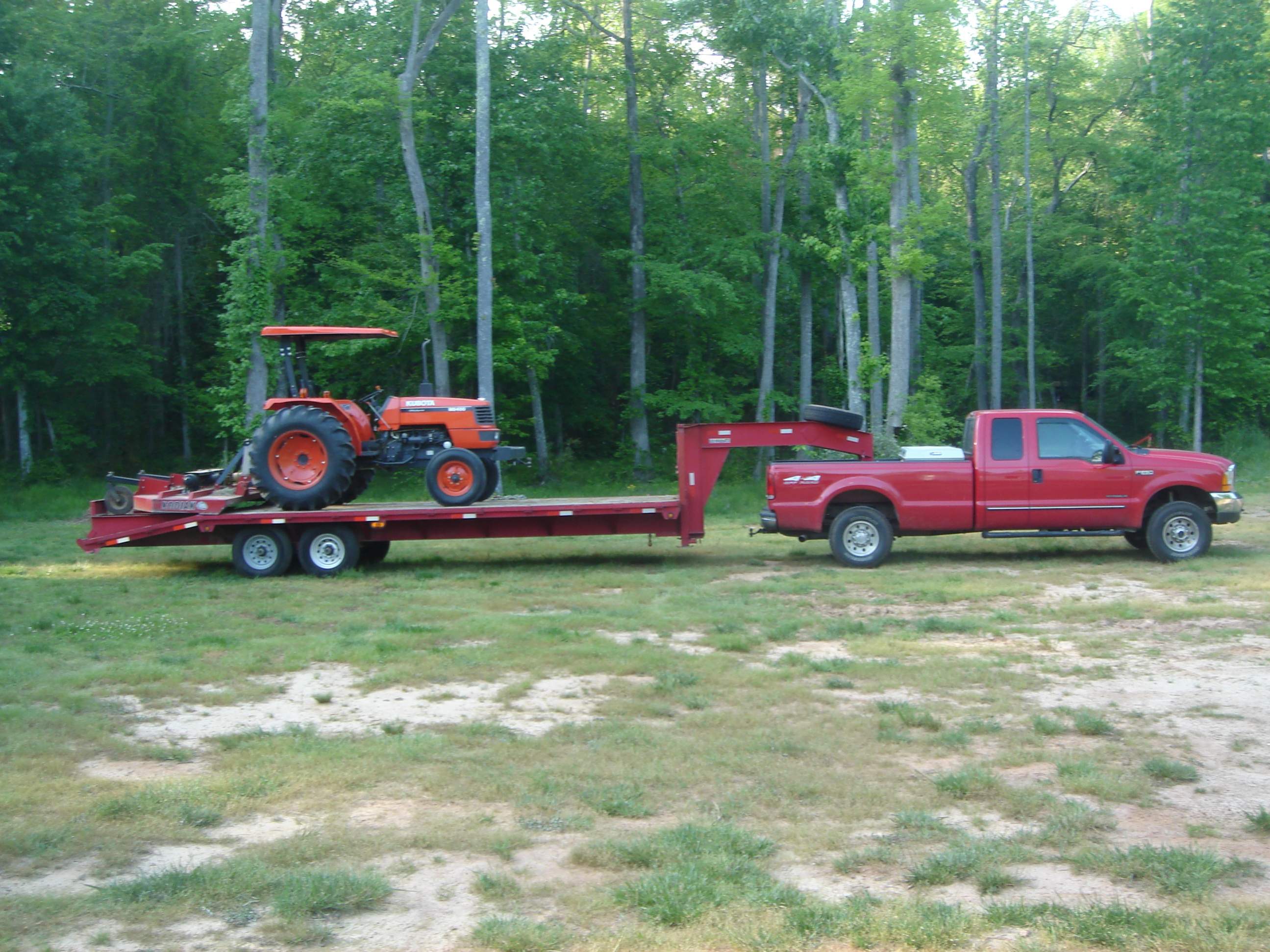

Very interesting post here. Since I have, or had, many of the trucks discussed here I'll throw in my 2 cents worth. I have an F-150 like yours also. Mine is a 1999 XLT lariat 2 wd 4.6L 3:55 gears with 215,00 miles on it. Great truck, it's my daily driver back and forth to work and my errand truck. As far as towing goes it's a DOG! The 4.6L just doesn't have the guts to tow. The only thing I will ever tow with this truck is a 6 x 12 utility trailer with a ZTR lawn mower on it. If you want to tow with a F-150 make sure it has the 5.4L engine. I had a 2000 F-250 V-10 4x4 SWB that I put 158,000 miles on. Also a great truck, probably one of the best trucks I have ever owned. The V-10 was very reliable, quite and powerful. I never did anything to that engine but change the oil. It was great for towing would pull anything you put behind it. The V-10 got a bad rep because of the gas mileage. Like previously stated the 5.4 is just as bad or worse in a F-250 when it comes to MPG. This truck weighted 6,250 lbs dry without me in it. These trucks are made for towing, not MPG. If you want MPG buy a Honda. My current truck is a 1999 F-250 4x4 LWB with the "Powerstroke" diesel engine. Great truck, great engine. Lots of low end torque. Will also pull anything you hook to it. The only disadvantage is the diesel engine requires a little more routine maintenance.
As far as trailers go you will be fine with a bumper pull for the weight you are towing. Just make sure you get a deckover. You DO NOT want fenders. They are evil and the work of Satan. The first trailer I bought for my landscaping company had fenders. It took about two weeks to realize that was a big mistake. You couldn't place a pallet of sod, concrete blocks, mortar mix, etc over the axles due to the fenders being in the way. Also from time to time I rented large tracked skid steers and mini excavators, some models would not fit between the fenders. So I had to swap trailers or pay a delivery/pick-up fee.

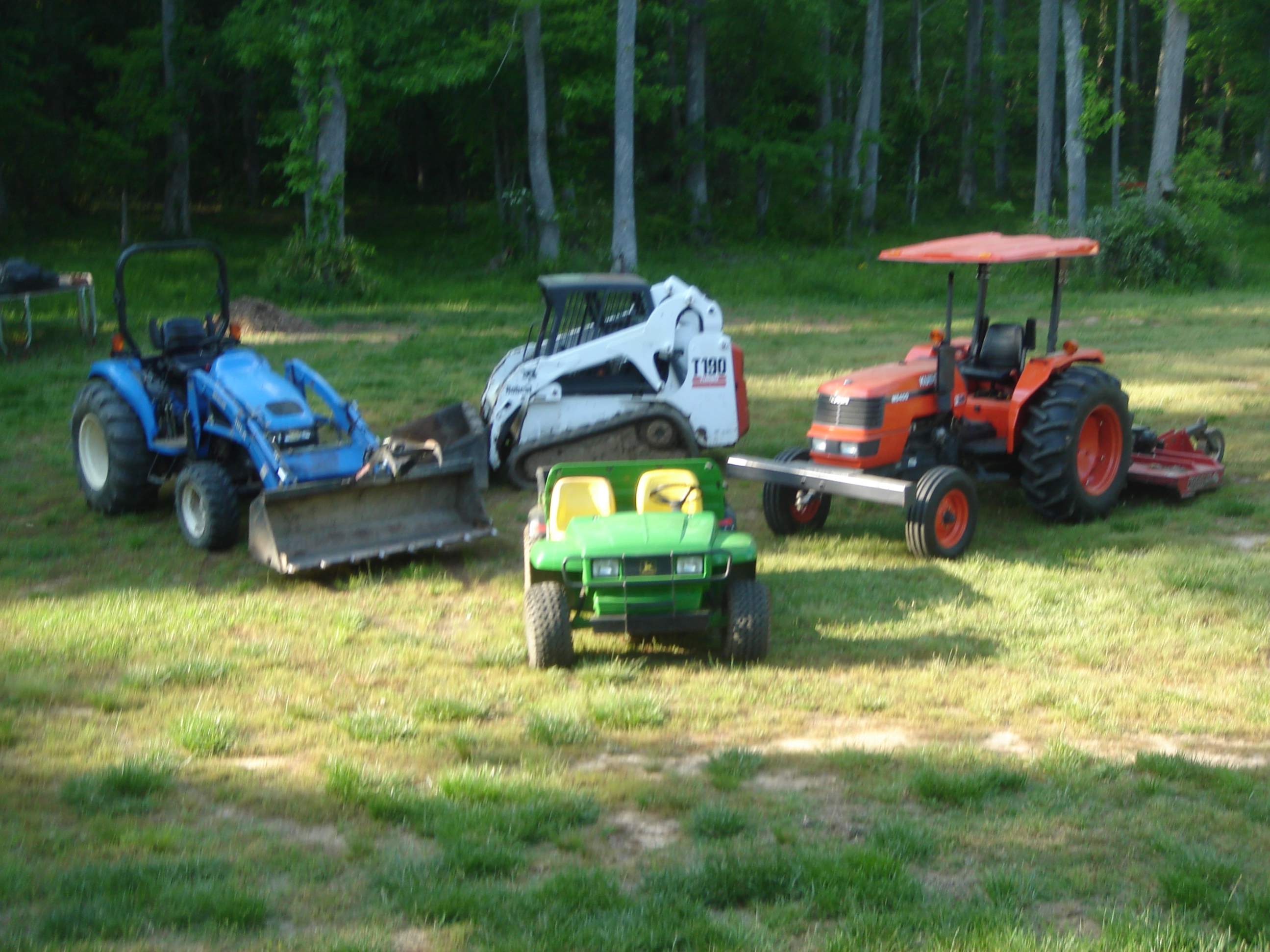

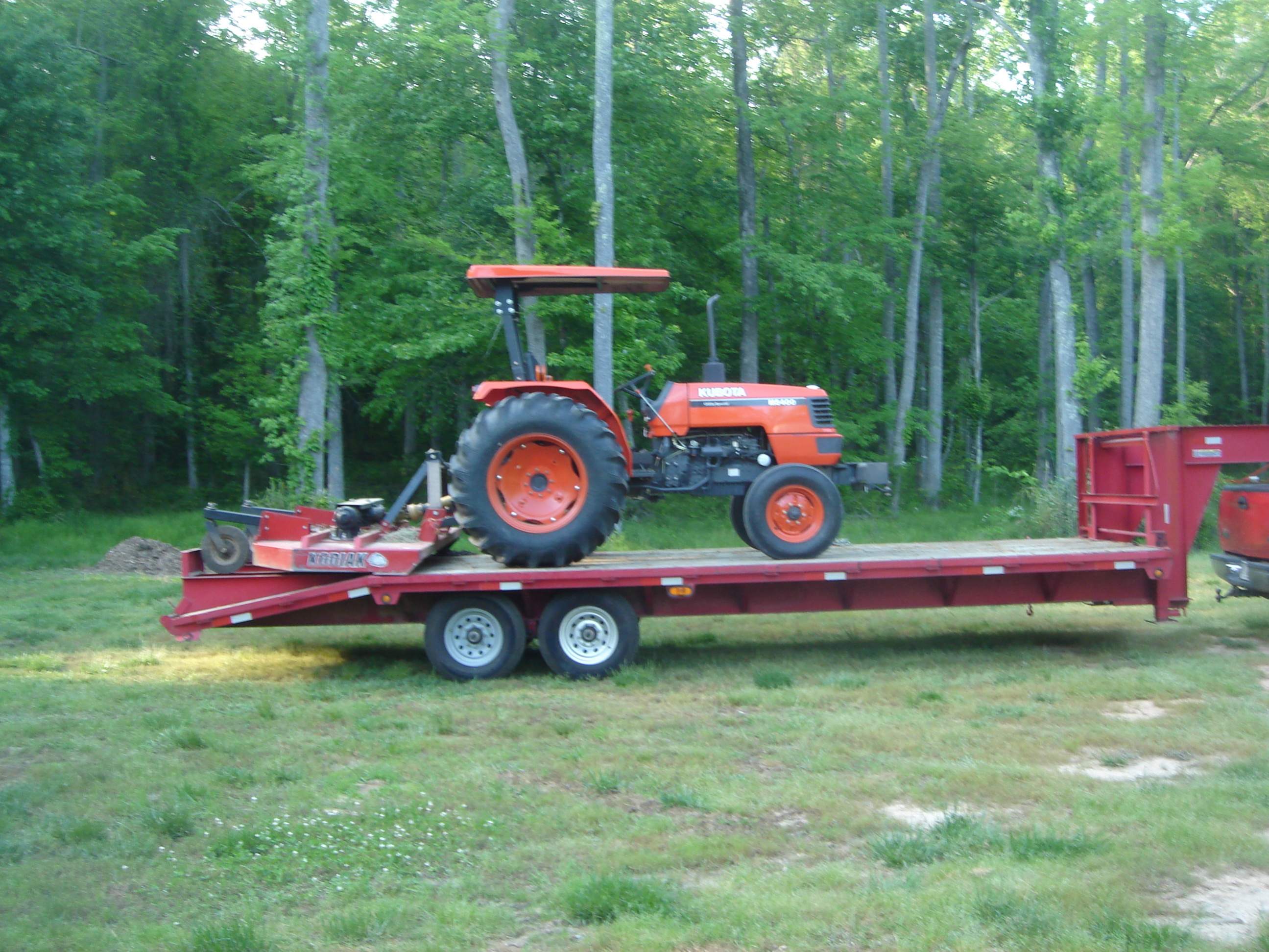

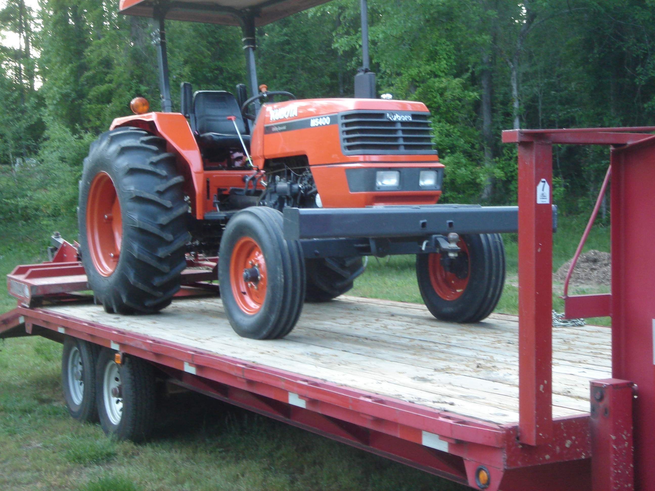

Here are some pics of my current set up. If you have any questions let me know.
Hope this makes sense, I have been out in the sun bush hogging all day.

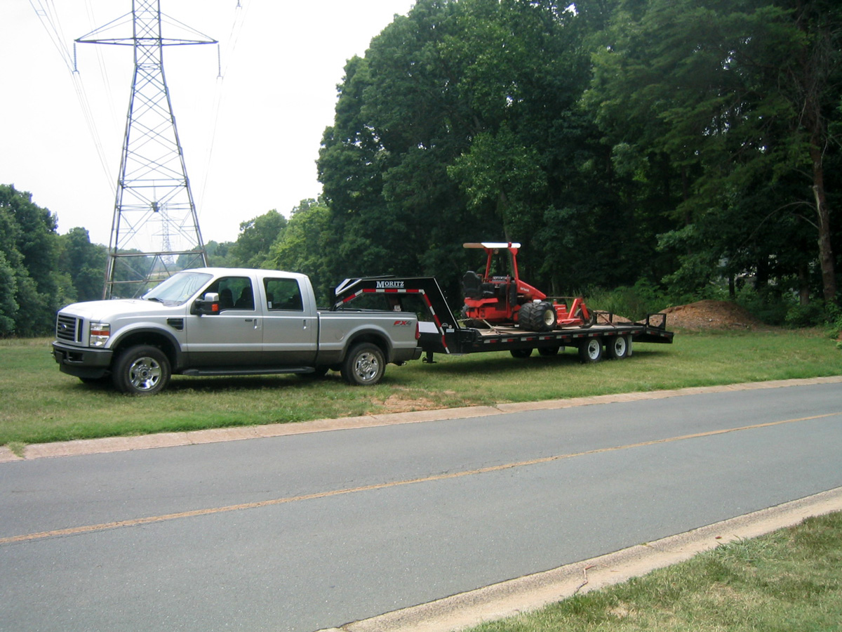

I've got a 2008 Ford V-10, 4.10 gear and pull a Moritz low profile 20'+5' gn deckover. I use it to haul Kubota M9540 w FEL & bush hog (8,000#) or PC-27M Komatsu excavator (7,000#) or KutKwick slopemower (3,000#). Trailer is 15,000 GVWR and weighs 5,400#.
Tractor width is about 86" & slopemower is 96".
Setup has worked great for me.

Nice truck and Trailer
Not sure if I would like that forward leaning upright on the gooseneck though.
It's a one piece steel frame which I think is a better (stronger) design than the units that have two or three pieces connected with plates & welds at the angle transitions.
Isn't it still cut at the angles all but one flange?
