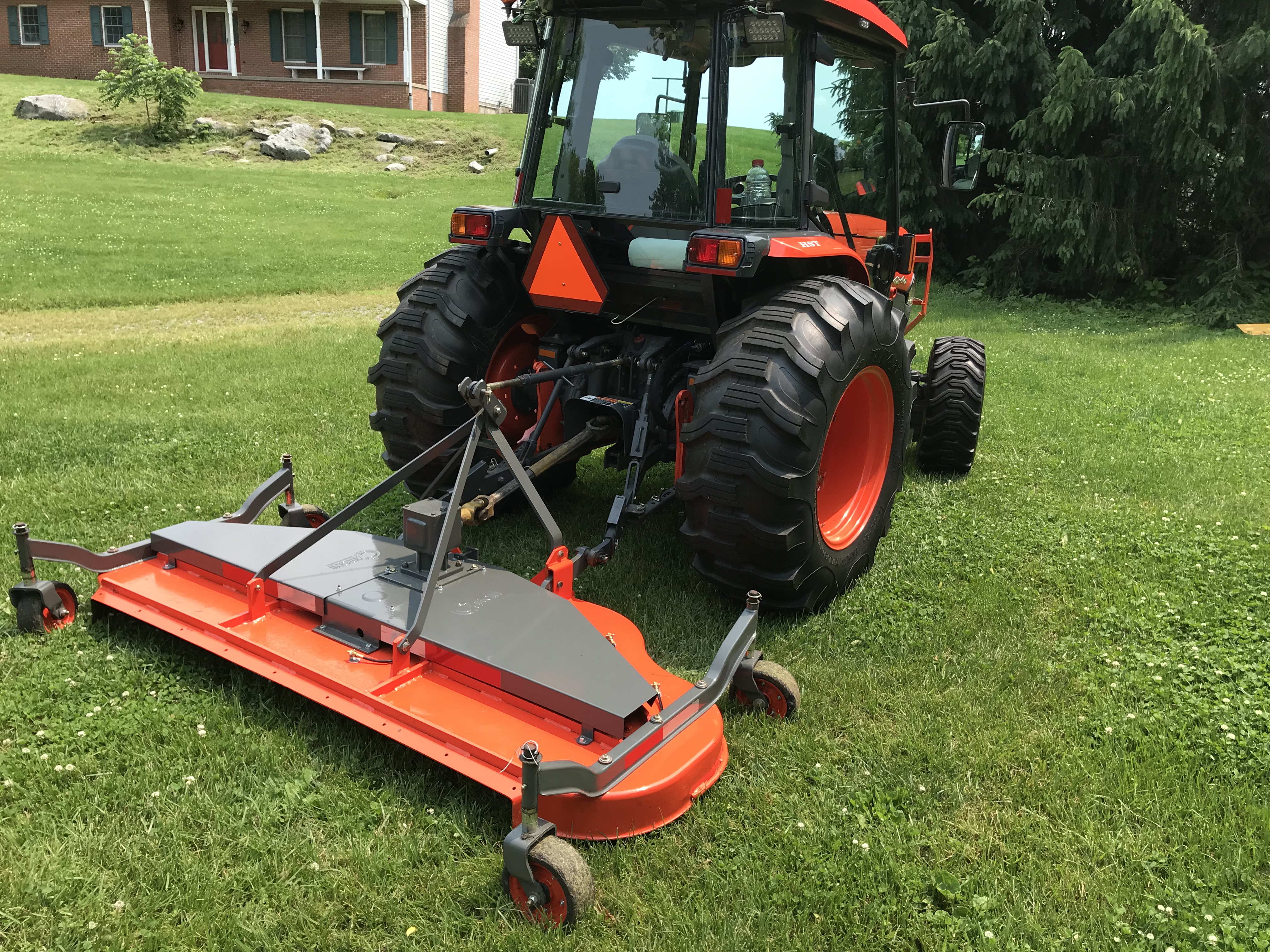

The 5' Caroni we bought new around 1991 is just about to be retired. That deck resides on the Ford and is a backup (and has been abused badly). I've had a 5' LandPride AT on a B7500 and a 6' LandPride 1672 on the L3200. LandPride makes nice equipment and they worked fine.
Last Summer I bought a Caroni 91" RFM that needed some love, knowing we were going to replace the L3200 with something that would have a cab and a few more horses. It took a couple bearings and misc things. For convenience I added the extensions for the spindle greas zerks. The 6' LandPride was used on the L4240 several times until the 91" Caroni was ready. It worked OK on that tractor.
The 91" Caroni is right at home on the L4240 and it works great. I did leave the deflector off the back because it distributes the clippings better without it. This is the best mowing combo I've used since building here in 1989. The Caroni decks are lighter and not as beefy as the LandPride decks. Still love them. A week ago there was a used 5' Caroni on Craigslist and I snapped it up. It will replace the original one on the Ford and since most of the Caroni parts swap I'll have spare parts on hand. Here's a shot of the re-done 91" Caroni.
