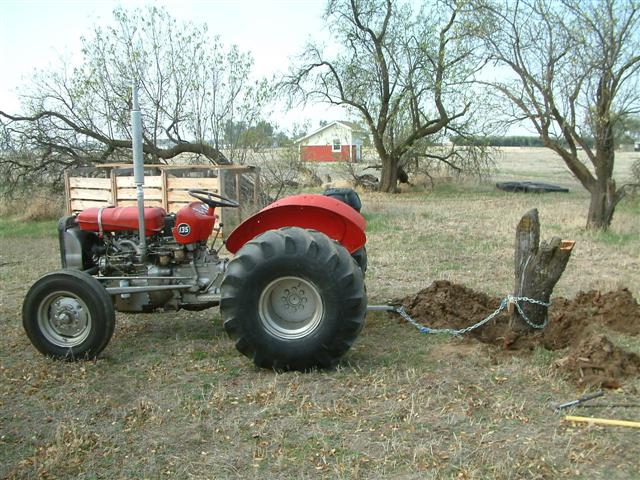

All hills? Get the tractor with the widest wheel track and the lowest stance. Want the tractor center of gravity as low as possible consistent with ground clearance requirements that depend on how rugged your land actually is. Safety first, last and always when working on hills.
For example, here is my 1964 Massey Ferguson 135 diesel that has been modified from a field tractor configuration to squat low for work in the olive orchards around here. The wheel track is 84" wide (measured to the outside of the rear wheels) and the centerline of the rear axle is 20" above the ground. The front axle spindles have been shortened to keep the tractor level. The rear tires are Goodrich 6 ply 18.4-16A (18" wide, 16" dia rim) and are 40" tall overall.

Good luck and be careful out there.
View attachment 301920View attachment 301921
Good luck and be careful out there.[/QU

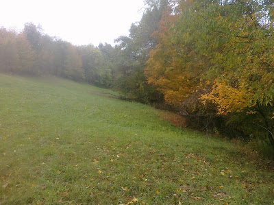

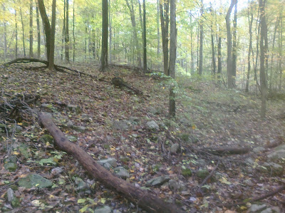

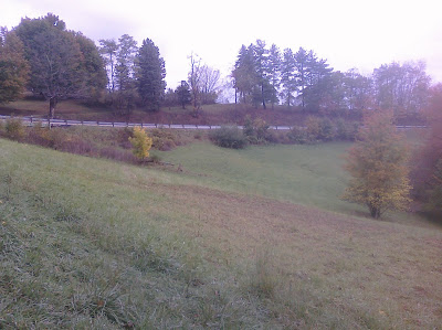

Yea, there are a lot of factors to consider. I tend to prefer simpler over complicated as well so I am sure that will factor in. I guess I am pretty nervous about tipping over.
Here are some shots of the land in question as well:

"My property is bowl shaped so traversal is going to be hard to avoid."
Do your best to prepare ahead of time and don't take unnecessary risks. We had a family friend killed in a hillside rollover many years ago, a lesson that has never been forgotten. Sadly, that is all too common. Thanks for the pictures. Beautiful property. Tractors and hillsides like you have in WV don't get along very well, so stay safe!
