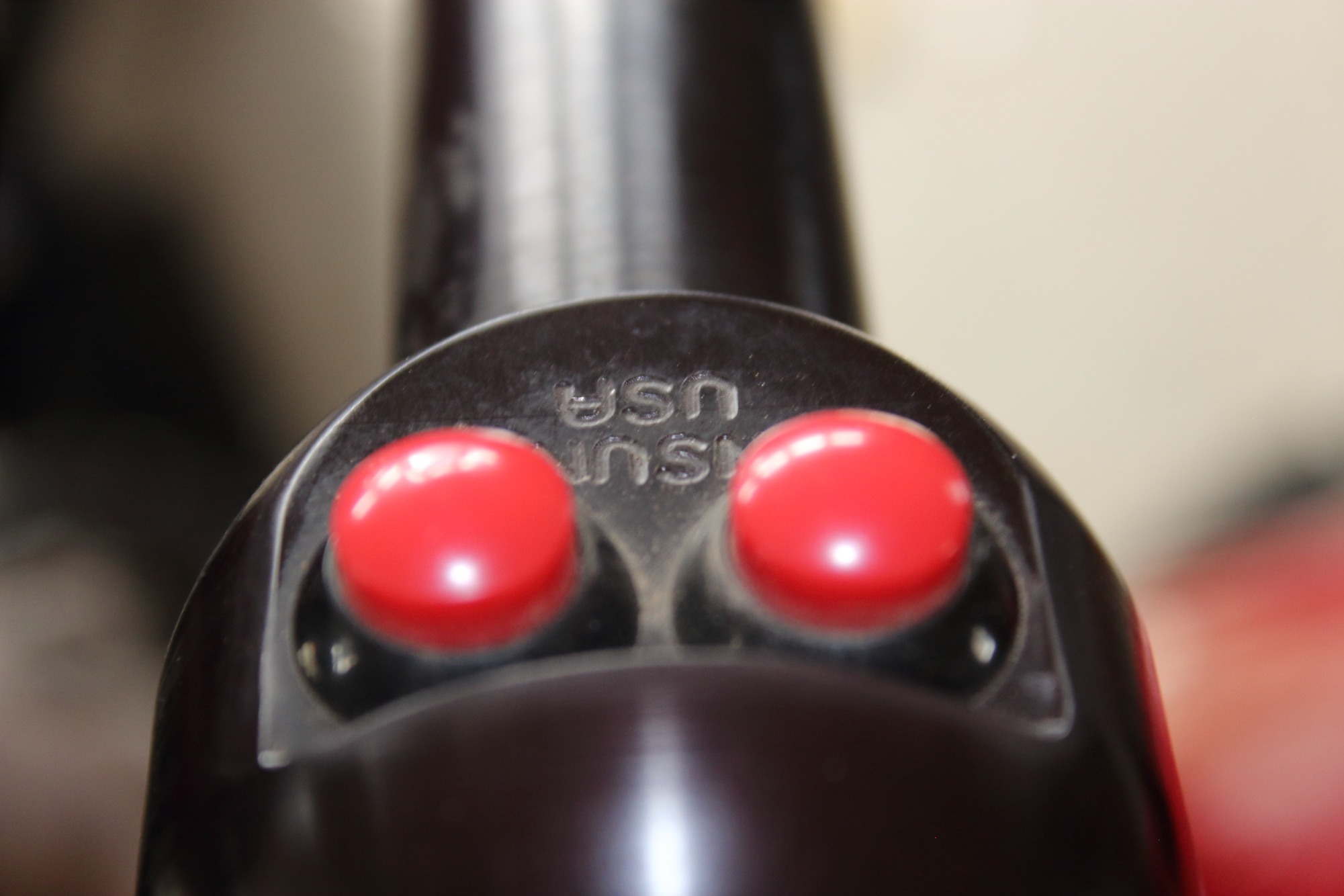

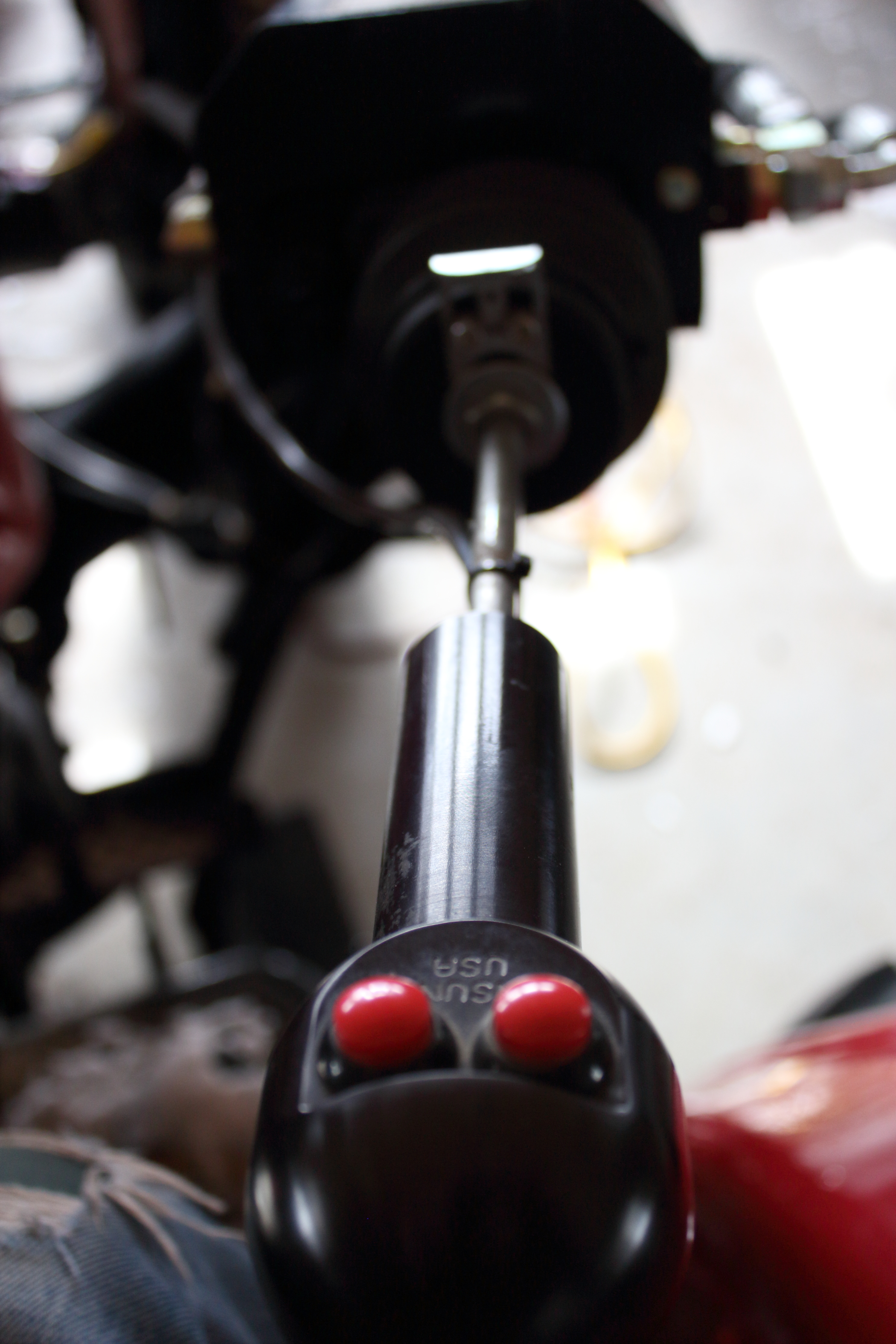

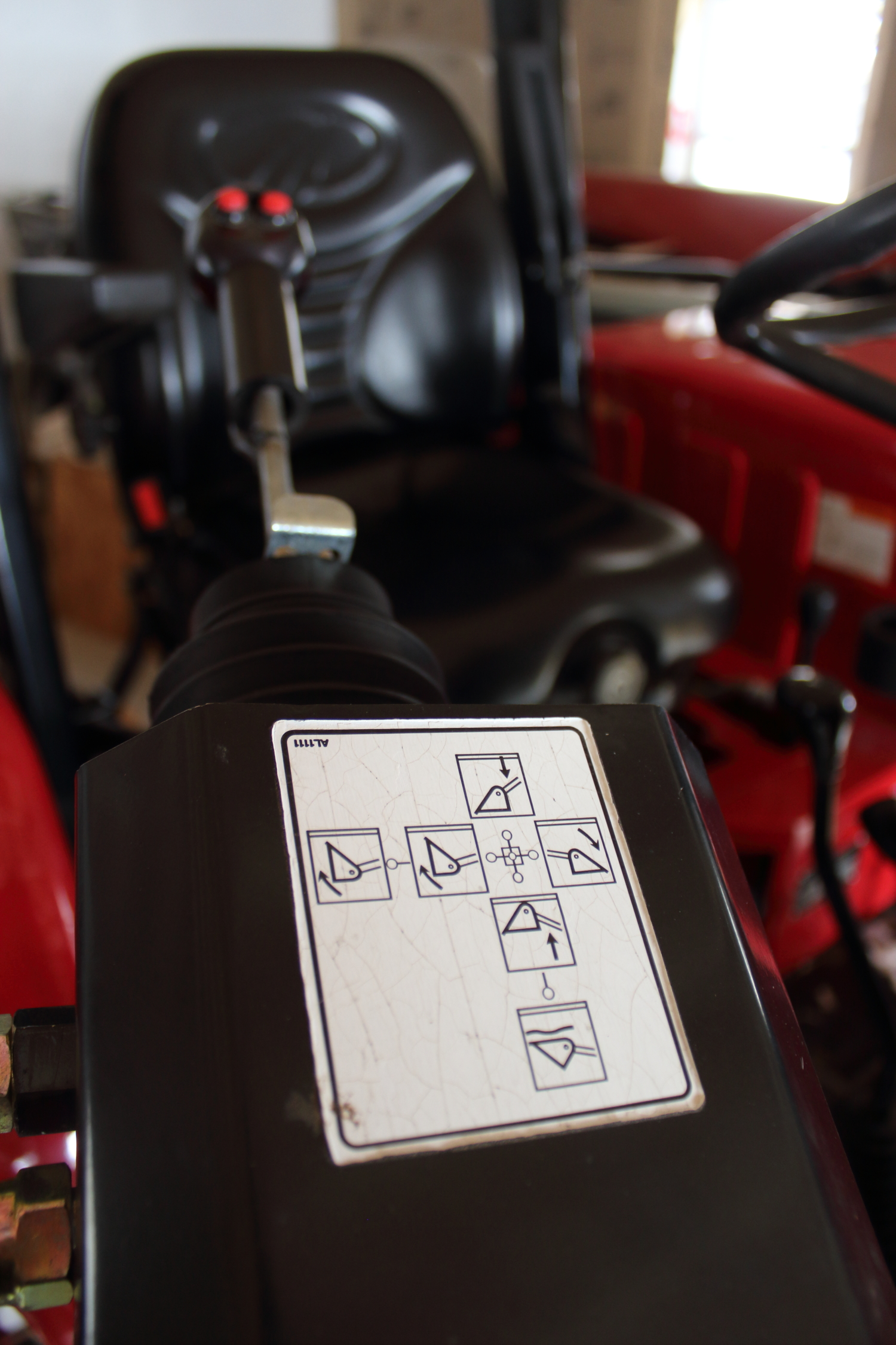

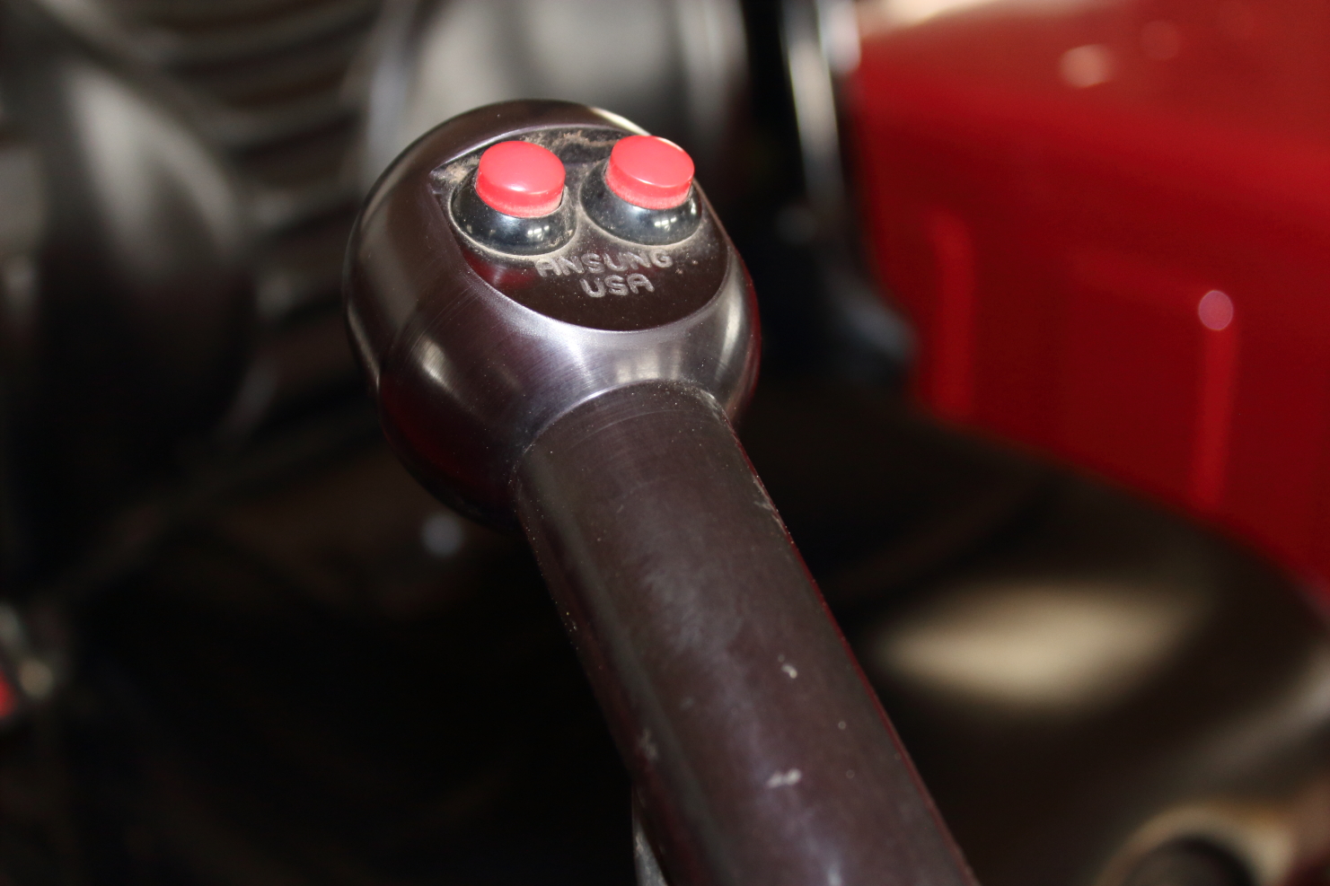

We had a true third function kit installed for use with our plow, I'm not sure on the price but it wasn't $3000.00.

/ need advice on grapple and 3rd function valve #7
Two styles of dealer rip offs! The $900 third function is probably the Mahindra diverter valve that uses the bucket curl function and diverts that for the grapple.
The second, $3000 version, is probably a true 3rd function that would allow both curl and grapple at the same time.
The valve and switch are easy to source and cost a few hundred bucks. The brackets, plumbing and hoses are what chew up time. If you have time and an understanding of the hydraulics you are probably $600-$800 in parts.
The kit mentioned above is a true third function.
/ need advice on grapple and 3rd function valve #8
With the WR Long 3rd function kit if you feather your bucket curl or loader lift then you can also operate the 3rd function at the same time. Since it is installed in the power beyond port of the loader valve it is taking the flow AFTER that valve so the 3rd function is just taking whatever flow you are not already using in the other functions.
As far as price, my dealer installed the WR Long 3rd function for about $1500 and it seemed like that was the going rate around here when I was shopping for the tractor. If you are somewhat handy you can buy the kit from EA for under $850 and install it yourself. Had I known how easy it is to install that is what I would have done. The kit comes with everything you need including hoses to connect it for the specific tractor.
