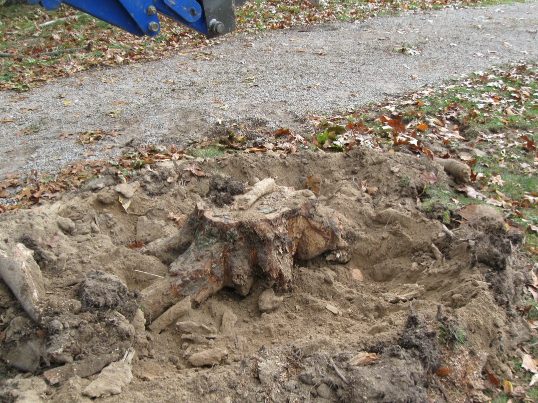

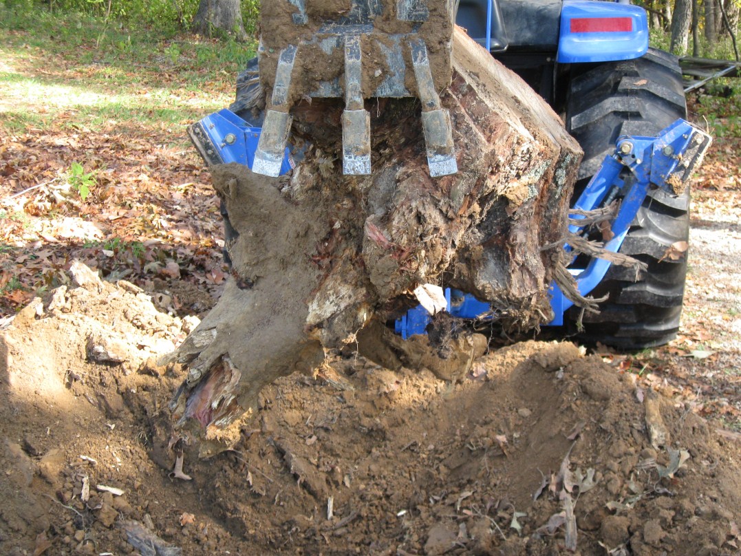

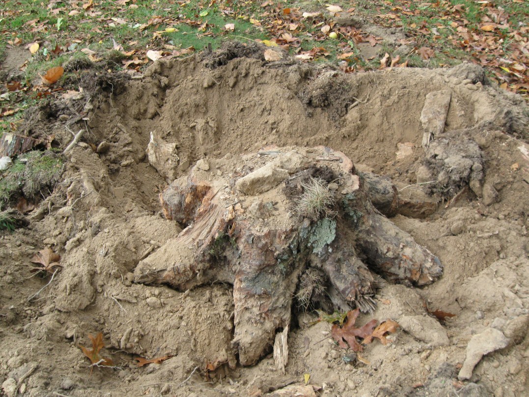

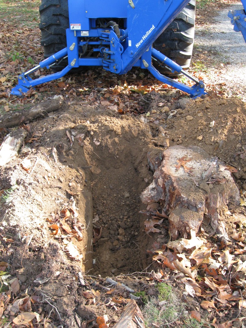

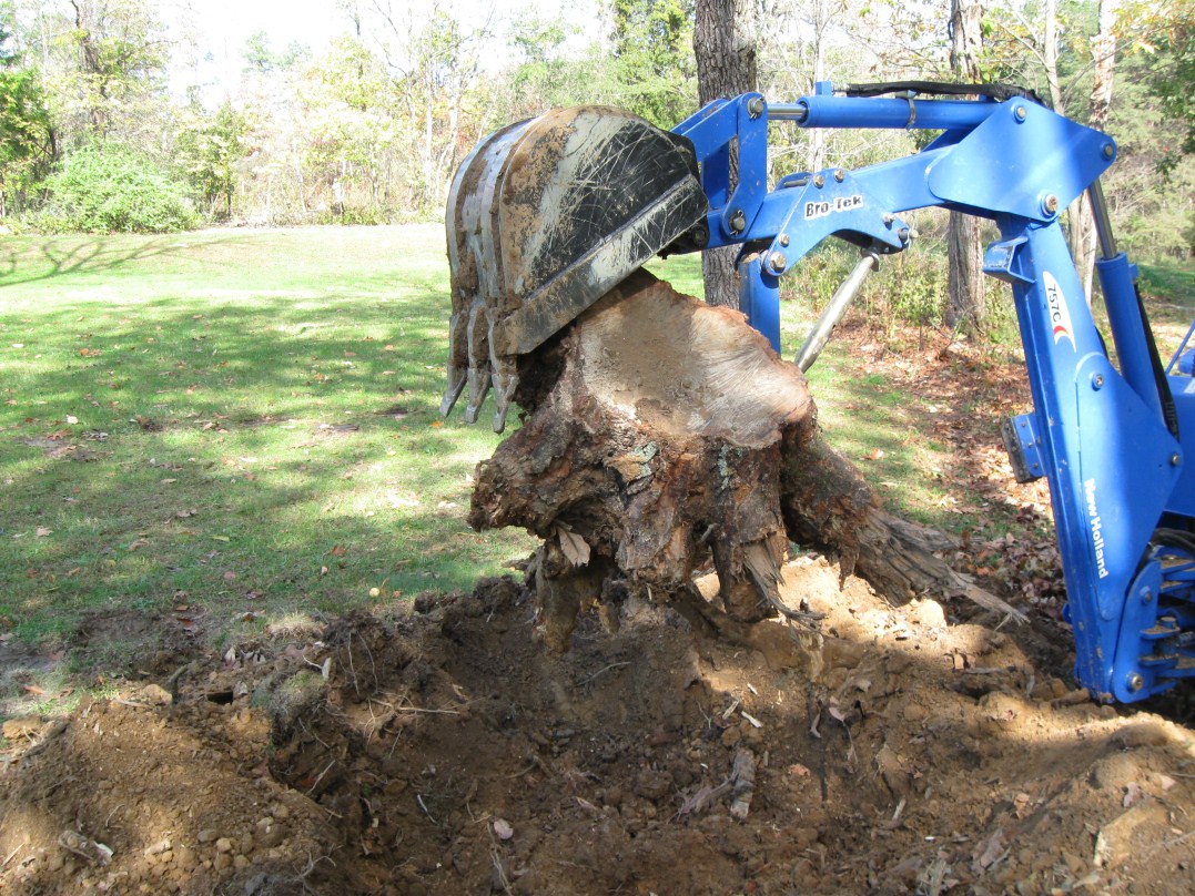

Success! We have had a lot of (needed) rain so haven't been able to get back to the stump. It had really softened up the ground (clay) which I'm sure was a big help. I dug a trench as suggested along one side and I could get more movement. Rather than try pulling it with a chain and my old jeep, I dug a trench on the opposite side.
I spent some time going to each side and hooked the bucket under each corner and it would move a little more. I probably spent 45 minutes digging more and using the curl to keep it moving. Finally it just continued moving and was free. I picked it up with the thump and hauled it to the burn pile.
I did create a BIG hole that I am now trying to make look nice. But the stump is gone! Glad it wasn't a big one.
Thanks for all the advice.

Next time leave about 3 or 4 feet of the stump to act as a lever. Break as many of the roots as you can with the backhoe. Then push keep pushing it over from different directions with the loader until it breaks. Do not ram the stump, just apply a steady pressure.
I cringe when I see folks cutting a stump off at ground level when I know they want it removed. That 4-5' of stump sticking up is your friend, an awsome lever it is, the dirt now becomest the fulcrum, it can cut removal time by 2/3rd... Before my tractor I pulled stumps w/ my FJ Cruiser or Jeep and Winch and an AXE. POP, out she comes...THEN Cut the stump off the rootball.

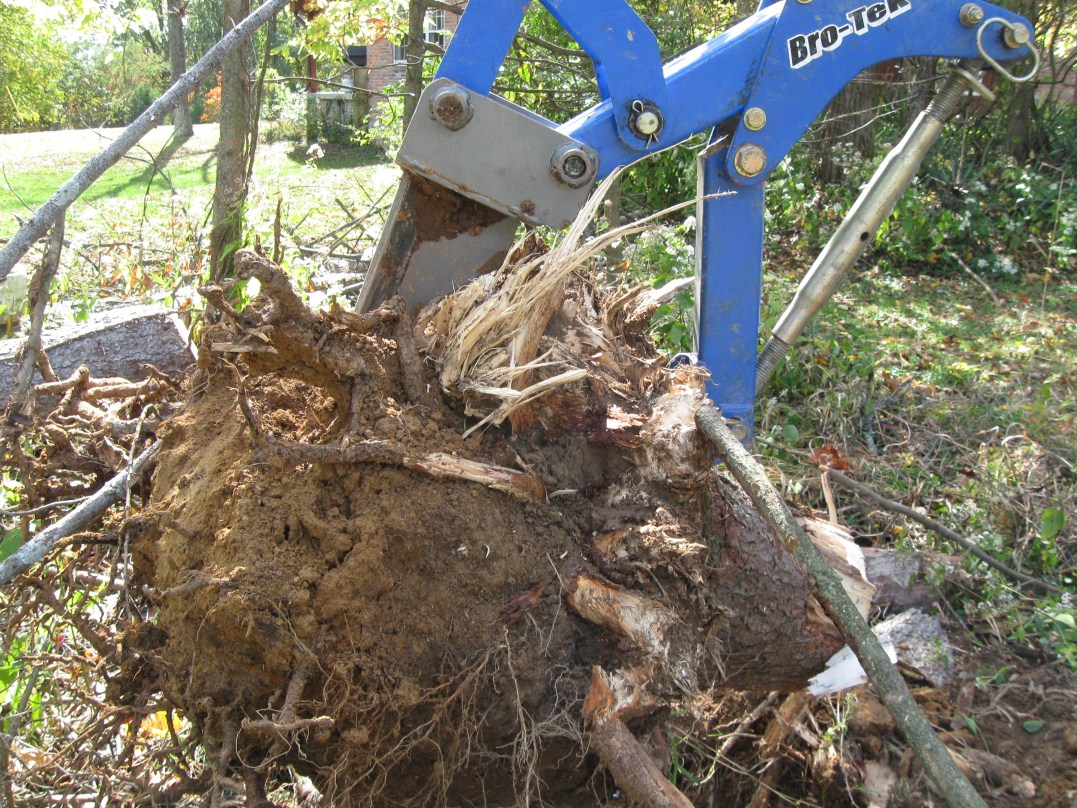

I had the hickory and 6 other dead-standing trees taken down by a tree service - just dropped to the ground. The hickory and Chinese elm were cut off at the ground for some reason while they left stumps on the spruce. I suspect they figured I'd want them back to grind the two at ground level. I took one of the spruce stumps (3' or so) out without much trouble.
I have had the thumb about as long as I've had the tractor (05) and find it to be very handy. The spruce were taken down in sections (they were in a group of trees) and the thumb is great for reaching in and picking them up to saw or move whole. The thumb is easy enough to put in position and then store, so it gets used a lot.

Every time I have had a deep tap root, the only solution was manually digging with a bar and the aid of the bucket until you can literally either chop with an axe the main root or the bucket power finally snaps it. It is a job and the only to make it easier is power and some patience.
I have had to dig 5 ft deep around the entire root to get to the main root once it starts to give way and move..When that happens you are getting close to freeing it...either way they are hard!

I agree with you...I learned that the hard way, but what a difference 4-5 ft of stump makes or MORE....leverage...It is all physics. :thumbsup:
Barry next time, leave as much trunk as you can sticking up so you can put a block and tackle or chain around it to use it as a lever and the job will be 1/2 the time. Still got to dig, but mostly to just get it out of the ground, but the tap root will snap and free the rest.

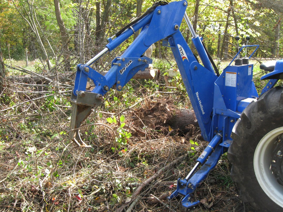

I purchased the ripper to use on my quest to eradicate autumn olive from the farm. For the small olive trees it works much faster than the bucket and leaves much less of a hole/mess. It did a great job on the hickory roots and was all I used on the spruce. I probably have 200+ olive trees to remove so I justified it (based upon recommendations here) based on that task.
The bucket change out on my BH is normally a five minute deal; drive out the two pins and that is it. When I went to put the bucket back on this time I had a hard time getting the front pin aligned. I'm making a tapered pin out of 1" bar stock to take care of that problem.
