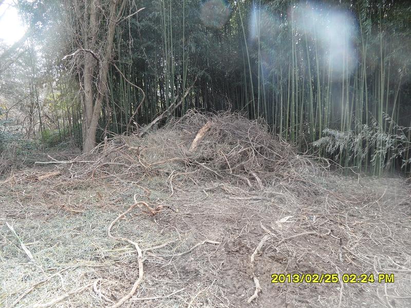

I'm retired. Because of various aches and pains plus the weather I can rarely plan on working hard 3 days straight to maximize a weekend rental of equipment. For instance I had a little "stuff" to chip, couldn't burn it, county wanted a few hundred to haul it and I needed mulch.
attachment.php
attachment.php
Chipper rental looked like it would be about $700 for a week.
Bought an 8" Jinma chipper for about $1700, put about 30 hours on it (had to grease it 3 times) over the course of two months, then hauled it down to Mississippi and I've only used it for about another 5 hours. I think the chipper has paid for itself. And now I've an 8" chipper just setting there waiting to be used :)

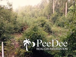

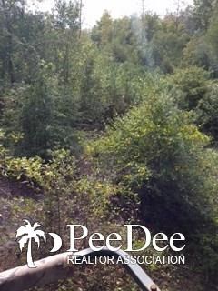

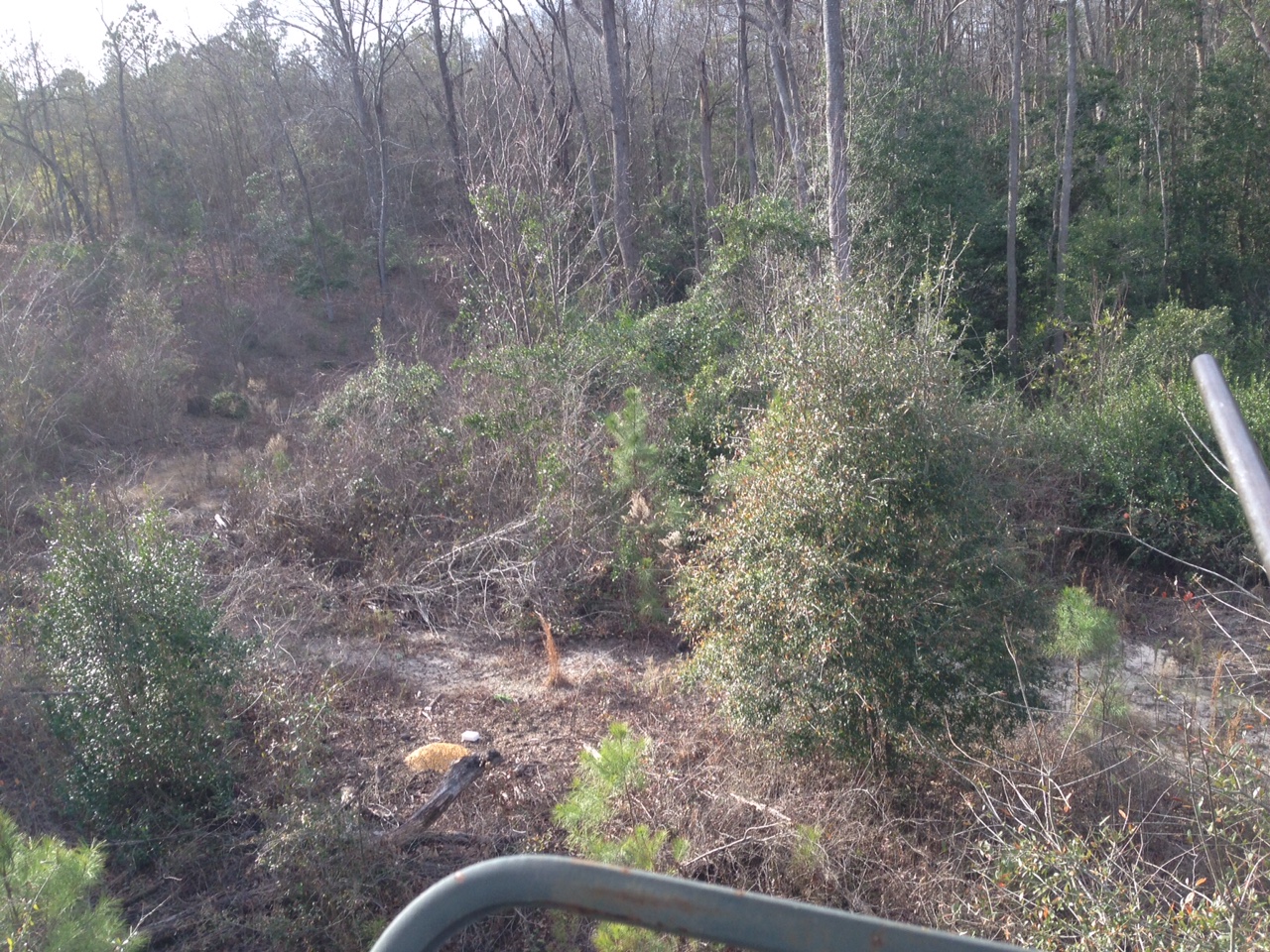

How would you go about clearing it, and what tools/ tractors would you suggest? Note: I don't own any tractors, other than a riding lawn mower, so I'll be renting the equipment.
Thanks. View attachment 452717View attachment 452718View attachment 452719
You don't have a tractor!!! Almost every landowner needs a tractor. I think you will need to have a tractor with at least a bush hog at some point even with a pecan orchard. A small 25-30 HP tractor with FEL would be sufficient. Used would be OK too. You will always be hauling something like fertilizer, dirt etc so an FEL is a great investment and most CUT's come with them. Grass and weed/tree sprouts etc will have to be mowed regularly unless you want it to go back to nature like it is now. I find that a tractor earns its keep on almost all land uses. Mine may set for months but are available when a job needs doing rather than waiting for days or weeks for a contractor to be available. I know lots of my tractor chores would have just went undone if I had to rent the tool or contract the work plus I like to do the small chores that take 4 hours or so like mowing. It keeps the blood flowing and joint loosened at least a bit.

I went back to your original post and looked at the scrub brush and excepting any tall stumps that might damage tractor and bush hog, I don't see anything that cant be bush hogged down. I have cut 4" sweetgum and pine trees with a 45HP tractor and lightweight bush hog by just riding them over with the FEL and easing into them with the bush hog. It pretty much shreds the limbs but not the trunk past about 2-3" in diameter. The shredded trunk can be left to rot or gathered up with the FEL (easier if you put a tooth bar on the FEL) to a burn pile.
You will eventually get tired of renting tractors and want your own so start shopping now. If you rent for this job, be sure to get damage waiver insurance , just in case that invisible stump jumps in front of the tractor and rips off an oil pan or something.
