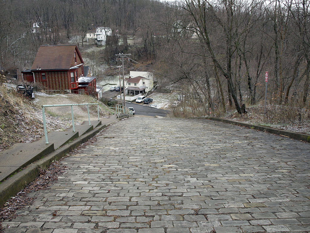

Like mentioned before I have no problem working with the tractor. It just annoys me when going up hills I mean these hills are very steep and long. Unless someone is sitting in my seat at the time of going up hill then they would see what I mean. I don't think it is the tractor, the problem is the hills. I don't go down off my property very often but when I do it just irritates me of how slow it is at climbing. I have lots of patience just not use to HST power compared to gear drive.

I will give you an idea of how high the hills are. One hill is 1 mile long and I am going from flat ground to 1300 feet to the top. 2nd hill is 1/4 of a mile going from flat to about 500 feet and there are a few not so high in between. Now if you can find a hill around your area that is close to the same height and distance then you tell me how your machine performs as I am curious.
I have some very steep hills here on the roads in Branson, and my (heavy) tractor with HST will not climb them in High range very well. I have to go to Med range, and even them back off of the HST pedal to keep the RPM's up on the engine. I don't road the tractor very often, and on more gentle slopes or flatter ground, the tractor fully loaded will run fine in High range and the speeds shown in the manual. But when climbing steep hills, High range is not the way to attack them.

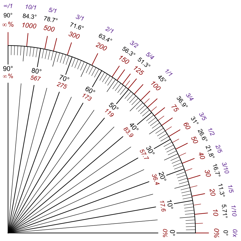

1300 feet up in 1 mile is a 4:1 incline. For every 4' forward you are going 1' up.
A 1:1 slope is 45 degrees, and 100% grade.
A 2:1 slope is 22.5 degrees, and a 50% grade.
A 4:1 slope is 11.25 degrees, and a 25% grade.
That is a very steep angle and grade to try to go up in high range and hold speed.
One thing I didn't see you write was what you are doing with the throttle. Several people asked if you have it at full throttle or not, but I did not see the answer.
1:1 slope = 100% grade = 45 degrees
1:2 slope = 50% grade = 26.5 degrees (arctan(0.5))
1:4 slope = 25% grade = 14 degrees (arctan(0.25))
Grade = rise/run
Angle = arctan(grade)

I should have consulted the old math there, eh? hahahaha
Or used the convenient chart.
That's why I don't like using grade for describing an angle.
