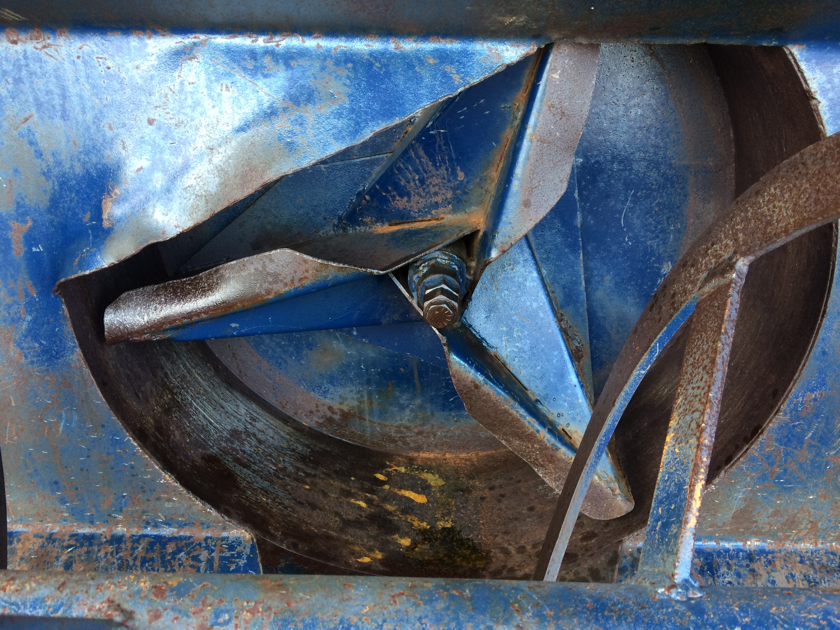

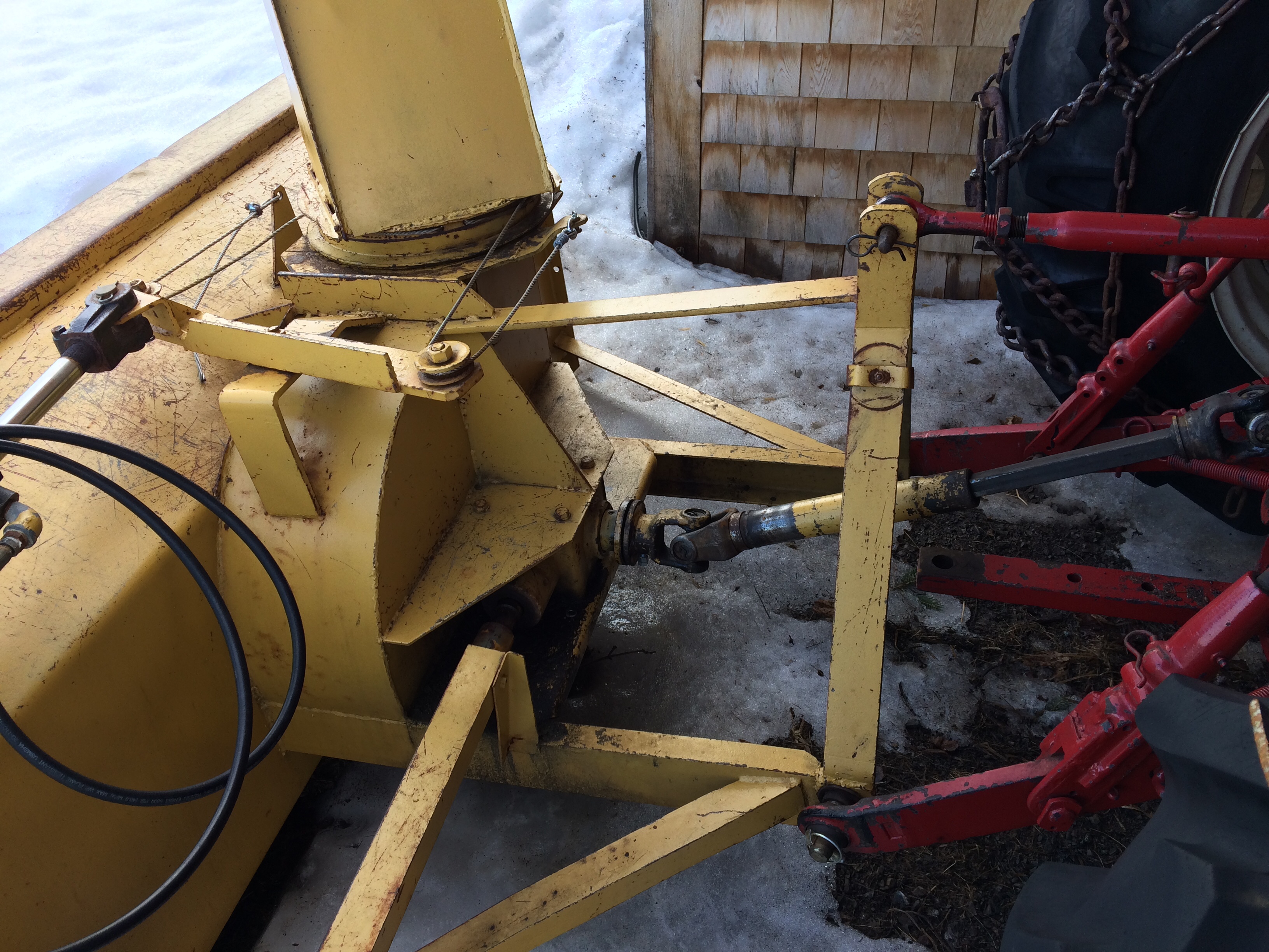

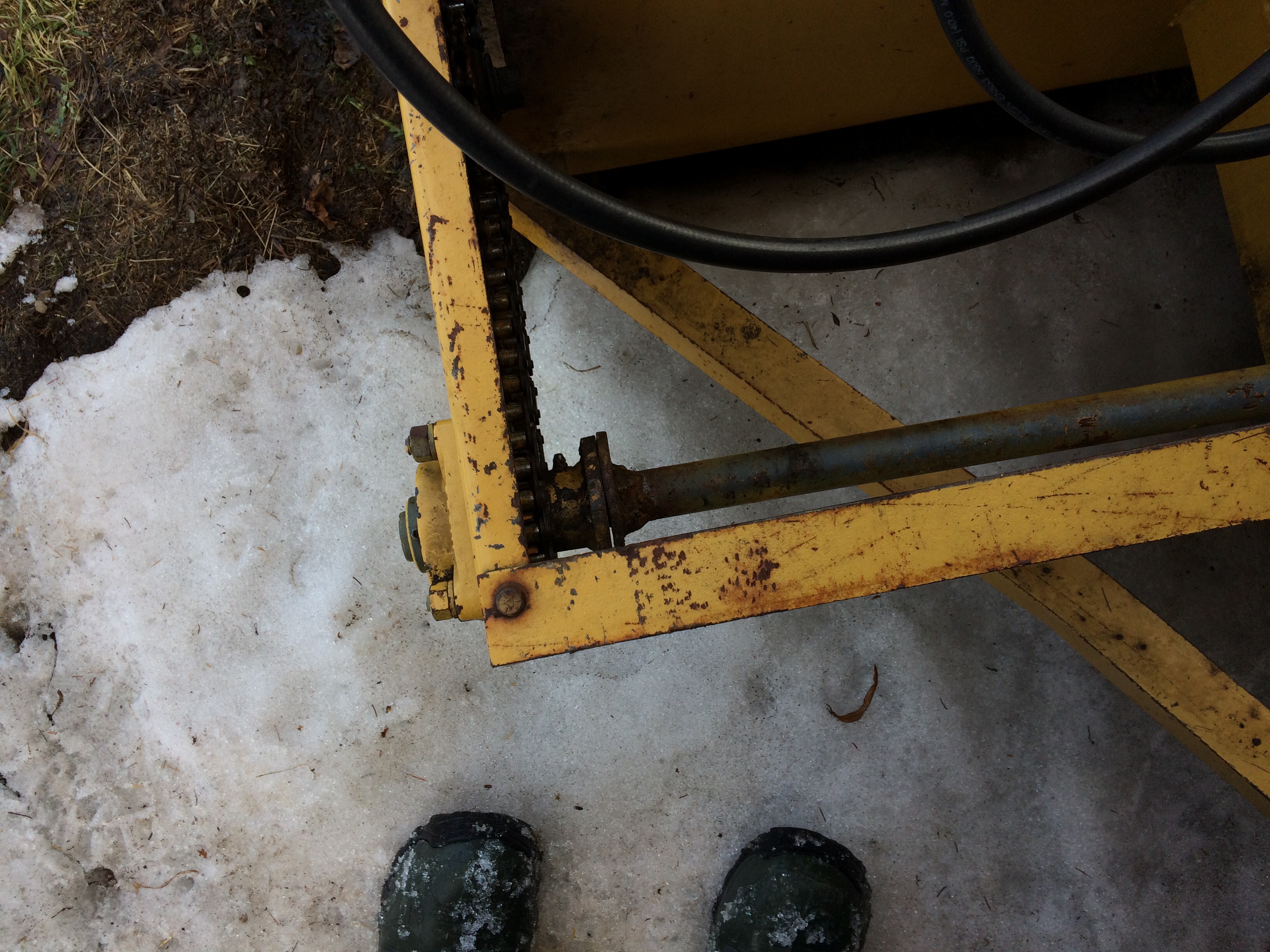

The snowblower photos in post #2 do not look like a Pronovost to me. I would say that blower is probably an Allied or perhaps a Ber-Vac.
I cannot identify the second blue and yellow blower but it looks like a little less blower the the one in post #2.
It looks to me like both have been used pretty hard and are fairly beat up but might be alright for a bit if repaired. Check anything that turns for bends and wobble, and the gearbox very carefully for any sign of a spun bearing or other problem.
One other note about the first blower is in my experience with the high auger and steep cutting edge that type is very hard to push.
   / Need advice on older Pronovost snow blower #16
I'm no help on posting vids, but I wanted to chime in on which blower to buy. I think the better bet is the one with curved auger. A gentle bow like that is an easy fix. Unbolt the two end bearings and the auger falls right out. Support the ends on a couple blocks and push down on the high point - push on the pipe, not the flights. It will only need a couple hundred pounds to start bending it down. Go a bit past so it springs back to straight. Check it with a string (see this thread). Anything within 1/4" is good enough. The fan blades can be straightened in place with a pipe wrench or something similar.
I've straightened mine when it got bent. I set it up in my garage door opening and used a hydraulic jack with a post up to the door header. Worked perfectly. Snowblowers are simple machines - no drama.
