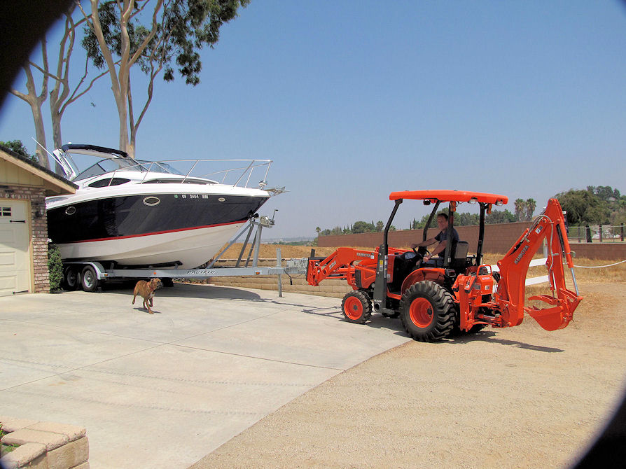

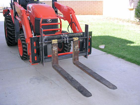

I mounted 42in, 1200lb capacity forks on a QA frame. Works great. Move around a lot of 1/2" steel plate, 500-700lbs at a time. Welded up a hitch receiver on the same QA frame so I can use the B26 to move my boat around.
