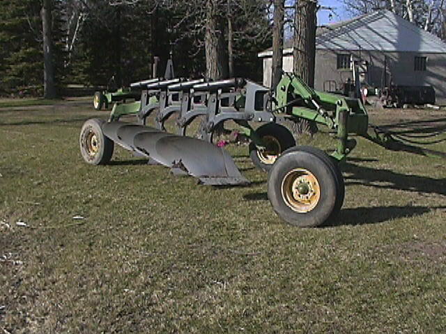

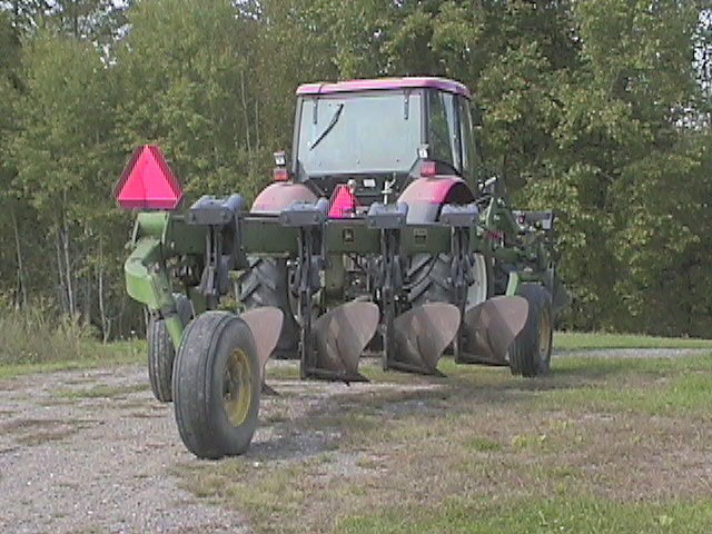

BarryinMN--What kind of plow is that in your photo? I've never seen any shares like that!:confused:
   / Need advice on Plow for 75hp Tractor #30
Here is more pix's. Pretty standard JD plow. It has front & rear timed hyd cylinders to dive & surface like a submarine. I have spring loaded coulters for it but don't need them.
