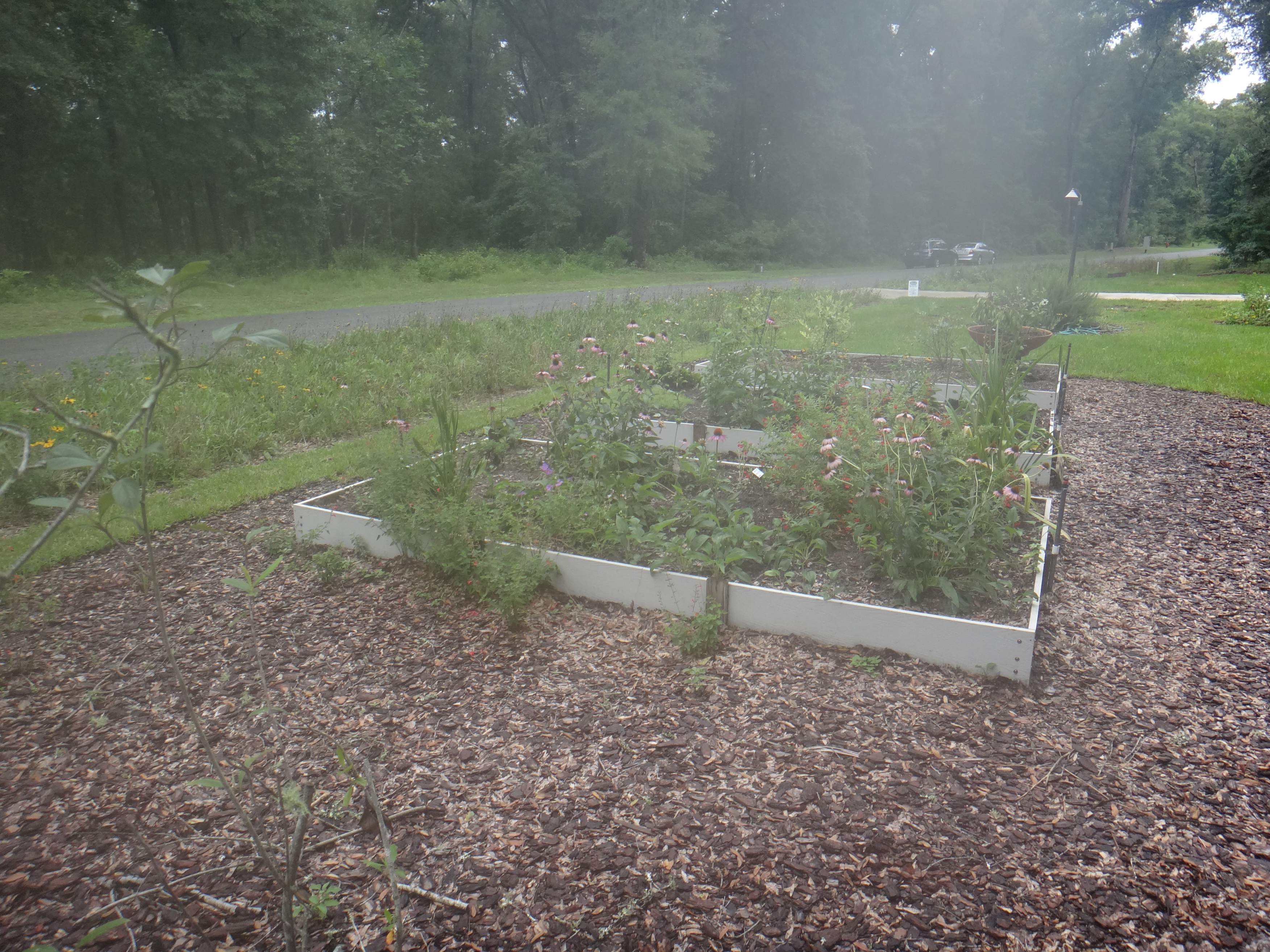

I made my raised beds out of 1" thick concrete plank, often called Hardeeboard, although mine was a different brand. Corners secured with Simpson Strong-Ties. They bowed out a bit when I filled them so I have a reinforcing stake at 6' on the long sides.
My beds are 6' X 12' X 12".
Concrete plank has worked well for three years. You have to moderately careful not to put a lot of weight/force on the exposed top edge.
