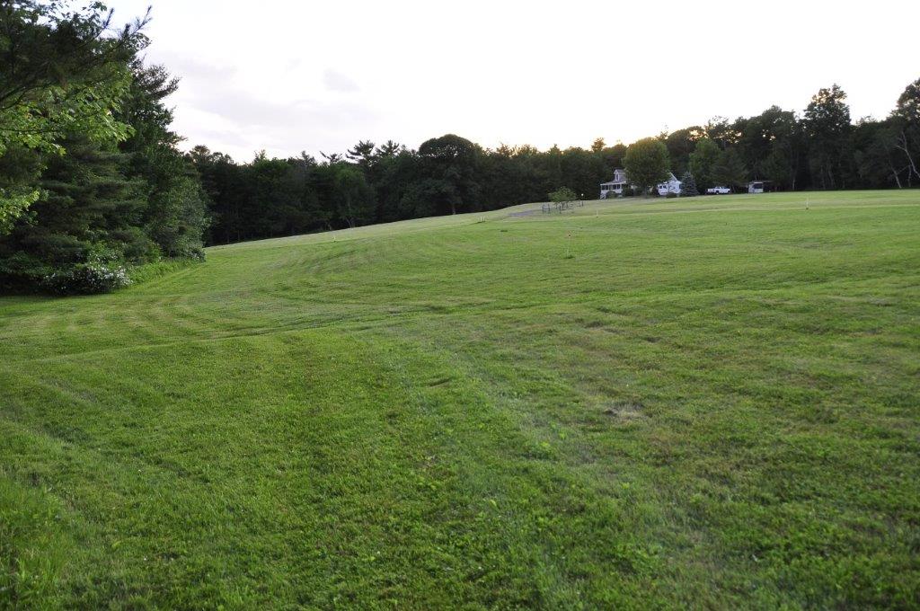

I have a 2 acre field that I mow weekly with my lawn tractor. It is on the bumpy side, and shakes me and my lawn mower quite a bit while mowing. I am looking at buying a zero turn mower with a top speed of 7-8 mph, but there is no way I can mow at that speed due to the bumps and ruts. So I want to smooth the field out so I can mow as close to full speed as possible.
The field has no trees or obstructions in it, has some rolling hills which I want to keep. The big catch is my septic line runs out to the far side of the field, and then branches off into the leach field. So the usual suggestion of bringing in a large grader or bulldozer or tractor / plow / harrow / disc won't work.
My plan was to use my tractor with 5' rototiller and till the field many times over a period of several weeks, and then rent a skid steer with a hydraulic rock rake to remove all of the rocks unearthed by the tiller. Then I would plant new grass, cover with hay and water as best as I can, hopefully mother nature will assist with the watering.
Will this get me the smooth yard I want? I have access to a york rake, and a drag harrow as well, not sure if these should be part of the process. I am going to call a couple of landscape companies to get estimates as well, what would be a reasonable price to pay to smooth out 2 acres? What would a landscape company use to do the job?

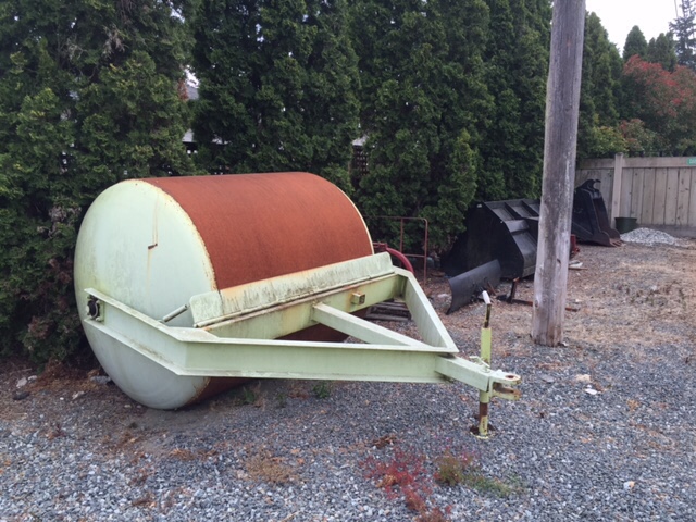

Here' a pic of my roller. Approximately 3 tons total rolling weight when full of water. ABOUT 8 pounds per square inch.
Terry

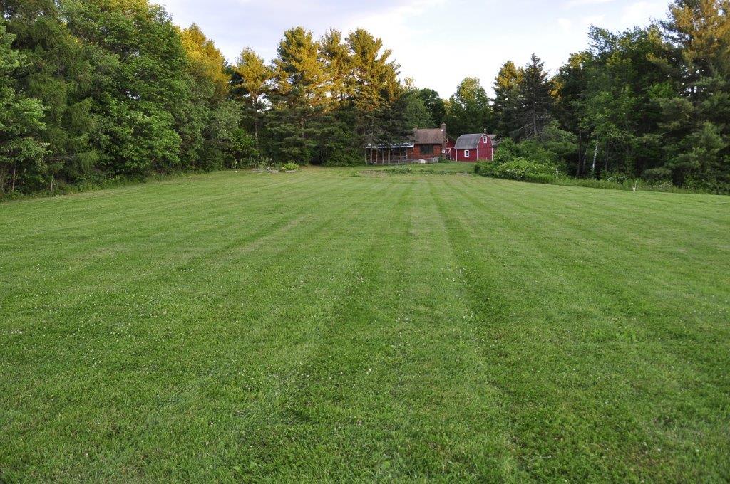

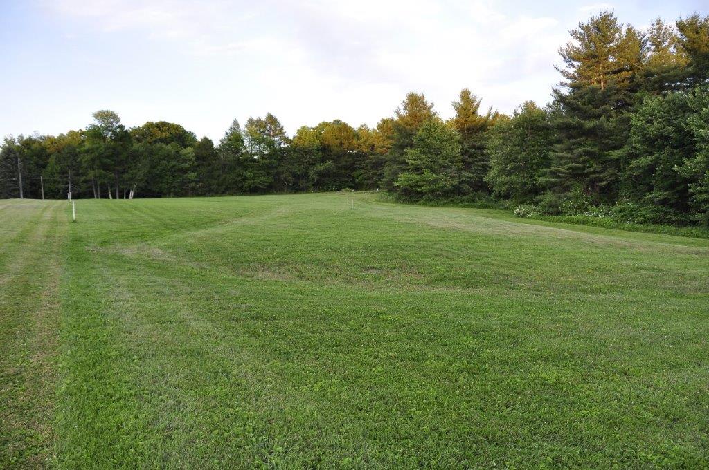

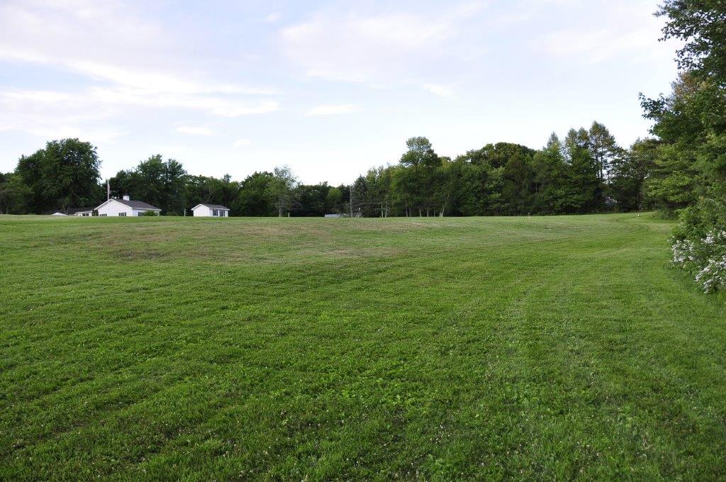

Here are some pics of the field.

Wellllll - the first thing I noticed was your field is sure a LOT smoother than the one I mow. And yes, when mowing my field, it does reset my kidneys. Other than adding sand to the "ruts" - I think Piston's suggestion - post #8 - using a Harley rake is about the best. Otherwise, you are going to end up with row upon row of cut sod - in great & wondrous clumps.
The experience I have with my Land Pride LPGS indicates that if you could penetrate the sod - its not going to break it up. You will end up with gnarly clumps of sod all over the field.
You need an implement that has the ability to slice the high areas and grind this material fine enough to deposit it into the ruts. My limited experience in this area says a Harley rake is about the only thing that will do this.
This assumes you do not want to start all over again. If you do, then a large rototiller - multiple passes in all directions until the sod is broken up - then some sort of leveling implement(LPGS) - finally reseeding and rolling. Or a large Harley rake.
