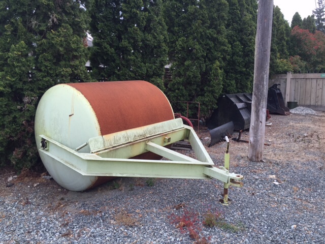

A 'reverse till' rototiller will bury the sod clumps effectively.
A big roller may get it level initially but as the clumps decompose, you will have your original problem.
Here' a pic of my roller. Approximately 3 tons total rolling weight when full of water. ABOUT 8 pounds per square inch.
Terry
What size tractor do you use to pull that beast of a roller? Realistically, how heavy of a roller could my 28hp tractor pull? The largest "lawn roller" I can find is 60x24 and weighs 1100lbs full of water. I am guessing I want more weight than that. If I were to fill that roller with cement, it would weigh 2000 lbs. Is that heavy enough, and would my tractor have an issue towing it? I know my 3 point hitch can pick it up no problem, rated for 2600 lbs. Does anyone sell a larger diameter roller than 24"?

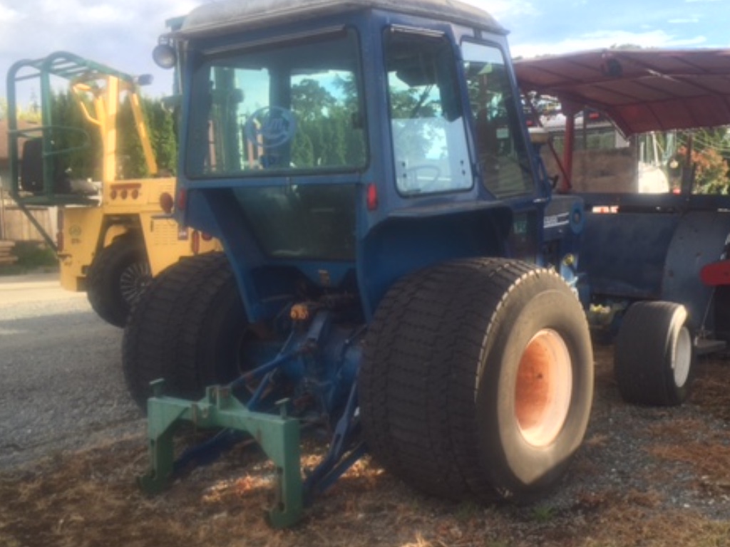

I've since sold my 80HP New Holland (2wd) that used to pull that roller. It had larger 44"wide floatations tires on the rear.
Terry
