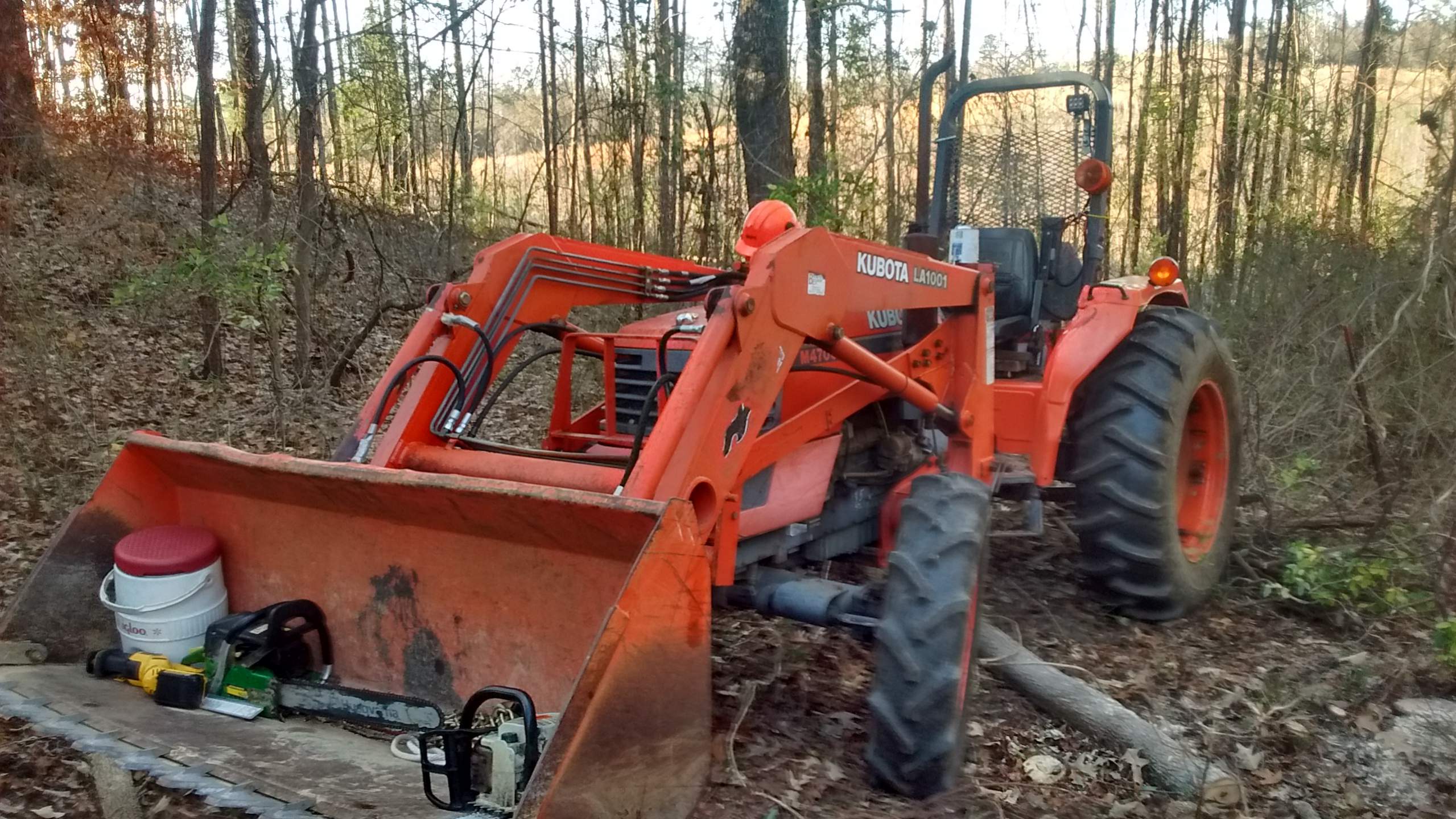

I've only got about 75 acres next to my house, about 1/3 was cleared 30 or so years ago, planted in pine, then harvested 2 years ago. About 10 acres around the house looks to be going on 50 yrs old plus. I am also try to "selectively clear" various areas. Some of it is is pine and oak over 2 foot DBH, most is 10" to 20" gum and pine. I'm making gradual "paths" through it.
But the OP seemed against clear cut. Careful selective clearing taking into account soil conditions and weather is easy and with moderate sized equipment can be done without damage to the surrounding trees.
attachment.php
I don't operate when it's wet, I'm careful to avoid getting the tracks near trees I want to keep.
<snip>
4) Have your stumps ground. You can rent a grinder yourself if you must. The pro has a better machine and can possibly do it for the same money. Much better than digging, burning, filling holes. As I said, I had nearly 500 done from 8" to 48". I never had a problem with holes forming as the stump under the ground rotted. (people warned me I would) Yes, they will rot eventually. Meanwhile you are hitting them with a mower or mowing around them. weeds/trees growing next to them...<snip>
And I've never had problems with "rot in place". If a tree falls in the woods what happens to the stump?
If you want pretty you have to pay for it.
I also like to cut some of my stumps to make "seats" or table height.
