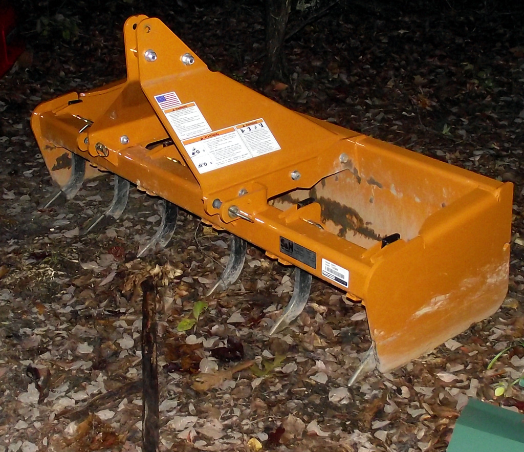

Used the box blade with the scarifiers (shanks, rippers) in the middle position to clean up a rutted, rocky forest trail. Good couple of hours work. When I finished and dropped off the box blade, I noticed I'm now missing 4 (out of 6) teeth on the blade.

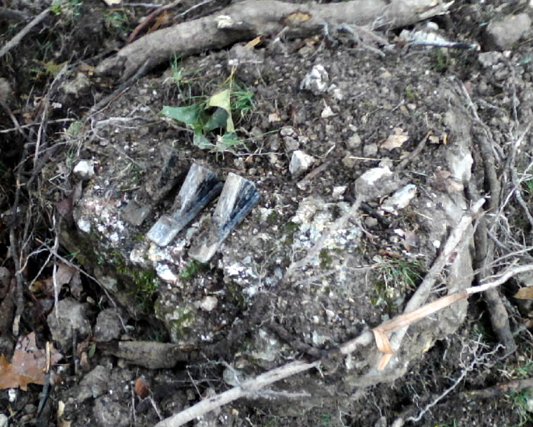

Today I went out to find them. Found 3 where I had pulled up a rock about the size of carry-on luggage.
The scenario is that I was chugging along in low and the tractor was stopped by the rock. Pull up blade, back up, drop blade, ease into rock, lift blade. Repeat until. . . Rock turned over and flipped out of its hole. Chug past rock, lower blade, and backed the rock off the trail. That was in the first few hundred feet and I went on with the rest of the trail.
So, obviously, that scenario pulls teeth off this box blade. Is that normal? Just something you don't do with a box blade?
Searched through some posts about putting the teeth back on. I have the dimples in the shank which sounds typical from the posts. However, I don't own a torch or a press and that seems to be the two favored methods of installing teeth and adding the dimple.
Question: But I own a welder. Can I just weld them on? Will that hurt the surface hardening on the shanks and make them brittle?
Question: The teeth are not slipping back on the shanks as they are dimpled, too. Do I just go at it with a hammer to knock them back into position? Will a propane torch have enough heat to ease them back in?
I've probably done that 50+ times, and never lost a tooth. BUT
I didn't do this with the blade low. I raised it about 4-6 inches as I was afraid I would drag a tooth off.
Bruce
Huh. Hadn't thought of that. Don't back up your BB when on the ground. Good thought. Thanks.

I'd contact Woods. They should NOT just pull off like that... Even a small standard duty box blade should handle pulling rocks that size out of the ground with ease. A Woods should be of equal quality to others... I'd bet they had a bad batch of scarifiers make it through QC and will likely send you a new set for free that you don't need to mess with (they may even let you keep the old ones you could repair and keep as spares). Have your serial number handy and purchase information handy and call them; or better yet, email them copies of your purchase documentation, some pictures, and a link to this thread...

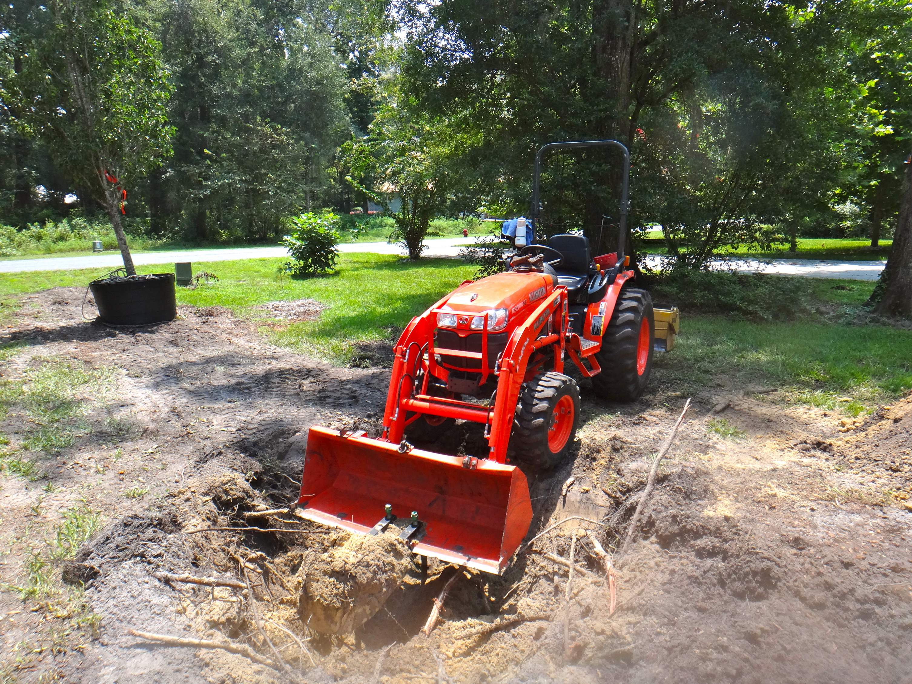

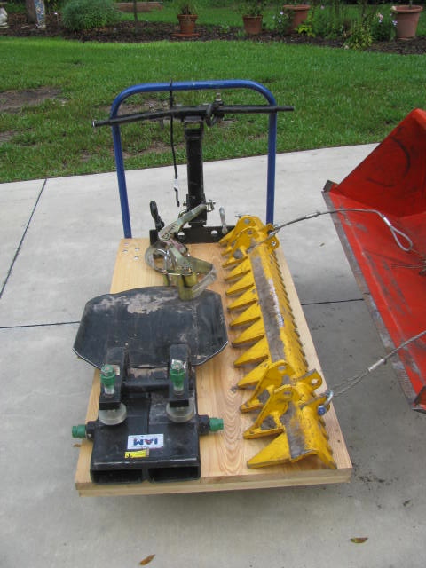

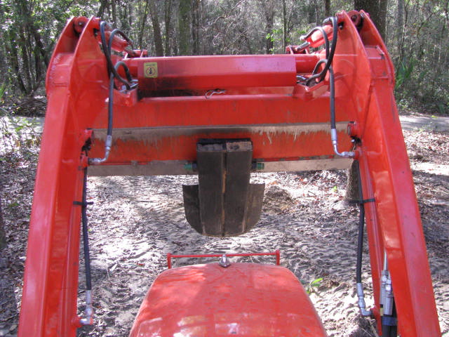

Consider acquiring a Bucket Spade for your FEL. It will dig out boulders in short order.
Versatile tool. Under $400. Not well known.
Excavation in Photo #4 is 54" deep. Rollover Box Blade mounted on three point hitch as ballast.

I wouldn't be afraid to try putting a small tack weld on left and right side of the tooth to shank joint. A tack wont heat a large area, and if it did it wouldn't be in a wear area. I wouldn't completely weld the tooth on, much easier to remove two rack welds then cut the whole dang thing off.
Or maybe not! On their online submission, I offered this:
I just bought a Woods BSM72 Box Blade. I used it for the first time to clean up a forest trail. After 2 hours of work I found that I'd lost 4 of 6 teeth off the scarifiers. Is this normal? Is there any warranty expectations when the product fails on first use? Please let me know what remedy is available​
There was a fast response! And in its entirety:
They are crimped on teeth and hooking tree roots will pull them off.

If you have a welder and a drill motor with some bits, I would drill out the dimple from the tooth with repeatedly larger bits till I got about a half inch hole on each side, beat it back on the scarifier shank till it is tight then plug weld the tooth to the shank completely filling the hole while making sure the weld metal tied into the shank side. That should hold it indefinitely. IF you should ever wear out a tooth, you just drill out the weld metal and slip it off.
I would go ahead and do the remaining shanks the same way while I was in the repair mode.
