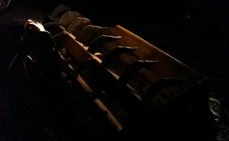

It lurks the deep, awaiting its prey...
This thing's comically beastly. I think i'll be able to pull it just fine as long as i keep an eye on how much material is in the box...it looks like it could hold a yard.

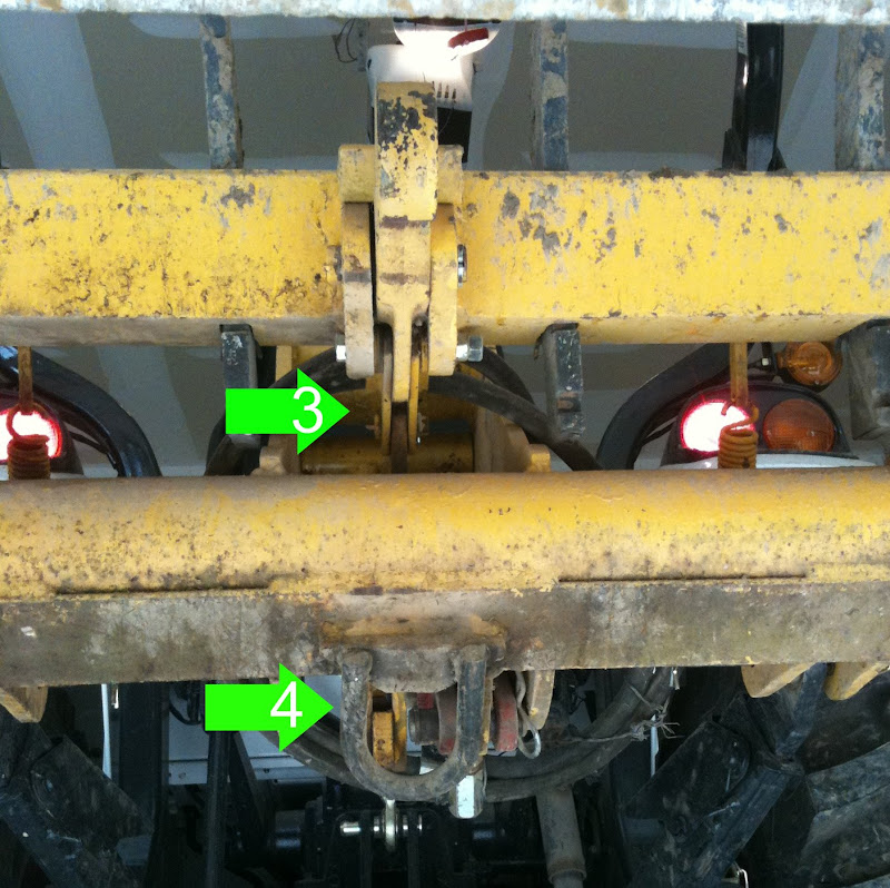

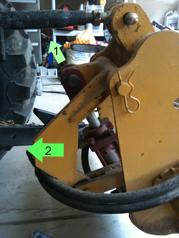

I don't understand it myself, actually, and I'm remoteless at the moment so i can't operate it at all (sans pulling the cylinder). There's a bit of a odd arrangement of pivots and springs involved, and my guess is that the springs hold the rack of tines in such a way as to keep the latch engaged. When the cylinder activates, it pushes aginst the springs to unlatch and then rotate the rack up out of the way...or something like that. It could be that the cylinder bears load in one direction and the latch in another, it's all too complicated for me to see.
1 is the main cylinder action, which pivots and causes 2 to pull front to back.
3 is the same as 2 above, and is some kind of buckling link arrangement that seems to cause both the rack to rotate and the latch to operate. I believe the horseshoe was added, as was the additional bit of steel in the center.

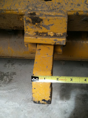

The latch is heavy duty.

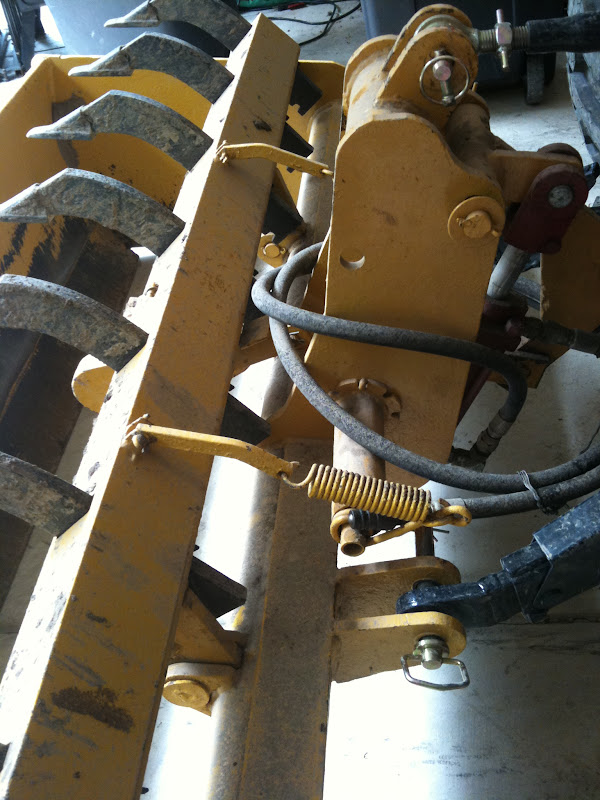

Here are the springs, i can't tell exactly what they do, maybe provide a biasing force to cause the latch to operate before or after the rack...dunno. Can't wait to see it work.

The latch when down needs to be there to keep the pressure off of the hydraulic cylinder and seals. The scarifiers have tremendous force on them as they are dragged through the ground so need to be locked when down.
When the "up" hydraulics are activated the first movement causes the latch to unlatch and the hydraulics can then lift (or rotate) the scarifier mounting bar. It would be nice if there was a latch for the up position. My hydraulic cylinder leaks down over time.
