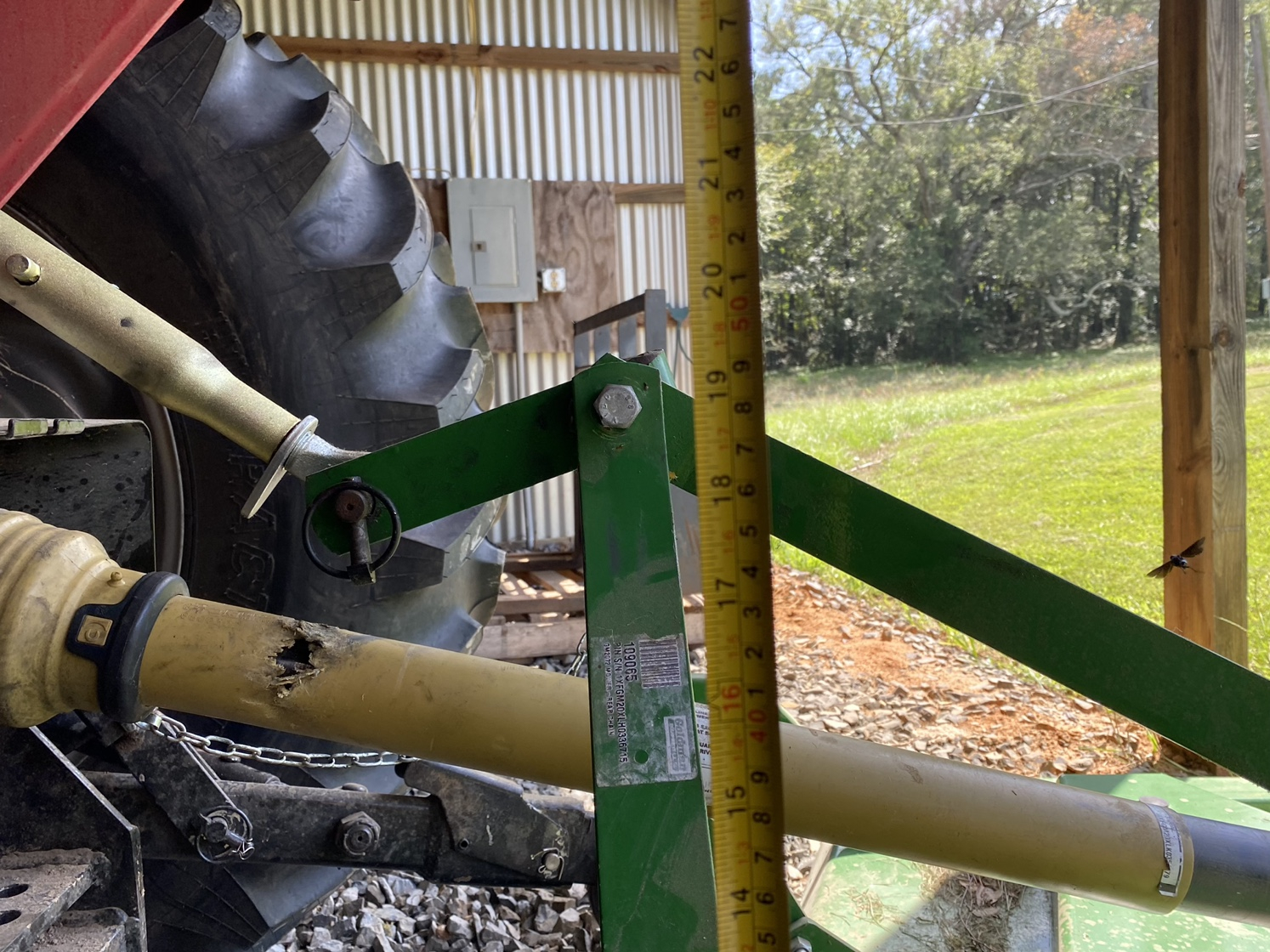

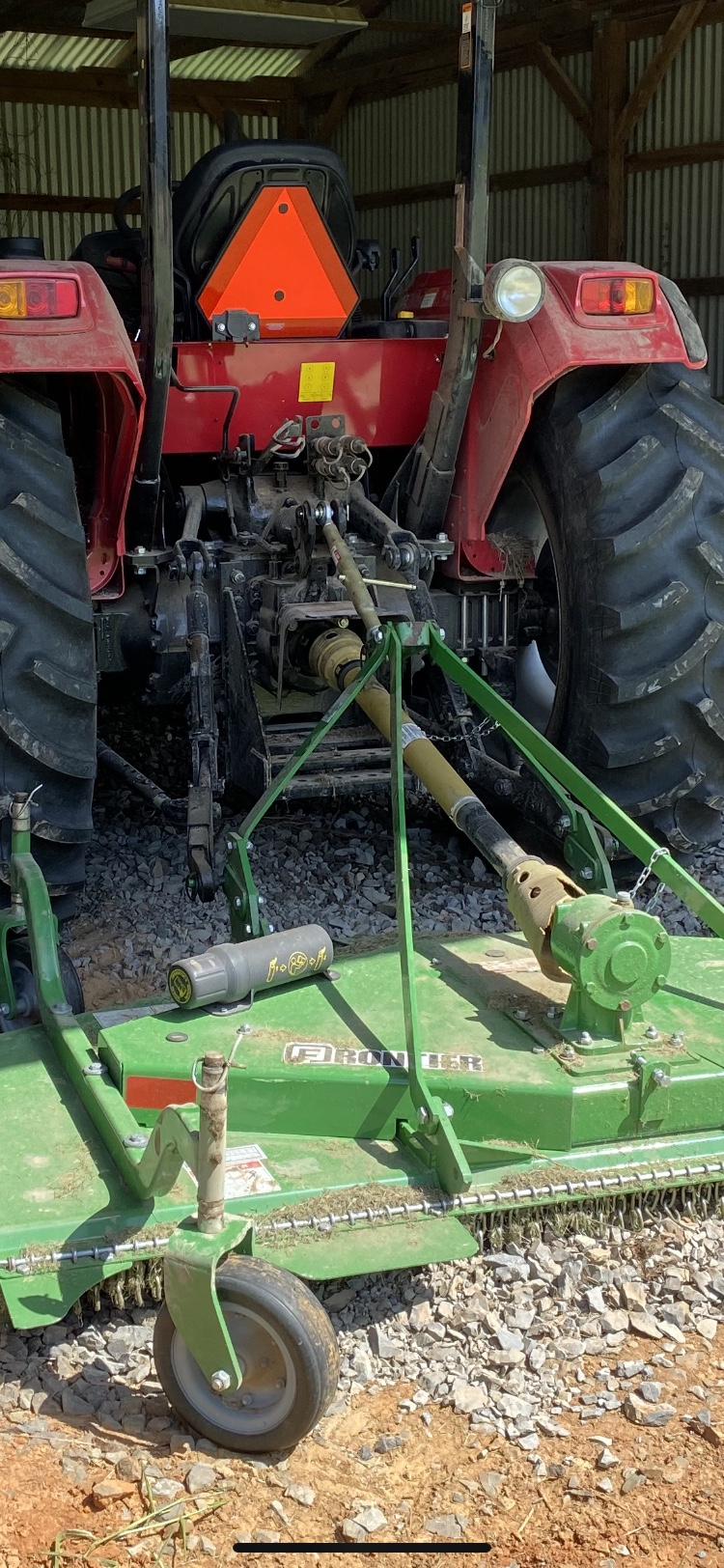

I’ve been around tractors for a good while but this is really confusing to me. I must be missing something. I purchased a 7 foot finishing mower for my tractor and the top link is too high on my tractor or the floating top link on the mower is too low. I purchased an 18 inch top link at HF just to see if that would fix the problem because mine was too long. Now the top link bangs up against the driveshaft which will not work. See photos and any advice will be appreciated.

Is it possible to bolt the rear of the long arms to the hole in the rear of the bracket on the back of the deck? It looks there are two bolt holes n that bracket. If so, I think it would tilt everything to the rear and have the affect of giving you more space at the pto shaft.

When does the top link hit the driveshaft?

Have some bar stock that you could use to raise that mounting point?
Or, since that flex hitch can swivel 360*, maybe have it up instead of down? As long as it can still pivot with the dips and lift the mower when needed.

Loosen off your top link bracket on the mover and rotate it up, looks like it was moved down for shipping reasons.
Edit: the top link is usually like this, not inside the triangle.View attachment 710664

As it is, it won’t pick up the back of the mower and I can’t risk damaging my pto from torque of the pto shaft. I didn’t know you could run the floating hitch in the up position, thanks for the heads up. I’m trying that too.

Also, do you have a lower top link mounting hole on the tractor? If you do, use that one.

With the floating toplink point the pivot should still not enter the inside of the triangle, it needs to push out when raising so the deck stays level, if it goes into the triangle you start pushing down and the deck tilts rather than raises.
I am pretty sure you have noticed this before on other attachments when your toplink is too long or short. (If it's too long the attachment tends to curl in towards the tractor)

The toplink in your original images, you need to extend at least 4" on each side so that the floating link does not drop inside (or break 90 degrees).
I did not originally notice you had it all the way retracted.

This is what others have done on brush hogs, should work on a finish mower.
Remove the bracket and pin the top link there. May have to enlarge the hole.
Remove the braces to the rear and replace with chains.
Modify the front brace so it can pivot:

The top link at the tractor does not look right. Did you add something there. The top link could go in a lower hole at the tractor. The braces going to back of the mower could be moved to the other holes and that well pull the top of 3pt top link back. Can the lower link arm hook ups move up and down, maybe you stop them because the 3pt floats up and down. On my woods mowers the top link swings between the brackets, if on top when I pick it up it drops down between the brackets.

So that’s why I’ve seen chains on some mowers. Makes sense, thank you so much!

I just tried that with my original top link. It wouldn’t fit unless I put the floating link above the brackets and towards the back of the mower. It definitely didn’t hit the pto shaft but it still only lifts the front of the mower then when I lower it it flips over and falls below the 90 degree mark towards the pto shaft again. Any ideas?
   / Need advice on top link height with finishing mower #20
This is an image of my brush mower when it is sitting on the ground.
My floating toplink on this one is of the other type and prevents the toplink from dropping inside the triangle. However this should give you an idea on where your toplink should be to start with. This position should allow you to lift your deck up and down, you will need to adjust in or out so that it stays level when you lift all the way up and put it down.
