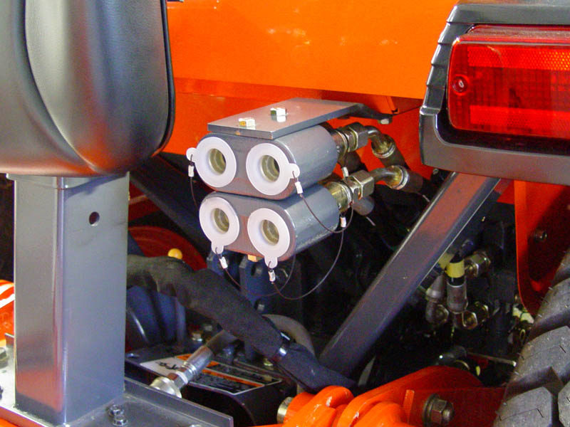

I'm looking for a TnT for my B3030 (with a double auxiliary valve). I asked my Kubota dealer to see what he could offer me and I did a search on TBN but so far I didn't find the kind of answer I'm looking for.
First, I read that TnT cylinders must be the type with check valves. My dealer said it doesn't matter. I'm not an expert about TnT so if someone could explain to me what a good kit should be (with or without check valve, etc.) I'll have the right information to buy the right stuff.
Second, the valve. Of course, my dealer offered me nothing else than a Kubota. I did it in the past ( I bought a double auxiliary valve to operate my snowblower on my former BX23. I don't have that valve anymore I traded it for my double auxiliary valve on my B3030 (in the fender). So I have to buy another one.) The picture is the valve that I had for my BX23. It worked very nice and it cost... too much just to have a Kubota valve. I know that I can have a nice valve for less. What do you have to propose guys? The two valves I have are already used so I need two more.
I'll do the installation myself. It's quite straight forward. So don't worry about who'll install the stuff.
So, in resume I'm looking for a valve and a TnT kit. I'm looking forward to read your comments guys. It'll help me a lot. Don't hesitate to give some technical details, I'm a fast learner. I'm sure it'll help other TBNers too.

   / Need advices about TnT cylinder kit #6
Stef,
I'm interested in the valve installation that was on your BX23. Did the location of the valve bother you when using the backhoe? What valves and cylinders did you use, and where did you buy them?
ron

638 said:
Stef,
ron
About the location... I'm sorry I don't remember very well I only had a BX23 for a year (one winter and I changed it early next spring). My guess would be that I had to remove the valve to install and operate the backhoe. The valve and the snowblower's cylinders (angle and rotation) were installed by my Kubota dealer. The valve was Kubota and the cylinders came with the Pronovost snowblower. The installation was ok... but that was the last time he touched my tractor. The only person to touch my tractor now is... me.

#9
MadReferee, I'm not looking for a factory valve. But if you know a good brand I'd like to know it. As I remember the Kubota valve installed on my former BX23 was pricy. And I think that you said to me at that moment that I could have had a good valve for much less. I don't want to make the same mistake again.
I'll use that valve only for my hydraulic top link. So I have a choice to make: I could install a permanent spool valve mounted on the ROPS (it must not interfere with my backhoe BH75 nor my new added lights, ROPS up or down), I could install a temporary valve mounted the same way as the first option but I could use quick connect hoses to use the rear outlet used for my backhoe (obviously the backhoe and the hydraulic top link will never be used at the same time, it's impossible), and finally I could use a solenoid operated valve installed permanently with a nice switch to operate it (that way I'd have more options as to where I put the valve itself and the outlets, the switch can be installed nearly anywhere as long as I can operate the cylinder sitting on the tractor and seeing the hitch's position).
So here I am, a bit lost with too many options :) . It's fun though to think of a new mod for the tractor. I'm looking forward to get into the installation process.
I decided that the cylinder will be CCM with check valve.
