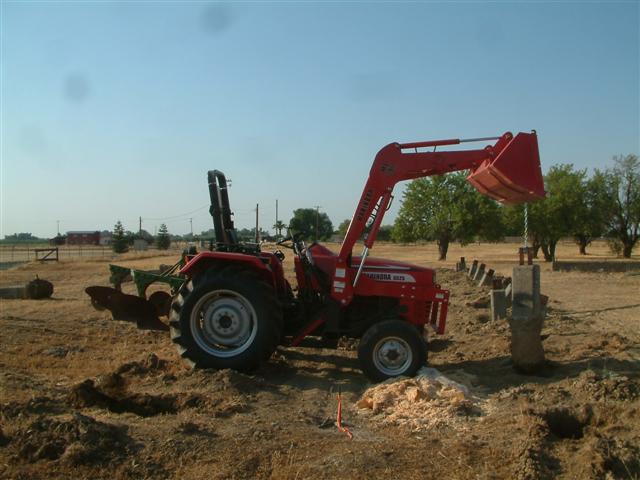

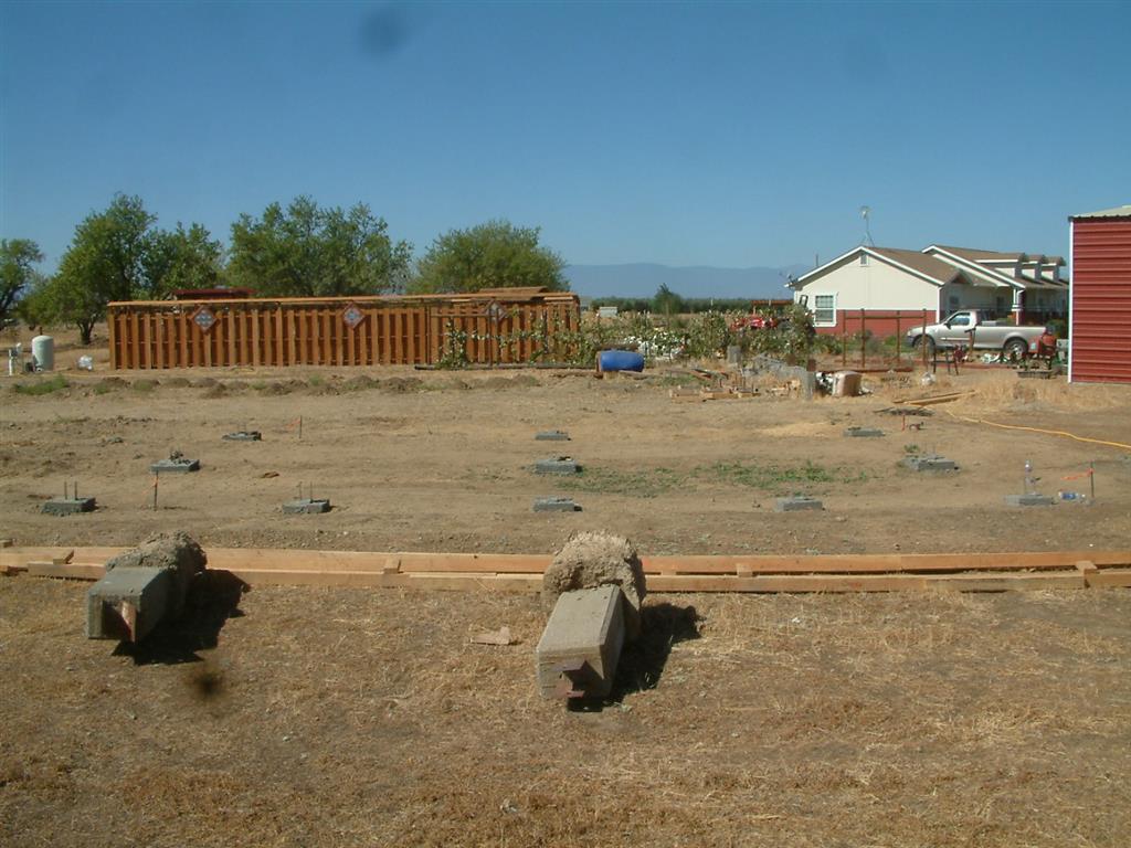

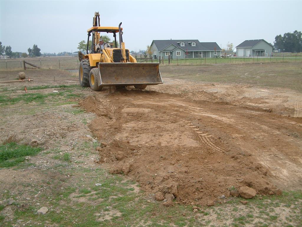

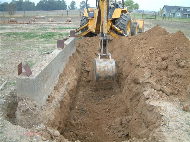

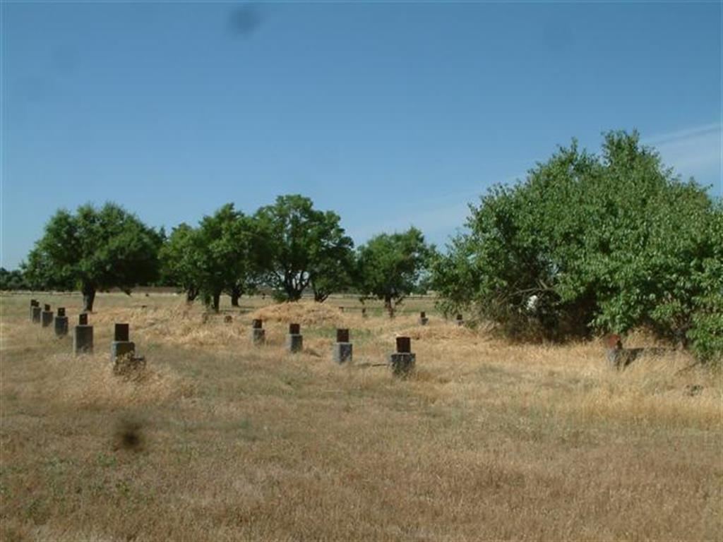

Humm--uncompleted wooden barn, abandoned, exposed to weather for 20 years. IMHO it's worth nothing even if those old building permits are still valid (which I highly doubt).
When I bought my 10 acre ranch in 2005, there were 24 concrete posts in the ground--foundation for a pole barn that was never built. According to my neighbors, those posts had been in the ground for nearly 50 years. With the present day building code, I could not get a permit to use these posts. So I dug them up and gave them to a neighbor.
Concrete bury-2.JPGConcrete bury-4.JPGDairy barn posts-5525.JPGDairy barn-1.JPGDairy barn-2 (Medium).JPG
There were also two concrete pony walls about 20 ft long that were in the way. Rather than bust up the concrete, I paid $125 for an hour's worth of time with a TLB to bury those walls.
Good luck
