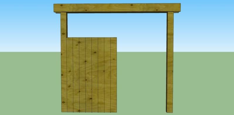

I am constructing a gate with a kind of archway over it because I want to be able to hang/hoist things from it if need be. One of the reasons I'm doing this is so that I have a place to hang deer before butchering which it can certainly handle, but I have a habit of overbuilding things, so I wonder how much I weight it will support? For example, could I lift the front end of a compact utility tractor? Could I pull a small block Chevy with it, etc...? Here is a sketchup representation of what I'm building:
I've already got the 4 x 6 posts in the ground. They are buried about 3' 6" on what seems to be solid and relatively undisturbed heavy clay soil. I dug the holes 4' deep and added 6" of gravel to the bottoms to facilitate drainage. This weekend I'll be adding the lintel on top which will consist of a 4 x 6 sandwiched between two 2 x 8s. The 4 x 6 lintel will rest on the tops of the 4 x 6 posts (a deviation from the drawing-I just decided that last night) and Timberlock fasteners will be driven through the top down into each post. After that, the 2 x 8s will be screwed to each side using 3" coated deck screws. Part of the function of the 2 x 8s is to provide a finished look, but they should also provide quite a bit of stiffness also.
I tried looking online for information about the strength of wood beams, and found lots of charts and formulas, but I really don't understand them well enough to use the information. All of the lumber is pressure treated Southern Yellow Pine. The unsupported span of the beam is 8' 1". I'm just trying to get a rough estimate of how much weight I can safely support with this. For example, a SBC with a cast iron intake, exhaust manifolds, etc...comes in at just shy of 600lbs, vs. the 7.3L Powerstroke in my truck which weighs nearly 1000lbs fully dressed :shocked: Any ideas?

First of all you should not use screws. You should use galvanized carriage bolts. :thumbsup:
Here's how I would make the beam... I would use two 2"x12".... and place an 8" section of the 4x6 post every couple of feet. The beam would be attached to either side of the main post with the carriage bolts. This will sandwich the main posts and beam together making a very strong structure.
The other issue you have to work out is attaching the load to the beam. The attachment must distribute the load evenly to the beam. I recommend some sort of steel plate that attaches with multiple carriage bolts.
The biggest issue I see with the set-up is side loading on the beam... not a direct vertical pull on the beam... this could cause the whole outfit to lean... so firmly mounted posts are critical... also small kickers or braces maybe needed to support the posts in this situation. An ideal design would use four posts forming an A-frame on each end. This would be very strong! But it all depends on how much loading you are carrying. :cool:

The design you described (4x6 with a 2x8 on each side will hold everything you described. (listed) However, if you are a little unsure, put a strip of sheet metal on each side of the 4x6 before you add the 2x8's. When the sheet metal is held firm by the lumber, it cannot buckle and you have, in effect, created an I beam. (Two I beams to be more exact). You could lift your whole truck if you wanted.

It looks like the described beam is good for about 1 ton using Fb=1000psi and derating the distributed load by a factor of 5/16 for a point load in the center. A lot depends on the lumber grade. Make sure the top sheds water so it doesn't deteriorate. The strength is in the top and bottom fibers of the wood so don't cut any notches, especially near the center where the bending stress is greatest.
The top beam will also tie the posts together to resist any fence tension and the cantilever weight of the gate.

IHD...your fine with what you designed...build it!
   / Need an engineer-strength of wood beam?
#12
Well, I went ahead and did just that!
It ended up being a kind of "half A-frame" with diagonal supports on one side, which should be plenty. I don't think I'll be pushing the envelope with it really, but it should be good and strong for what I need. Next comes finishing the concrete, putting up the fence, and bringing in gravel/crusher run to extend the driveway into the backyard.

I really didn't seen the need for them. The "inner beam" (4 x 6) sits directly on top of the posts and is secured in place with two lag bolts through the top down into the posts at each end. The 2 x 8 "sandwich boards" on either side of the 4 x 6 were first screwed with 3" deck screws in a staggered pattern every 4". After that, 6" Timberlocks were sunk every 12" from each side. If the beam isn't fully tied together after all of that, I don't know what it would take.
   / Need an engineer-strength of wood beam? #18
Deck screws are very brittle and will not hold a shear load. I'm not a fan of that part of your design at all. The one lag screw down from the top pins it a bit, but does not tie in with a triangle design, so it does not add any ridgidity to your design. As weight & side-loads pile on, things want to twist, bend, shift to one side or another. It is then when just a little bit stronger fastener or 2-3 fasteners instead of one big one will prove to keep things squared up.
Drilling the hole in the center of the 4x6 beam weakens it a bit in the worst possible place.
Actually you built it pretty good, other than the deck screws, they are sub-standard.
I'm happy to see those angle braces, I was thinking the weakest part was the verticals, with no support they will want to bow out. Wood isn't perfect, it's the knots and bad grain you need to watch for.

I have to admit that I still don't see how the screws are really carrying much of the load at all. Again, the 2 x 8s fastened to either side of the 4 x 6 were really intended to stiffen it-not really carry the load. The load will be carried by the 4 x 6 which sits directly on top of the posts. Also, what about the 1/4" thick stainless steel lag fasteners that were placed every six inches?
This is why I used 2 x 8s which lock the 4 x 6 in place on the tops of the beam. I am also going to add braces at 45 degree angles from post to beam at either end which should help with rigidity.
I haven't done this yet-what would be the best way to attach a block and tackle/come-a-long/chain hoist, etc... I have some heavy (10,000+lb) nylon lifting straps with loops at either end, should I just throw one of those over the top?
They were essential and provided a great deal of stiffness.
