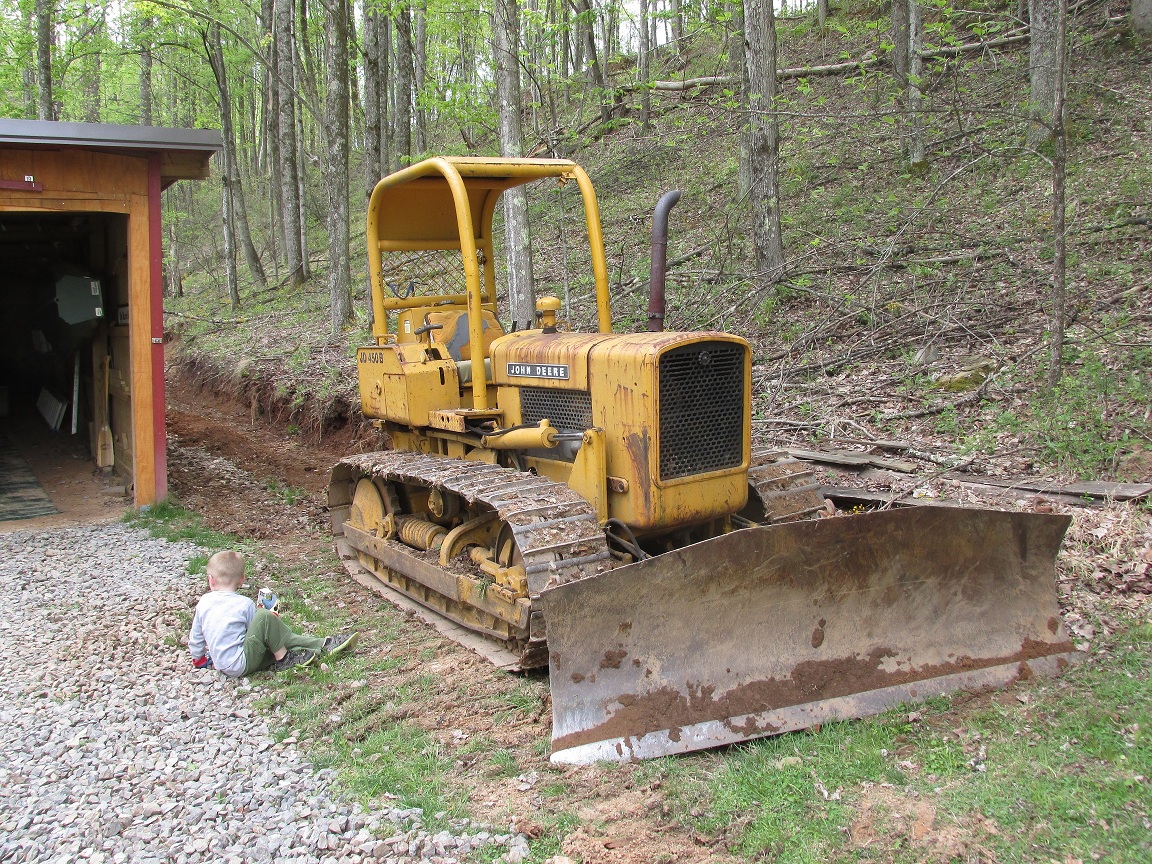

Here's mine. I've put sweeps, and a mile marker hydraulic winch on since this pic. I'd love to have a factory winch for her.

That's a super nice machine you have there.

Thanks,
A fresh coat of paint usually means that you'd better look it over a little harder. Fortunately this one was close to as nice as it looks.

Thanks,
Well I ended up going with a John Deere 450B. Not as nice looking as yours, but the previous owner (a church) had the JD shop do the maintenance on it and recently (less than 50 hours ago) redo the undercarriage (except for the tracks), so its like new. Got it for bit less than the Case was going for. The exterior needs some TLC (any ideas on where to get the correct color paint for it?) but other than that it runs like a champ with no leaks or other problems.

I don't know that it's not every bit as nice as mine. Nice isn't in the paint job.
Sounds like you got a smoking deal on it. You might check with your local JD dealer and see if they still make paint that color, I think they changed shades of yellow though. Other than that Tractor Supply has a pretty good selection of equipment paint. You might take a little chip in and see how close you can get.
