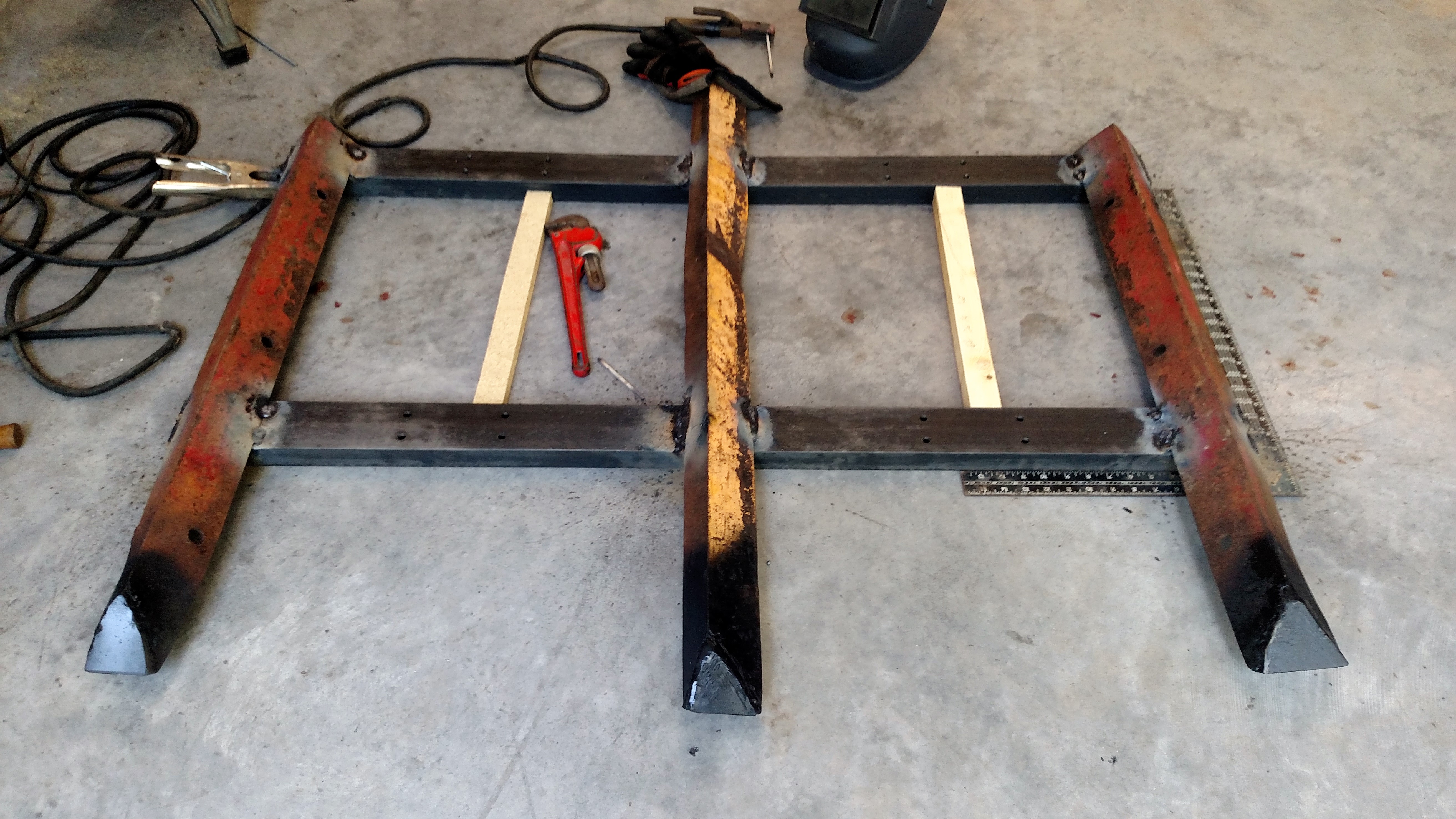

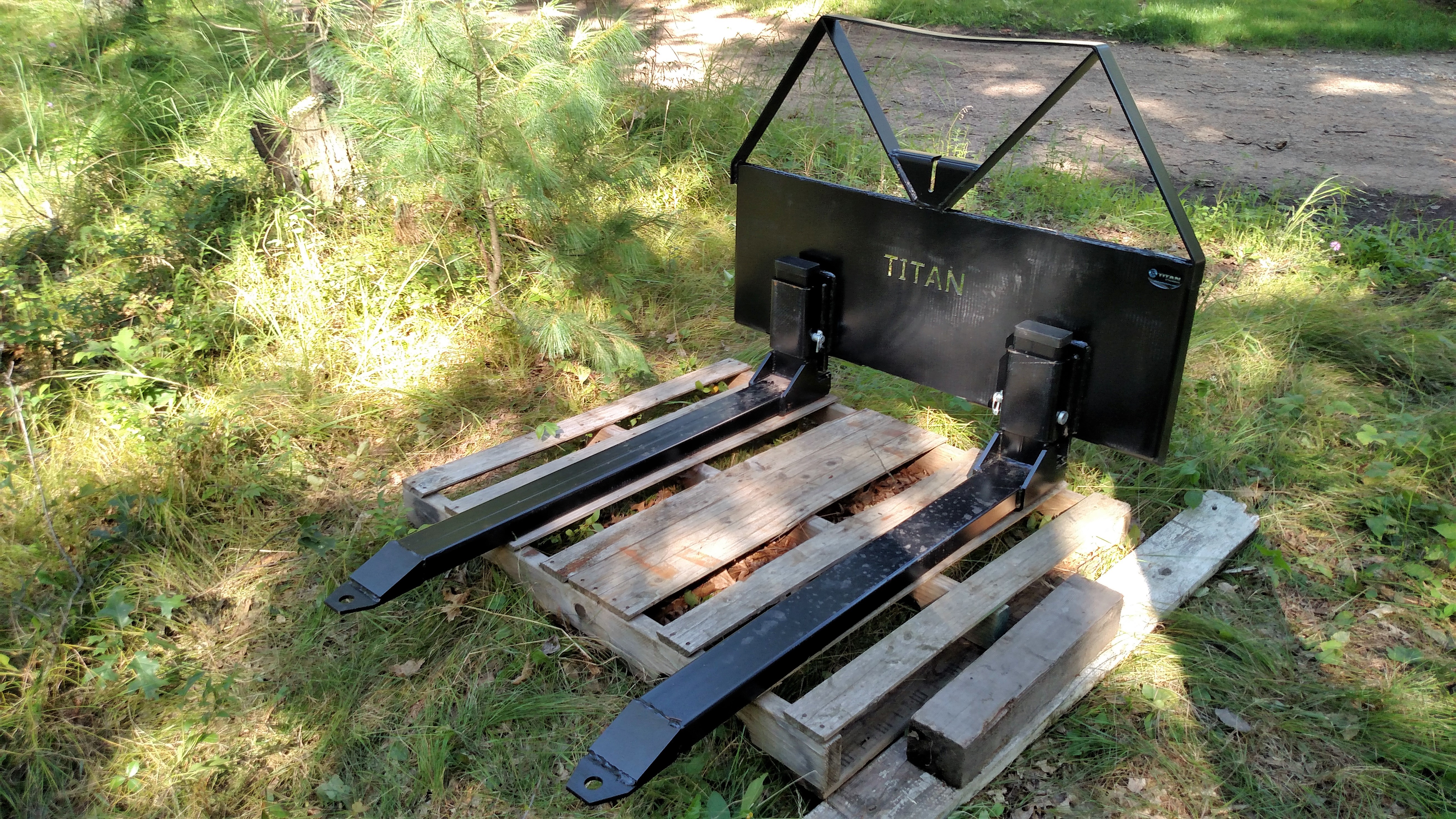

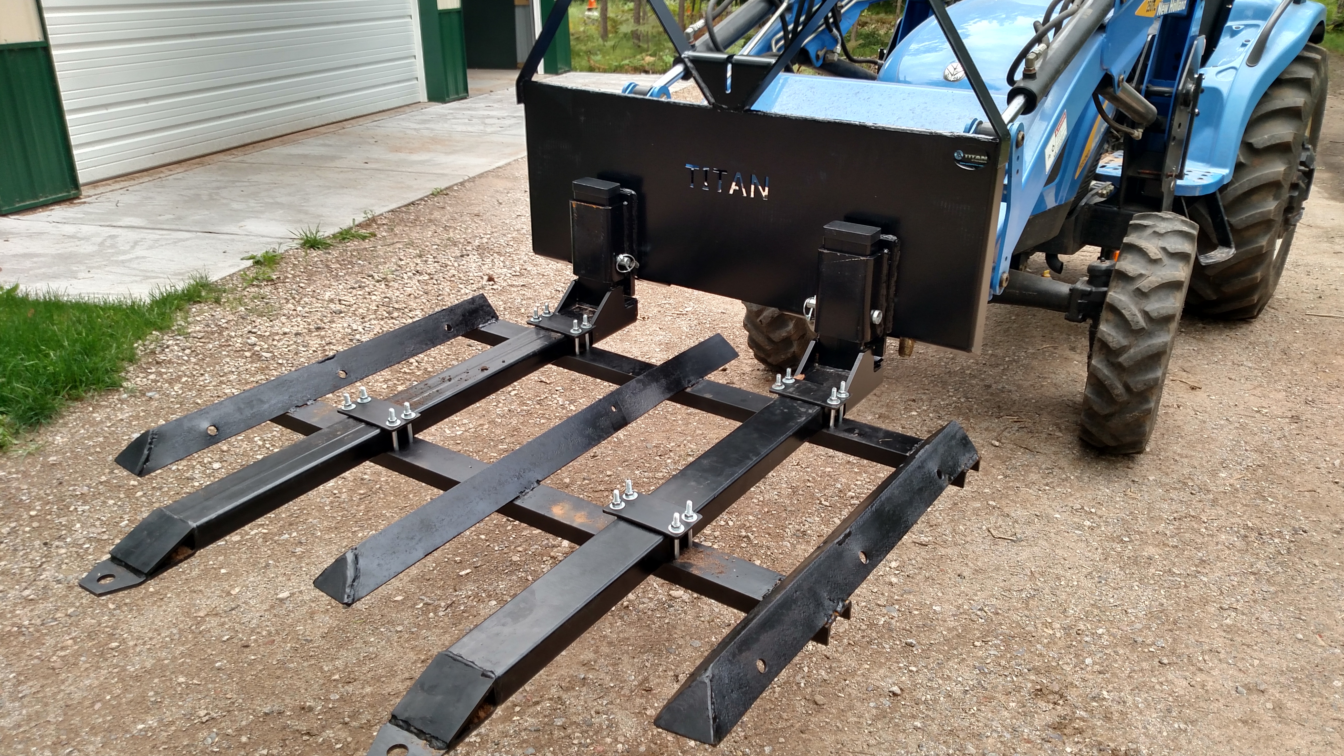

If you have SSQA mounts on the loader, then you have lots of options. I bought the Titan economy forks and I really like them. They are $280, and are often on sale for around $250. I had some old angle iron laying around so I made some debris forks to bolt on.

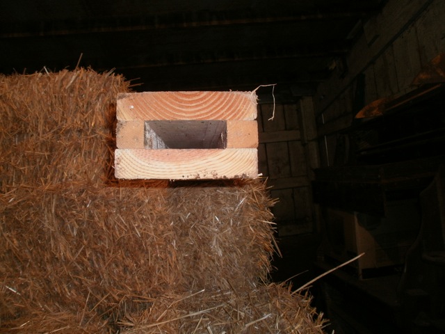

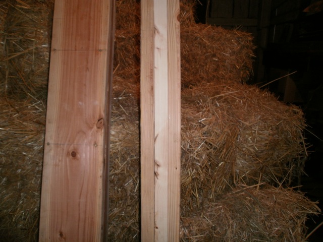

Here is the poor man's version ...

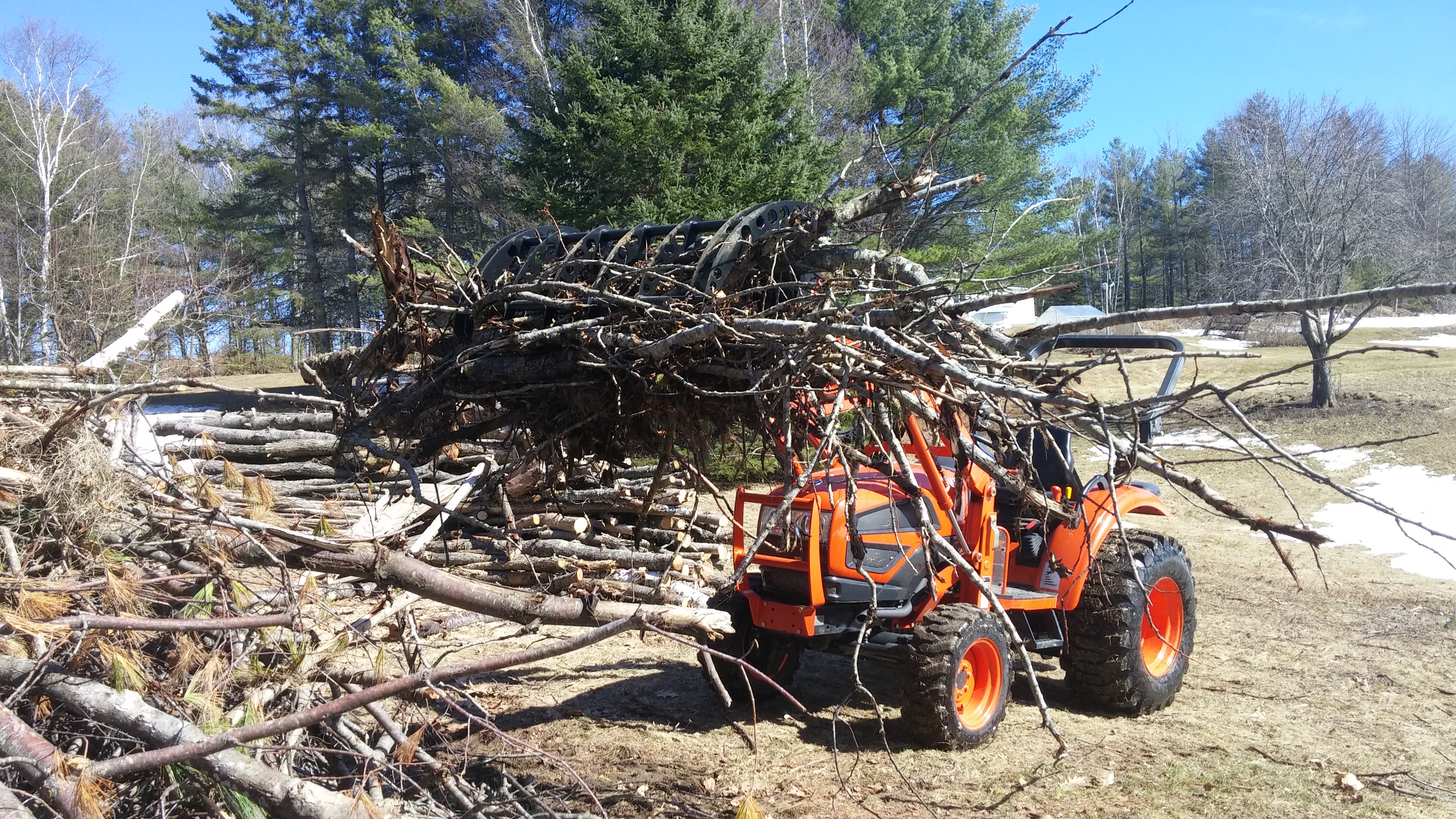

You can move amazing amounts of brush by just pushing if with your bucket. The work I accomplished doing that with my lil BX with just the FEL and a box blade after hurricane Katrina was astonishing and made several people I know go buy a BX after witnessing it.

Agree, with my little bx I was able to push brush piles for several hundred feet, it took a little re-positioning during the process, also I'm on flat land.
You would be amazed how much of the brush interlocks together and what little loss you have while pushing.

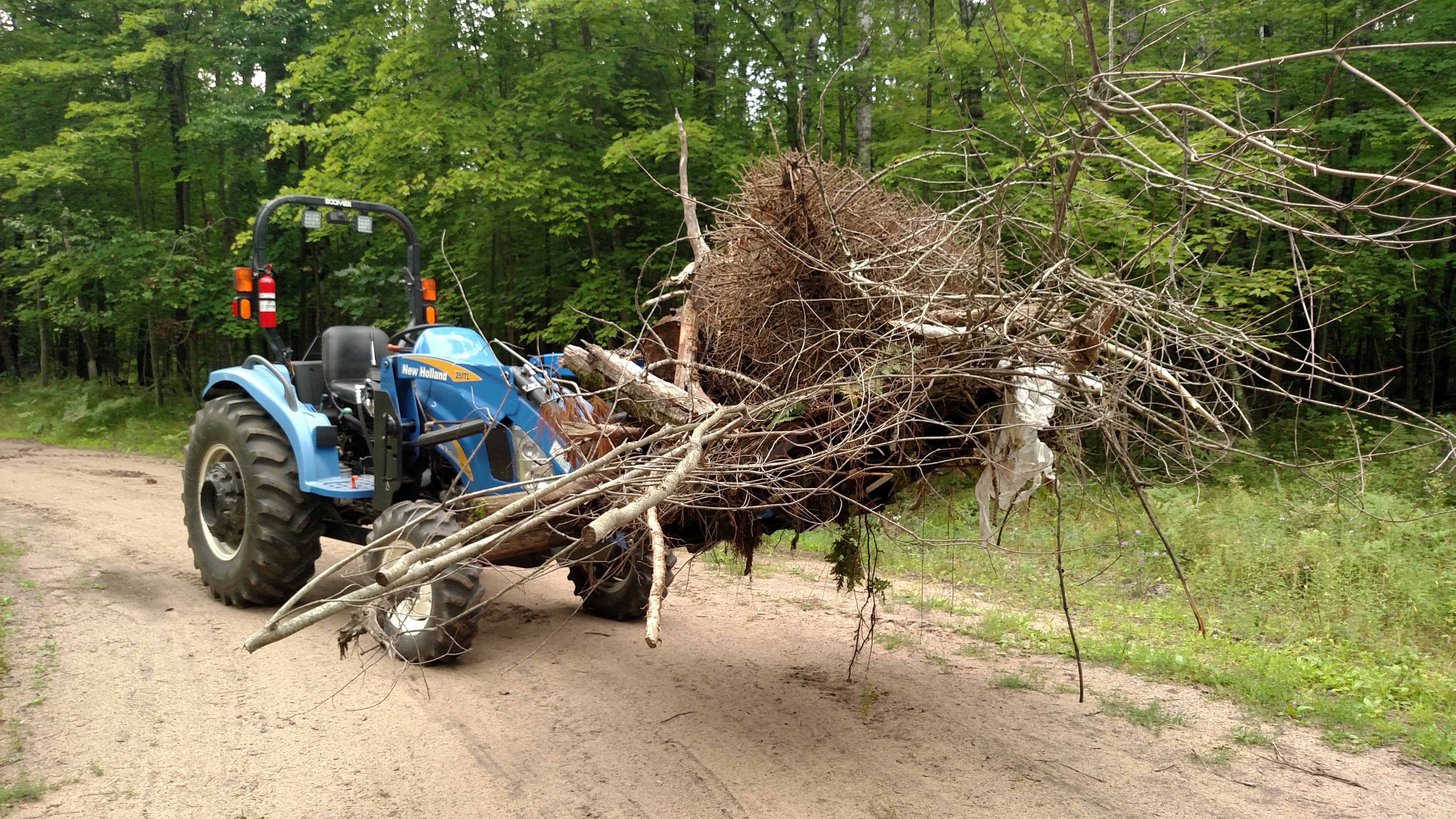

Also purchase an inexpensive 72" grapple off Ebay for my T503 and put together my own diverter valve setup, life is so much easier and faster.

I found that my wooden fork extensions come in real handy moving brush and limbs. I can stack on there by hand or I can go underneath.
It works out super well for me if I am loading up some stuff to take to my chipper pile. I dump it in a way where the brush isn't compacted and easy to hand load into my chipper.
