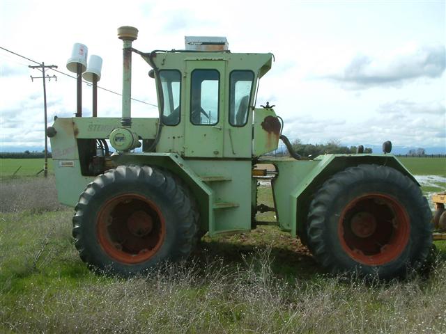

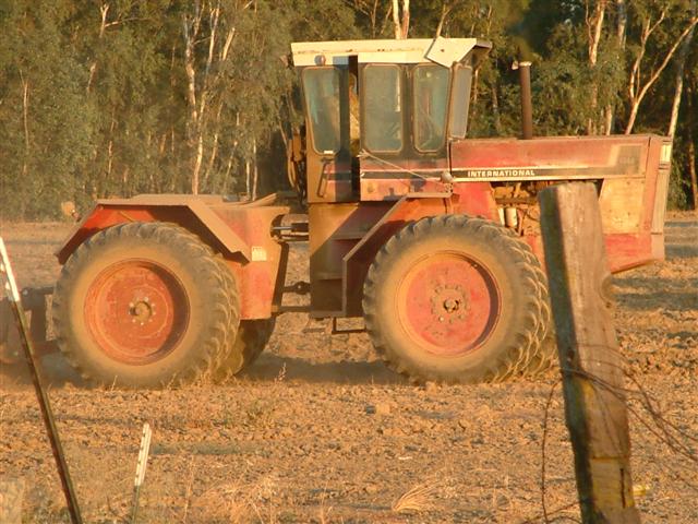

My neighbors have several examples of cheap, old HP that they use to plow their hayfields.
A Steiger Super Wildcat
and an IH 4366 (made by Steiger)
Probably more HP than you want.
I've seen similar beasts go for $7-8K at local auctions.
Just a thought.
Good luck

I have considered a machine like that. A little overkill, but would be awesome to have.
