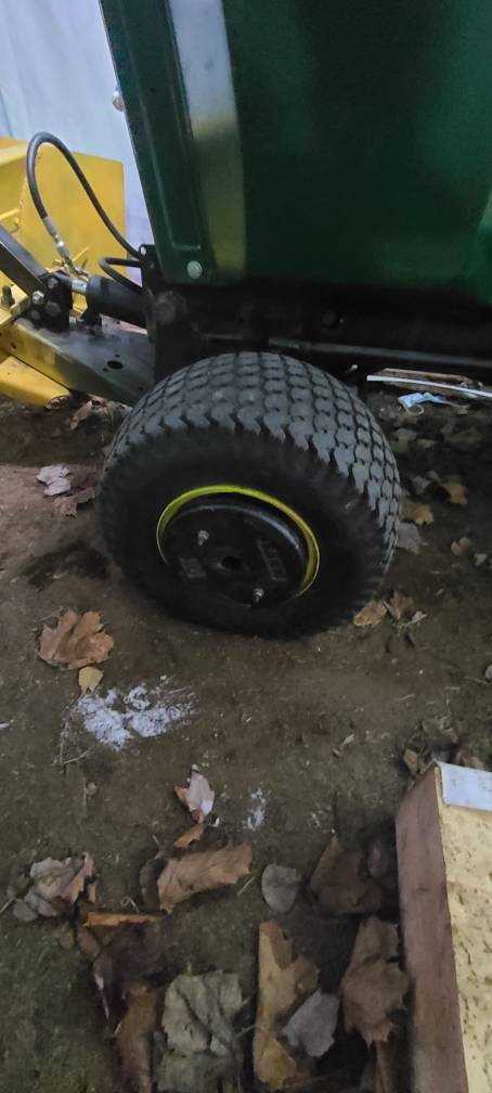

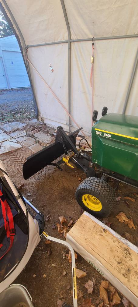

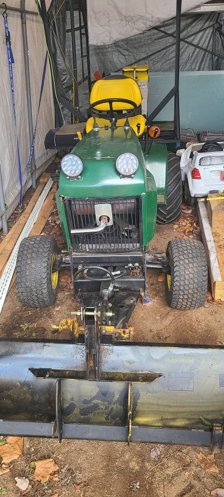

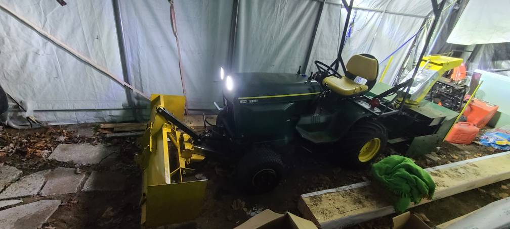

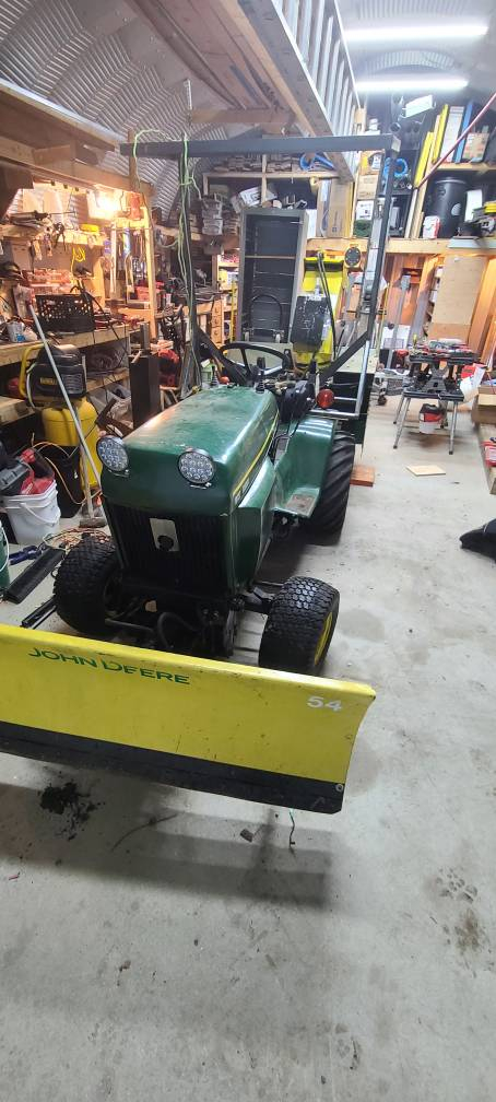

Worked on it a little this year. Had second plow that i reversed. Then I learn to weld then add side to it. This reverse plow is the best thing I had on it. The pushing one dont worth **** lol. You can tilt it. But it's just pushing the tractor on the side instead of scrapping. Then I start a cabin that In mounted on the seat screw ( was able to prototype a buddy seat for my Kids) at least for now the top is helping when it's raining... I add some light .(front and back) but I think I might need to find a way to have a bigger alternator. The battery is slowly draining faster than recharging when engine is running. The picture with the black plow is before I finished the modification. I had tried it on the 3 point first. I redid about 90% of all wiring
This week i'm putting in a new alternator and a new air filter
Then finally I added about 20 pound on each front wheel with training weight that Inhad laying around. Could not find affordable wheel weight close to where I lives. It truly make a difference

It had a old strap windshield motor for the chute angle but the strap was breaking every year... I change itnfor a 12v actuator but this thing is slower than a eartworm. The engine is only 19.9hp. And the snow blower was custom fit. Not throwing snow very far as soon as it is' heavy snow you need to slow down a lot. But still worth every penny. Was probably made for a 25hp and up engine.
As of now it cost me around 3500$ us with everything I added.
Next summer ( i dont have a heated garage yet so it too cold to donit this year) I'm thinking of making quick removable framed pannel for the back. And top half door removable for side. And a 3 piece angle windshield ( maybe folded if I manage to find a way) with some sort of leather or flexible material at the botom to still be able to lift the hood. . Right now it's plexiglass as everyone is selling. When it'll break ill probably switch with the brand lexan(polycarbonate) I live in Quebec city and winter snow accumulation is about 300 to 400cm (10 to 12 foot ) I love the 400 it's the easyest thing to customize I know. Would not do those on a tractor I paid 30 000$ and up.
The only reason I think I might changed if it still work is maybe if I find a 4x4 around 25- 30hp.
