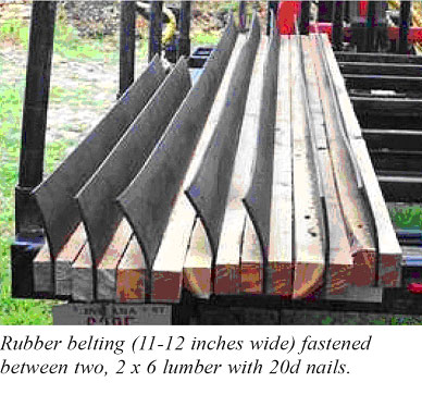

Gylford, do you have pics of the conveyor belt water bars?
   / need drainage ideas... New carport #12
Full disclosure, I haven't made or used them myself. This is the first google hit:
Indiana Woodland Steward - Water Bar for Continuous Use Road

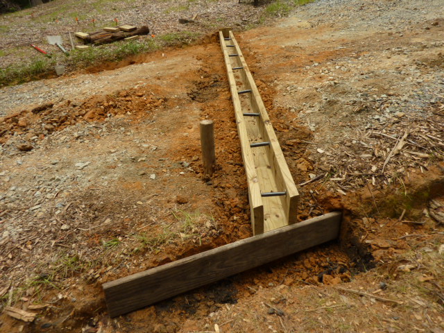

   / need drainage ideas... New carport #14
This is the "3 boards" channel I also mentioned, I see they are also using chunks of all-thread to support the top edges of the boards. I hope this is during install, and they actually fill and pack it closer to the boards...? Either that, or this system is about to fail. So I suspect with any system you can expect some maintenance.

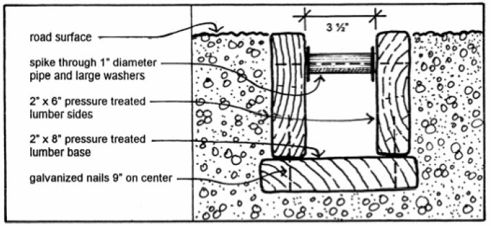

Wooden water bar:
This has a good feature that some I've seen lack. The bottom board sticks out past the vertical boards a bit to resist liftout or up-down movement when crossed. One diagram showed about 1/2+ inch.
Bruce
