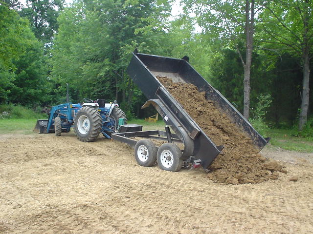

The jacks have always been a sore point with me. A jack can be a potential clearance problem especially when the trailer is being used off road. Mine is farther back from the tongue and is one of the ones that can be quickly extended or retracted along with the regular screw adjustment. When not in use the bottom foot is far enough up that there's no chance of it snagging something.
The tongue is another opportunity for versatility. The tongue mounts with interchangeable fittings allow the use of either a clevis for hooking directly to a tractor draw bar, a conventional coupler or a lunette. The set up also allows several height adjustments that make it much easier to match the hitch height when you pull the trailer with a variety of vehicles.

Mine has the adjustable tongue too, what it also does is let you set the trailer up to match any other trailers you have so one ball mount will be setup for all.
Before anyone hooks their trailer up to run off the tractor hydraulics I would make sure it does not void their warranty.

I use the same fluid in the trailer hydraulic system that I use in my Kubota.
/ Need Dump Trailer info. #27
That's why you convert your trailer to work with tractor hydraulics and bypass the battery pump. /forums/images/graemlins/smile.gif Doesn't work very well when you use it with the pick-up though.

you said your trailer came setup for tractor hydraulics. I didn't know they came like that. I was just thinking before someone modified their hydraulics they should check with the dealer to make sure it didn't void the warranty in case of a problem. I seldom use the trailer without the truck so it's a moot point for me anyways. The only problem I have with mine is if I get too much of a load I have to jack up the front of the box about 8" to get it to lift. I think it's because of the low profile puts the cylinder almost parallel to the bed and it can't quite get it. No biggy, if I get too much in I would just as soon give it a little help.
/ Need Dump Trailer info. #29
I sat down with the builder and went over every thing I wanted including the option of using either the tractor's hydraulics or the self contained system. I asked his advice on any issues that might develop. The only thing he cautioned me about was loading the thing to the top with heavy materials. The struck capacity is 22 yds. The floor is heavier than most trailers, but it still won't handle 22 yds of sand or rock.
