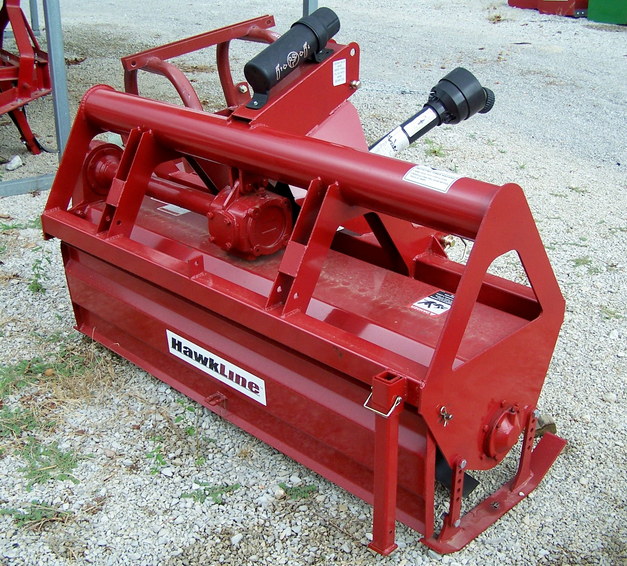

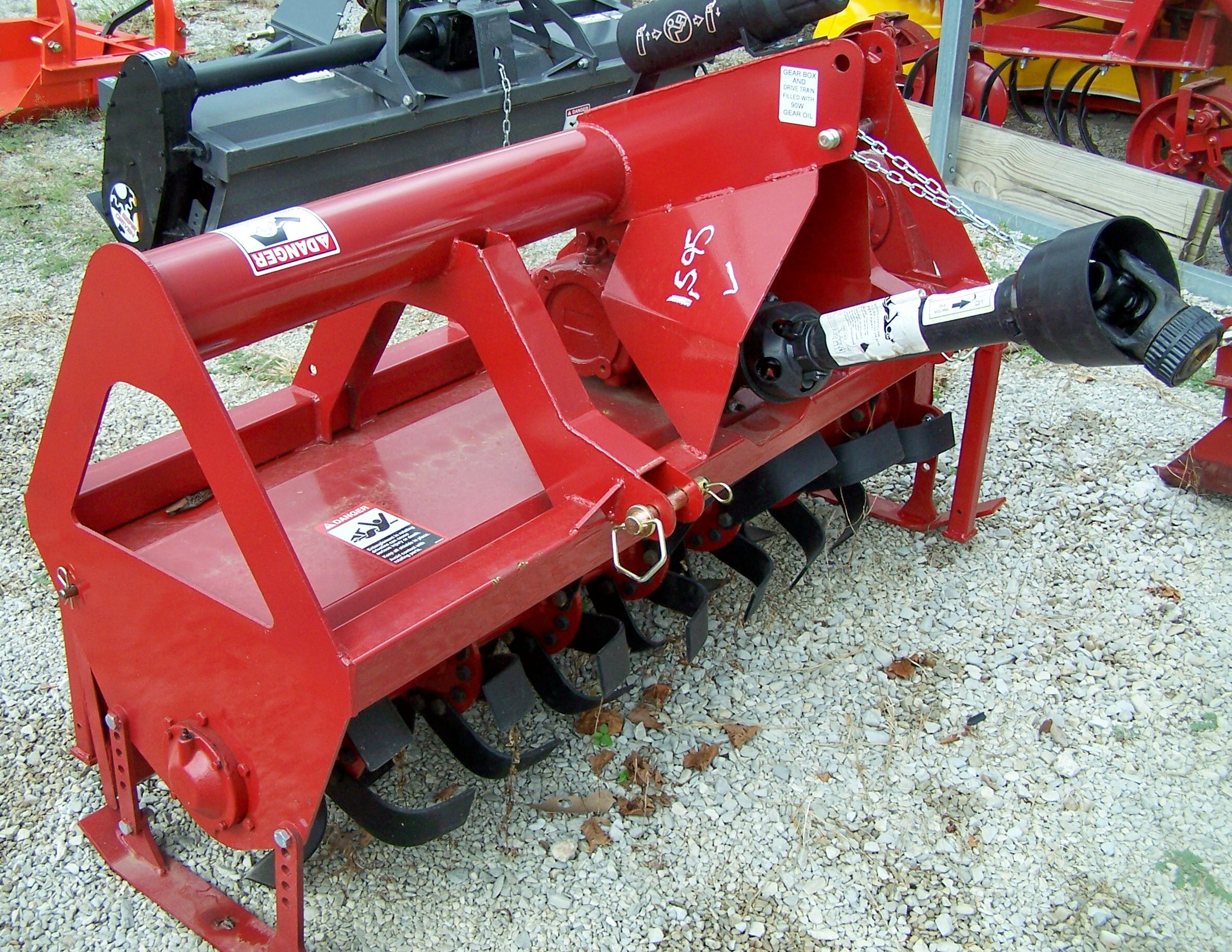

We sell Tarter Geardrive roto tillers, Hawkline Roto tillers, Phoenix Roto tillers and First Choice Roto tillers. The Best deal currently on a 5 ft heavy Duty Geardrive tiller would be the Hawkline at $1595. This tiller has 6 tines per rotor and slip clutch PTO. They are coming from Huntington Tn. The 5 Ft Hawkline Rotary Cutter is $895 with slip clutch PTO. Shipping is very reasonable. Ken Sweet
