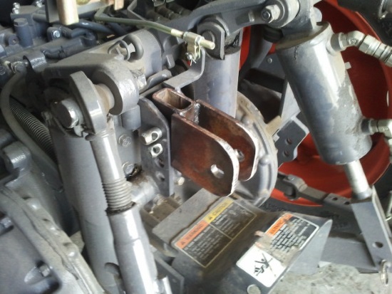

I picked up a cheap harrow and the top lift isn't long enough for it to lay flat. The back is tilted up with the arm fully extended. I don't have this problem with my mower or box scraper. I have the quick-connects on the bottom lift arms so maybe that's causing a problem. Anyone know of an extension for the top lift? It just needs the right ends to extend the lift and allow the harrow to lay flat. Thanks!

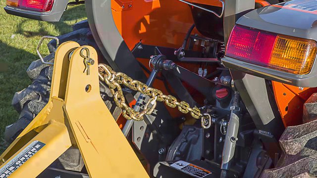

You could just add a short length of chain.
   / Need extension for top hydraulic lift
Has to not be flexible. The hydraulics on the top lift needs to be able to lift and put down the attachment. I guess I could use a chain but it seems like it might damage the lift if it gets yanked suddenly.
   / Need extension for top hydraulic lift #4
Gravity puts it down. A chain will will work.

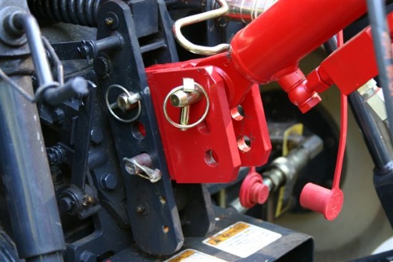

Or make one of these:

I think he has hyd top link. So it will lift the rear as he is talking about. kabota shifty, still a piece of chain should be a simple solution.
My guess is the 3rd arm mount on the implement is not original. Could have a part missing on it but need pictures to have real idea.
