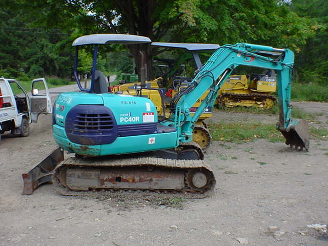

I'm not on a soap box, just adding info. As a comparable, a Komatsu PC-40 / 8900# grey market unit with about 1300 hrs, you can expect to pay less than $20,000 US.

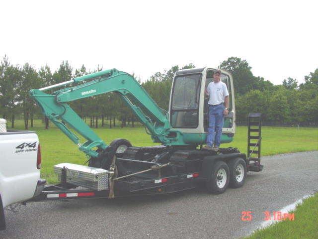

Yup,, I have 2 98 model PC40-8 w/ steel tracks and rubber pads (no rubber tracks) for sale and they are under $20K.
