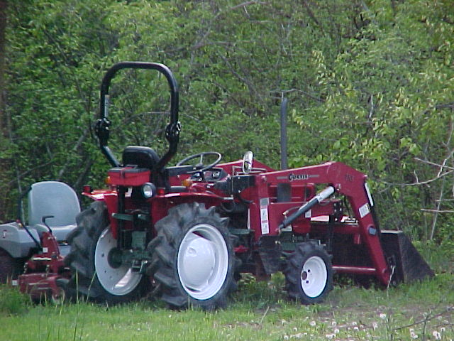

I have a 1602D, which is 4X4 and gear trans, and I concur with a lot of what the other guys are saying, you need to try it on first. I'm not that big of a guy, but climbing on and off is a bit of a pain, it's easy to get your feet tangled in the pedals. As to ability, mine has done everything I've needed, which is pretty much as you described. I also really like the 4X, since my property is hilly too, plus I have a FEL and the 4X makes it more comfortable to work with, especially backing out of a hole with weight in the bucket. My advice is the same as the other guys, find a good dealer and let them educate you a bit, then try some on for size till you find the right one...........
